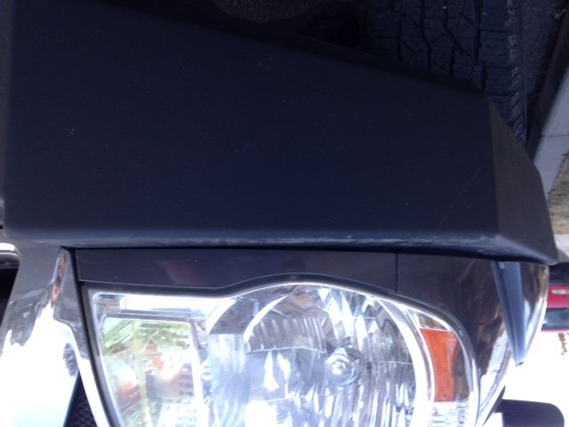

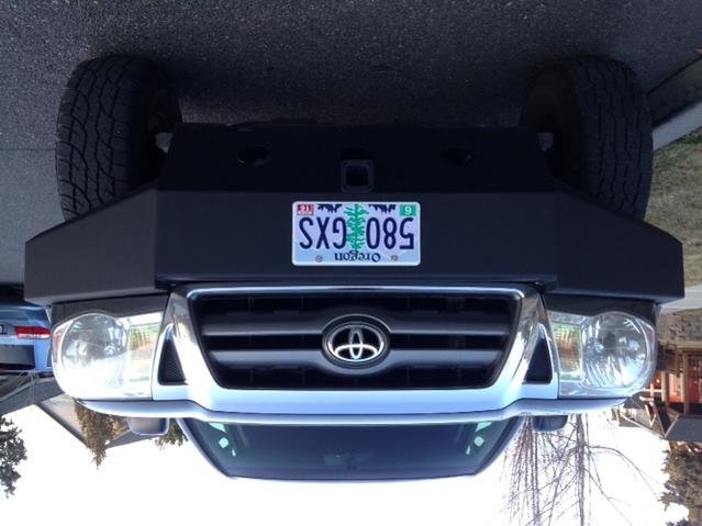

    I was thinking about putting washers in between to lower it a bit but the only mounting points i see are not horizontal but vertical. Here are some pics. Like i said its very small differences but the one side is hitting the headlight housing and fender from behind.
    I have no idea why everytime i post pictures they are upside down. Sorry

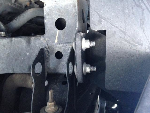

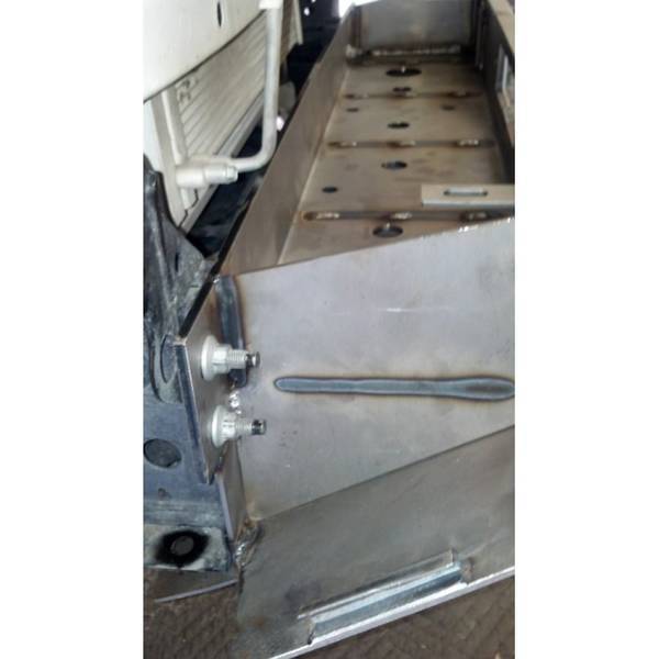

    San Jose, CA
    19 TUNDRA
    There are 3 per side. Two that can be seen from your pictures, one hidden. Here's an example of where it is, look in the background of this picture to give an idea of where to look.
