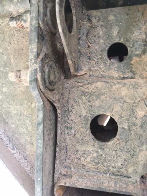

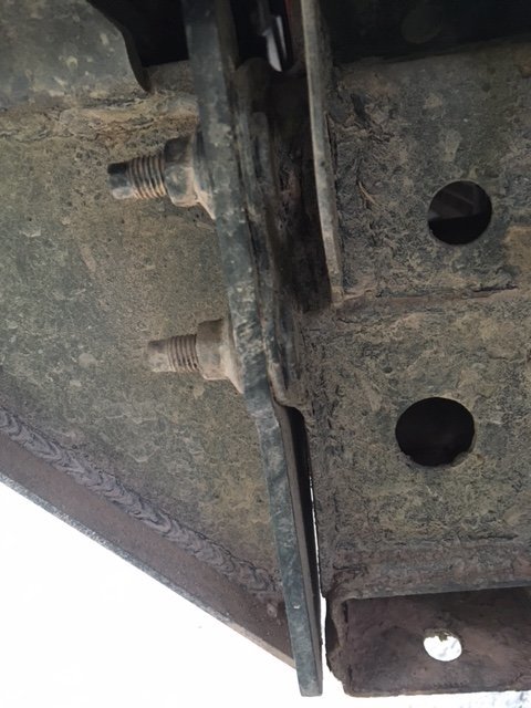

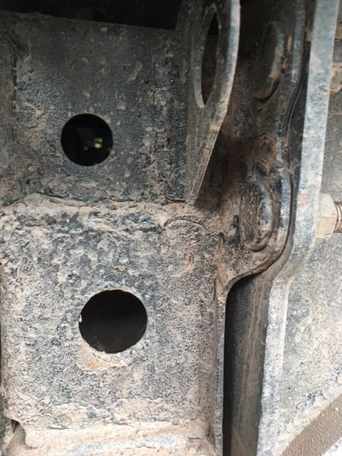

    so i was winching over a rock wall yesterday and i nearly pulled the front bumper right off the frame. the thin metal that the bumper bolts to bent and stretched. I know a while back i saw someone selling weld on plates or something the beef up the front bumper mounting area but i cant for the life of me find it now. Can anyone point me in the right direction? thanks in advance.

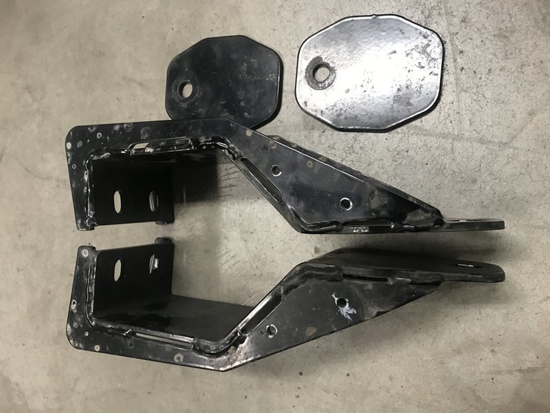

    IMG_1631.jpg Brute Force Fab.

    I made a set of reinforcement plants but never bothered to install them for that reason. Adding a plate to the front of the mount certainly helps but it really needs to be tied back to the frame to resist pulling.

    talked to billy at bruteforce today. hes going to make me a set of weld on plates for the bumper mounts and a set of brackets to reinforce it. that should do the job.
