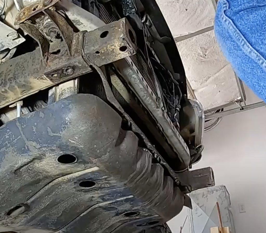

    Screen grab from 7:38...
    I'm seeing the cross member fully intact, he's just removing the crash bar (the part in his hand).
    Using this picture as a reference:
    The actual cross member, at the bottom of this picture, is oriented toward the rear of the truck. It supports the skid plate. In the video, he says he removes the plates from the front (top in the above picture) of the frame extension, but otherwise the part appears to be used in its entirety.
    You can see more clearly at 8:55

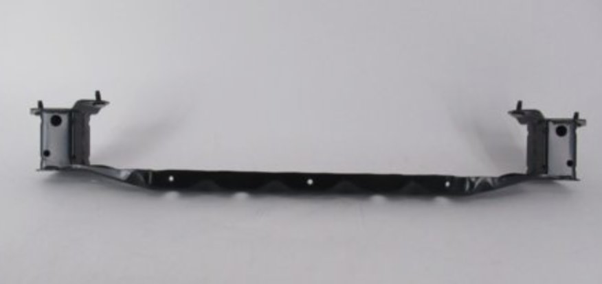

    I think the confusion here comes from the differences in front-end design between model years. Prior to 2001, the cross member was permanently welded to the frame, and instead of the crash bar there were crush cans. I think that's what @MadNachos is thinking of.
    Examples of earlier trucks with permanent cross member and crush cans. These trucks don't have the full-width crash bar.

    holy shitttt dude that makes way more sense now. Okay I have to buy that part off eBay then. Thank you so so so much that helps me out a bunch.
