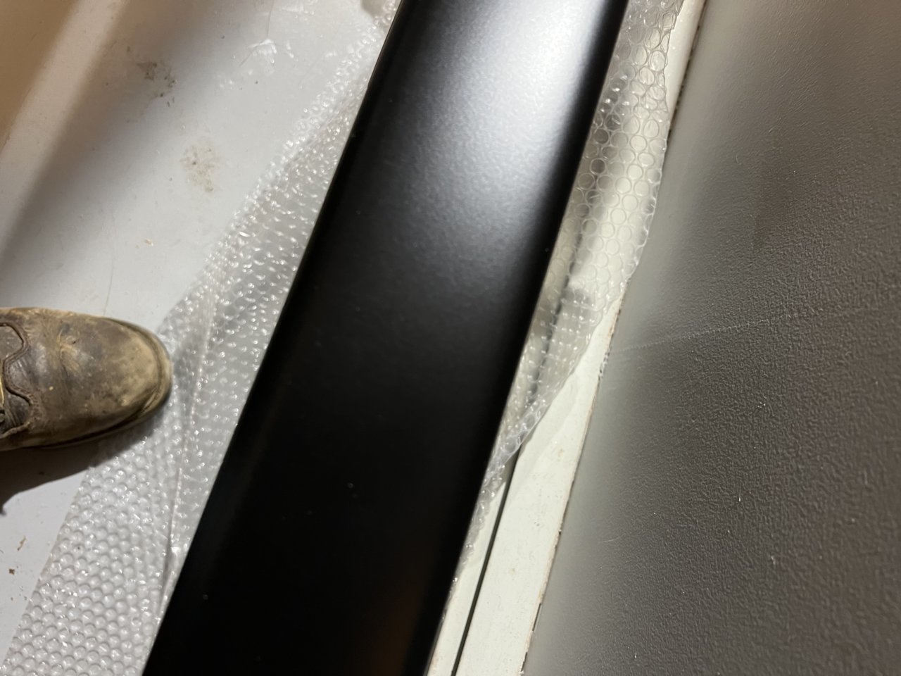

    I got the center section of my bumper. My truck had a painted bumper, not chrome (I think it has something to do with the trim level). Anyway, the part I got is primed in flat black. Local body shop wants $900 to paint the part. That’s not happening. I figure I’ll give this a go myself. Is the Dupli-Color Lunar Mist in a spray can a good match? Also, for prepping the metal, what grit sandpaper should I use? Thanks.

    Lol, find another body shop. that's ridiculous. I'm having a custom bumper powder coated for $300.
    You can also order an OEM color kit with Primer, Paint and Clear. I've used it for smaller pieces and it works great if you take your time and follow the instructions.

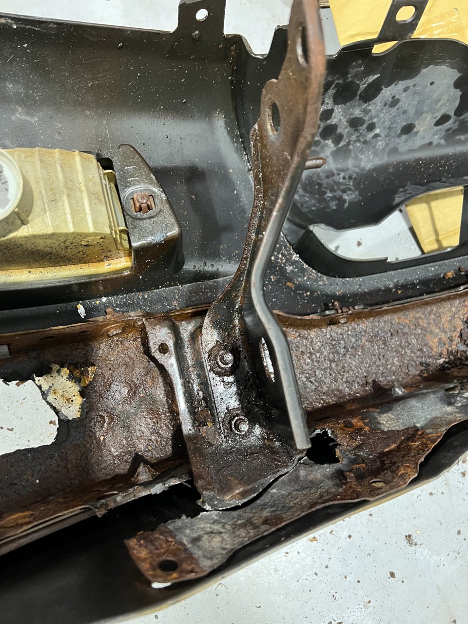

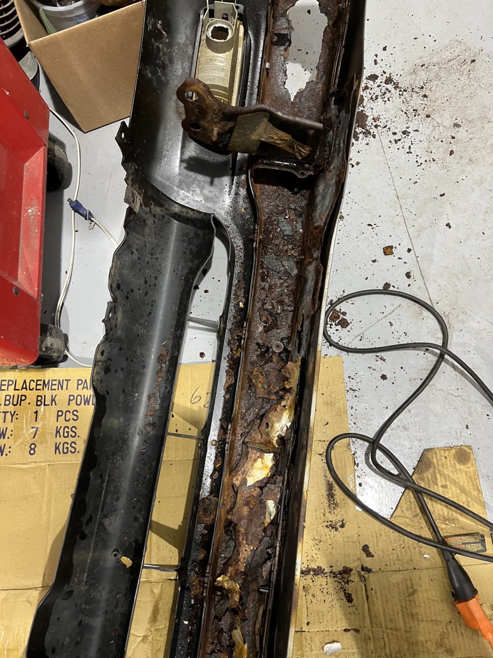

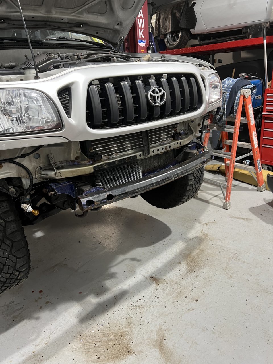

    So I got the old bumper assembly off. Now I see why people replace the entire assembly. Maybe an ARB bumper is in my immediate future.
    Back of bumper completely rusted. As are all the bolts that hold the filler panel and the valence. As I banged on it huge chunks just fell apart.

    I’m assuming I need these brackets no matter what I decide. I think I need to cut them off.
    I also need both of these corner bumpers.

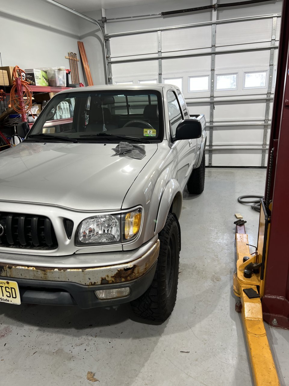

    Here’s how she looks

    I’ve changed probably 4 01-04 fronts from hitting deer and pigs, my advice;
    Get the galvanized clips and nuts from napa that secure the valences, the plastic plugs for the top piece can be sourced by Amazon
    I had the OEM Toyota brackets at like 80 bucks a pop and the cheap ones from rock auto, no real difference there.
    when it comes to quality. The aftermarket non oem stuff is fine, just don’t get the cheapest one

    Ok. Thanks. I’m going to spend some time with a dremel tomorrow to cut away all the little rusted bolts to try and save the filler panel and valance.

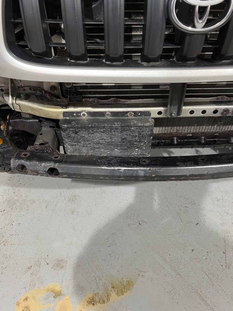

    I was going to start my ARB bumper install today but have a question. Actuality, I’ll probably have lots of them. The first is that my truck had an aftermarket trans cooler. I’m assuming this can’t stay where it is with the ARB bumper:

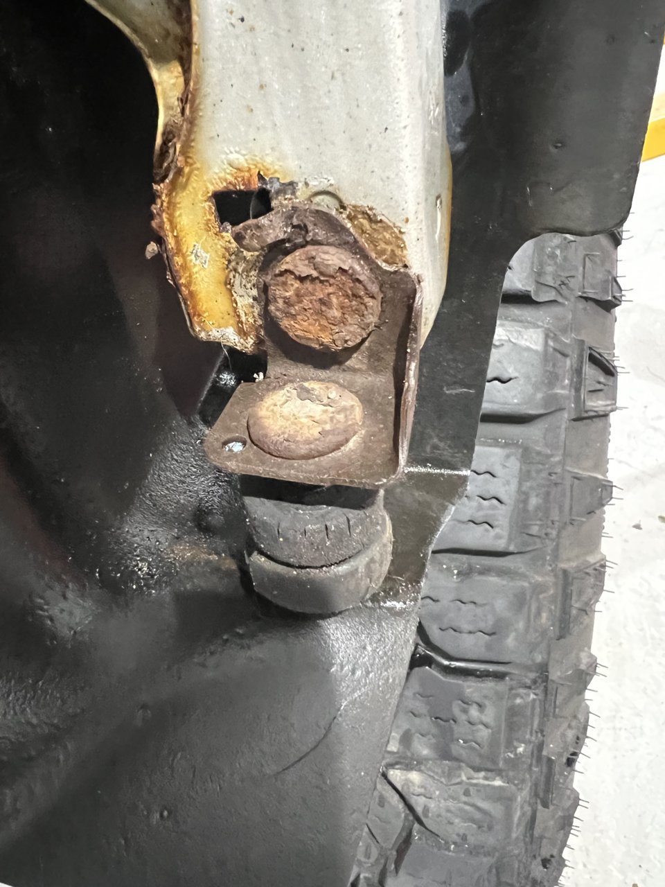

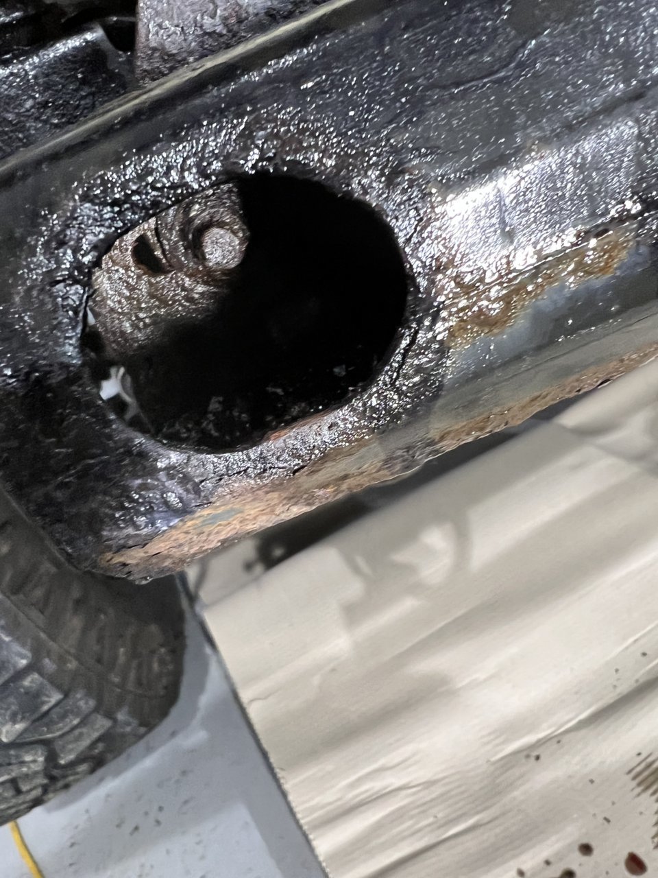

    Question 2: 3 of the 4 nuts that hold the stock crash bar in place are completely corroded. Cannot get a socket in them. Do just cut this bar off?
