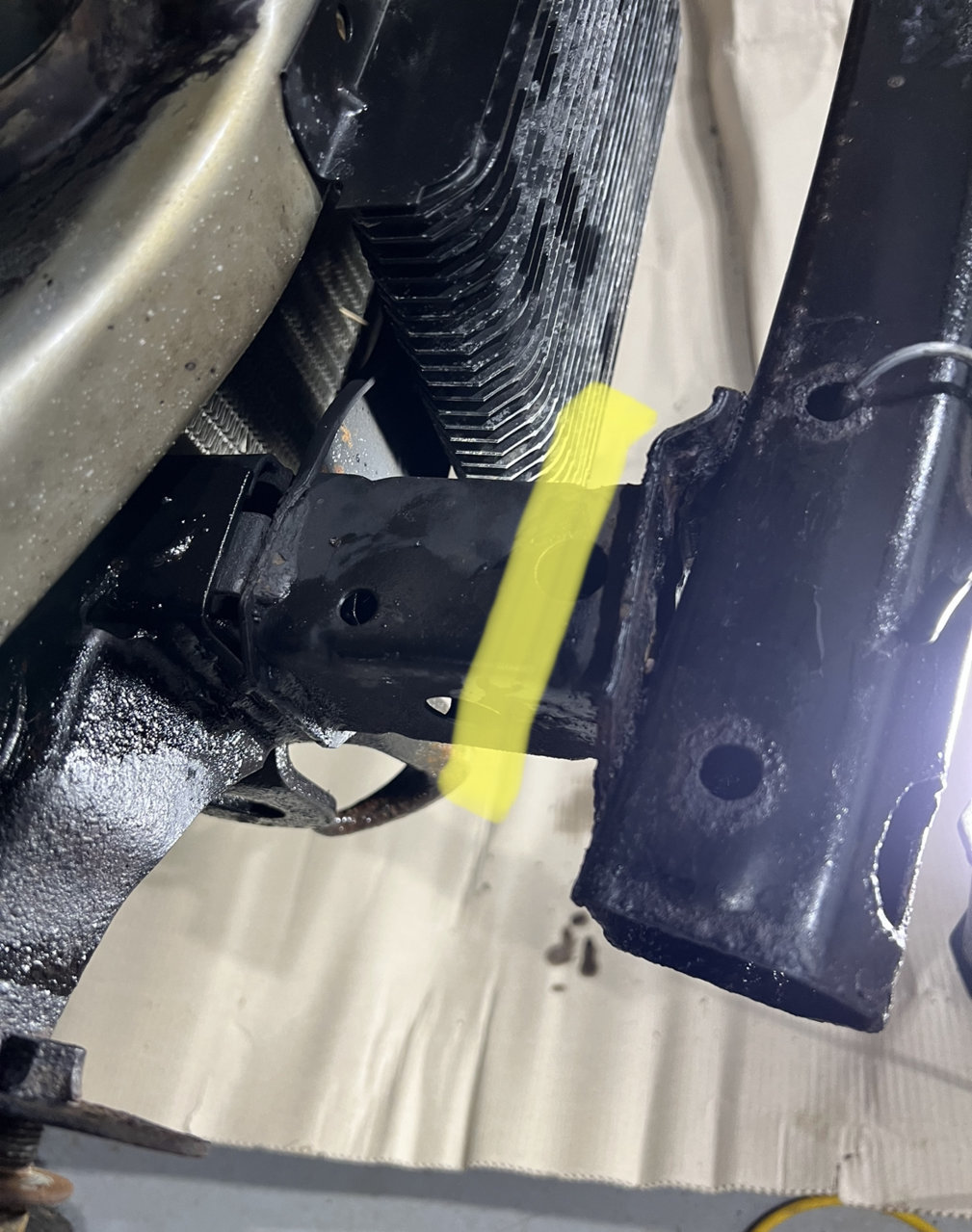

    Not ideal placement.

    I believe that this bar is removed for install. You’ll need those holes though.

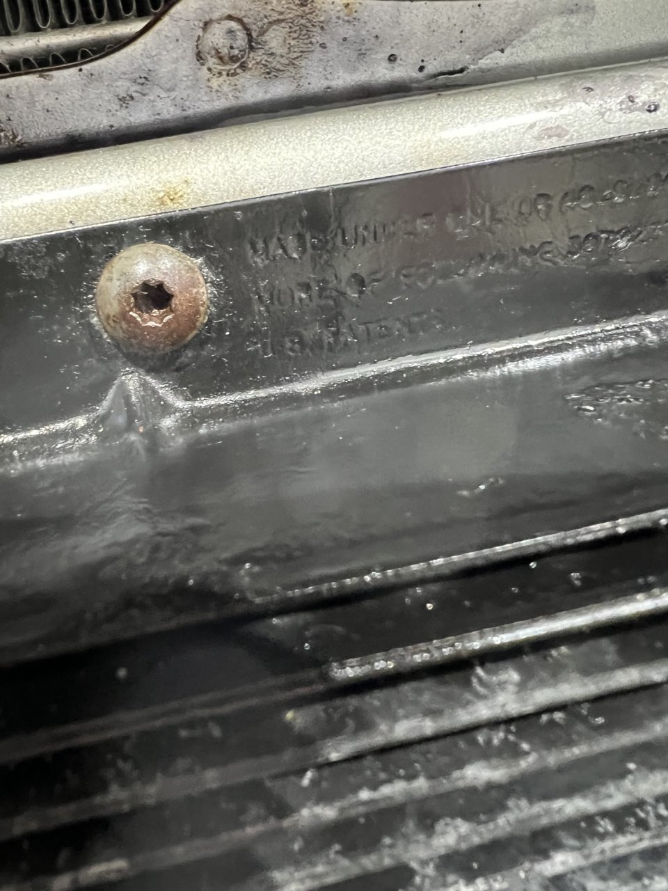

    Ok. Will do. I cut the crush cans off. I don’t have an 8-point but to remove the little bolts holding the trans cooler. I don’t think I’ve ever seen bolts line these. 3F7007FB-8412-4D2A-A402-A2A4D50F26BE.jpg

    torx
    (you can usually find a hex to fudge, but don’t… those are too rusty)

    None of my torx fit. T20 is too big and T15 is too small.

    try cleaning the screw out…
    (might be ‘torx plus’)

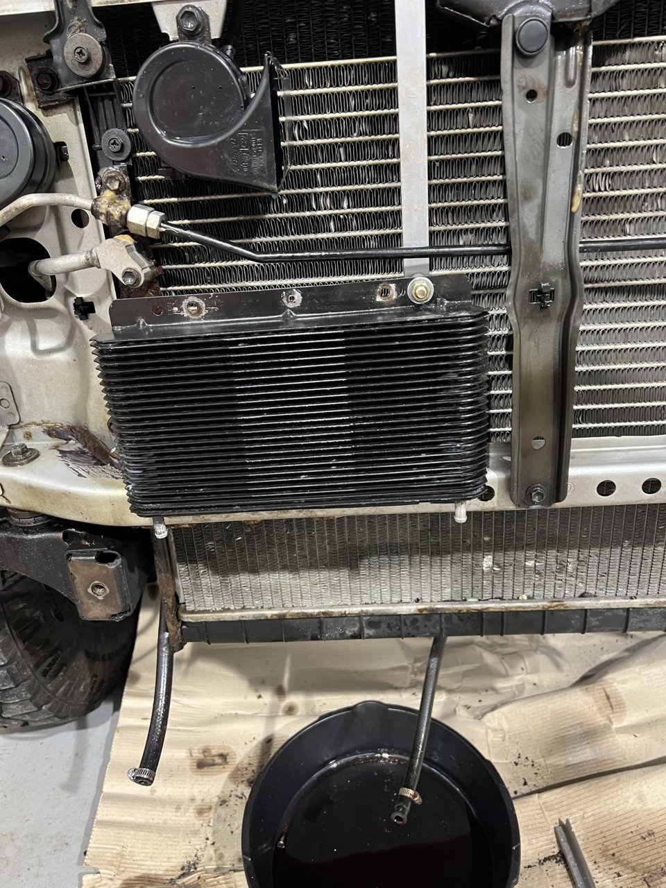

    Ok. I got the trans cooler disconnected. Used vise grips. Before moving forward with ARB stuff, where would you recommend I put trans cooler? Zip tie it through radiator?

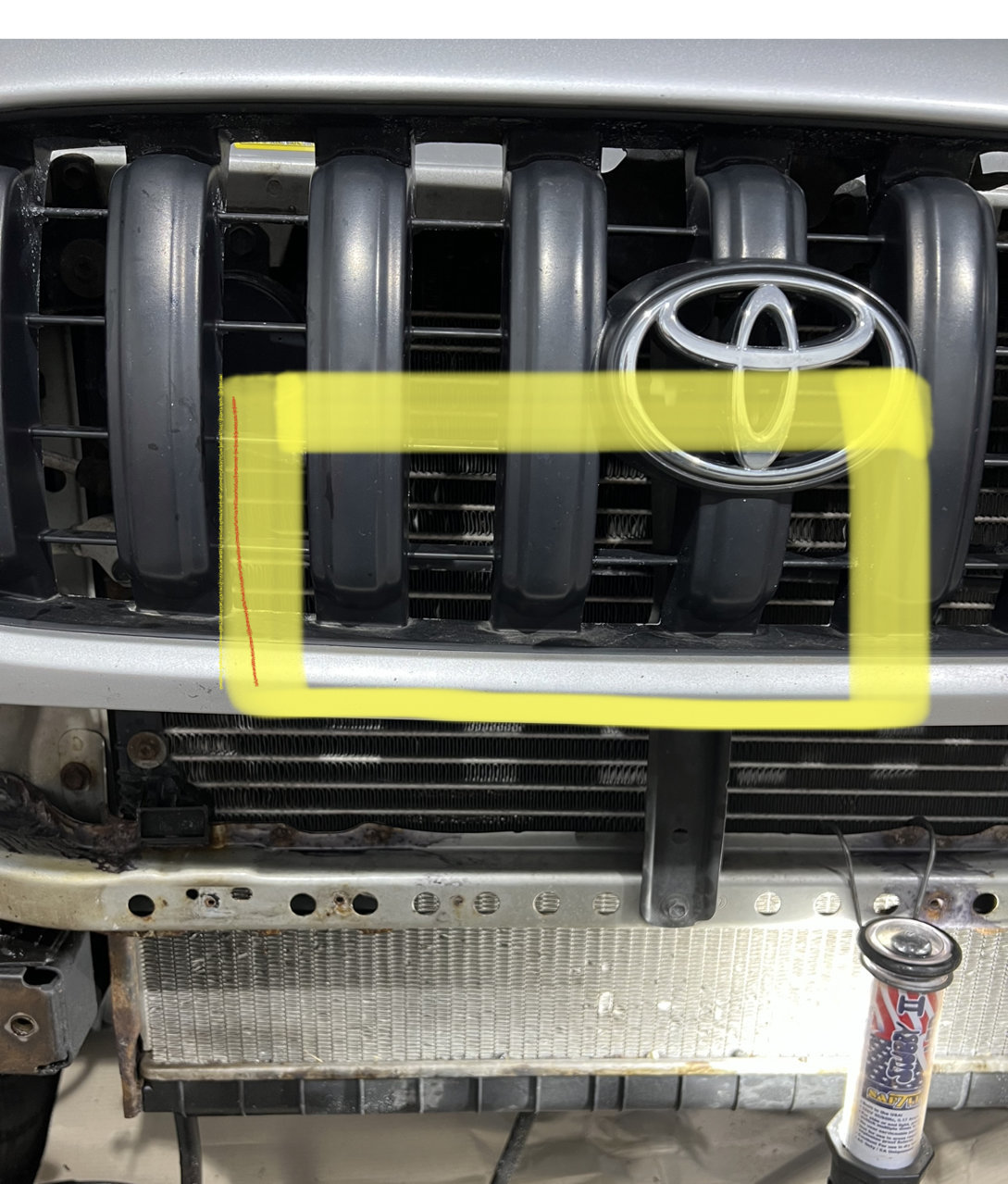

    Or higher up through condenser? I would think it would get more air if in front of condenser.

    Like maybe up in here:

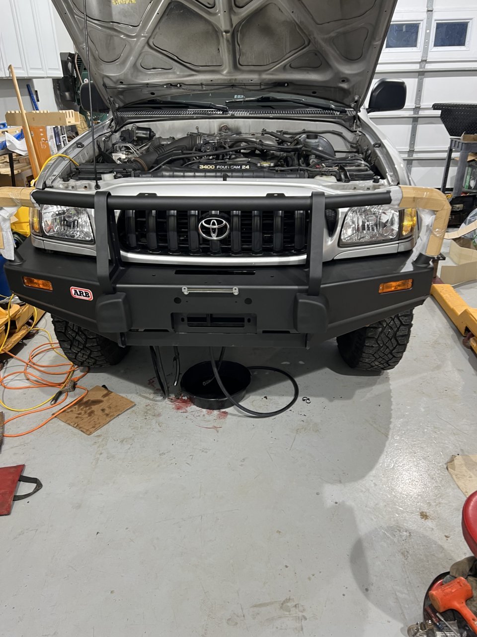

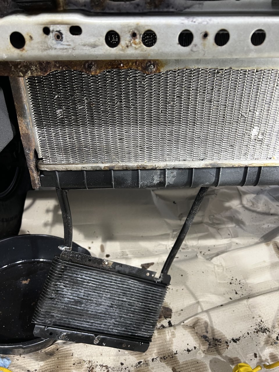

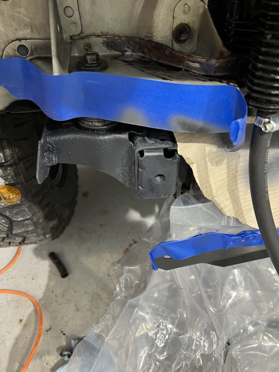

    0912E9AB-5893-4F6E-AE34-505B64FEA70A.jpg Ok. I’ll do that. I moved my trans cooler and mocked up the bumper today. 61CD1F09-DD6C-4F46-BD26-1BFDB4D8E591.jpg

    I drilled the frame for the passenger side. Will do the driver side tomorrow. I primed the frame where I had to drill through it. I’ll paint it tomorrow. Will also do that with all the bolts.

    Looking good. Just take your time, think things thru. Where you are rust prevention is everything, so anything exposed needs to be protected.

    Bumper pads are upside down.

    Ok. Thanks!
