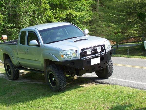

    Anyone got a pic of this all pro?

    This is only true if you don't mind your front end dropping 1/4" to 1/2" over the stock bumper configuration. I had enough clearance to drive around town with my ~33's and after the All Pro bumper install I couldn't turn the wheel w/o rubbing. After raising my front suspension by 4 complete turns on my Donohoe's (~1/2") everything was fine again.
    Remember, that 80lbs if WAY out in front of the suspension and the moment applied by the 80lbs is pretty significant.
