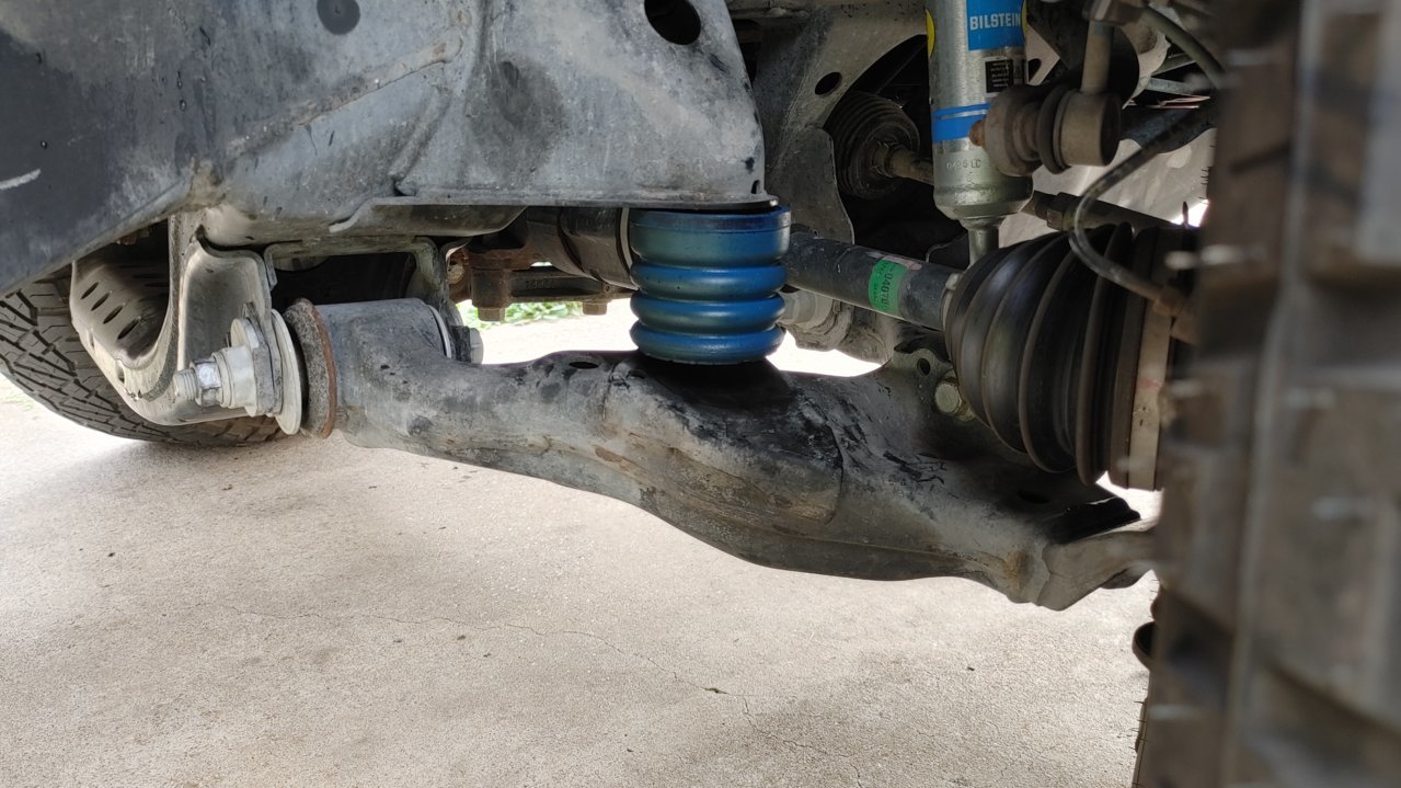

    Pro grille, Black SEMA wheels, air dam delete. Rear Blue Sumo springs. Front Timbren Active off road bump stops. Bilstein 5100s front and rear.
    Yes. However they seem to be load bearing as well. I have em on but i dont have any additional weight in the front. They really smooth out the front and they say it can support weight too.
    helix66[QUOTED] likes this.
  10. Sep 1, 2021 at 4:25 PM
    12TRDTacoma
    12TRDTacoma Powered by Ford, GM, VW, and Mercedes
    Aug 20, 2012
    #85133
    16,671
    Rob
    Concordia
    12 TRD Sport DCLB 4x4 Supercharged
    Boosted
    They look nice but those are just a band-aid to the issue. A properly set up suspension will never demand you to ride on the bump stops during normal driving or in turns. If you're installing these to remedy excessive leaning or sag, then you have a spring/ shock issue or maybe even both.
  11. Sep 1, 2021 at 4:28 PM
    TheRedComet
    TheRedComet Well-Known Member
    Jun 3, 2019
    #295256
    144
    Here
    2017 Barcelona Red TRD Sport 4X4 Manual
    Well it's hard to not ride on these as they are almost always engaged even unloaded. Here's a pic from my setup.
    12TRDTacoma[QUOTED] likes this.

    18 tacoma limited
    Fox 2.0 - KDmax tune - 5.29 revolution
    are you lifted?
    TheRedComet[QUOTED] likes this.

    Oh! Those are for the front! I thought that was for the back. As you were. Lol.

    Leveled about 2 in
    Haha yup everyone thinks that. This is a hot off the press new product I saw on their Instagram. These babies are real smooth.
