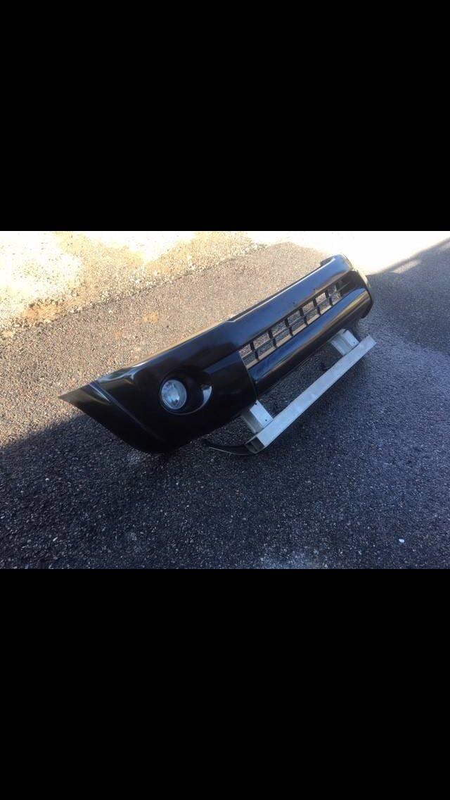

    Does this bumper look right, maybe it’s just the crash bar throwing me off...

    It looks right to me. The crash bar is just propping up the bumper. The key to making sure it’s right is to make sure it has the separate flare pieces held on by clips. The 5 lug Tacos don’t have slots in the bumper for the flare pieces. The X runner bumpers have a lower spoiler that protrudes forward.
