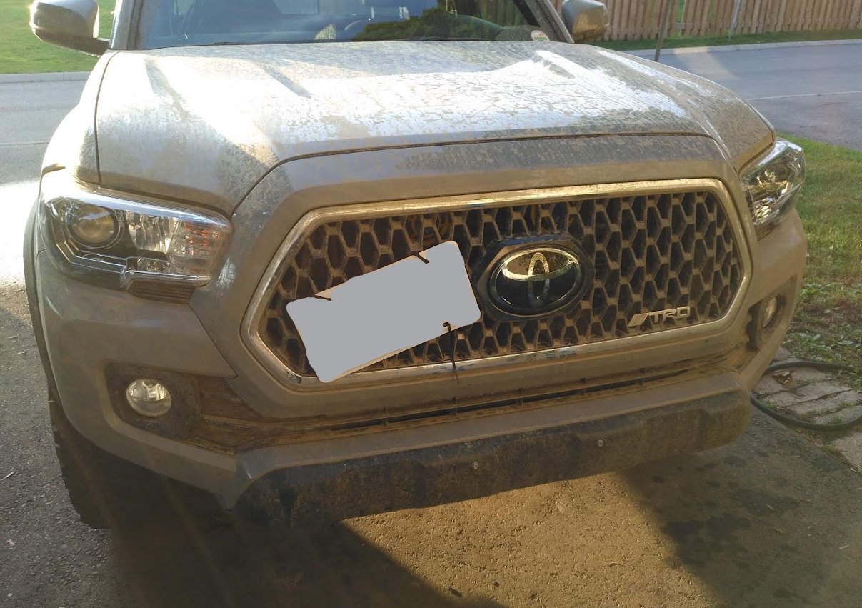

    You can drill 2 holes into the bumper, you can zip tie to your grille or the bar

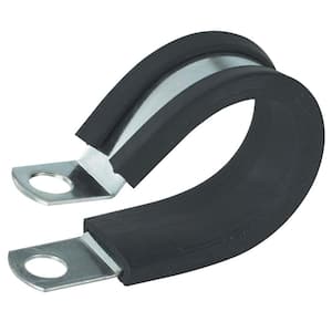

    Two P-clamps like these on the hoop, with nut and bolt through the top two license plate holes. Drill new holes in the license plate if you need to move it up or down. Be careful not to block the radar.

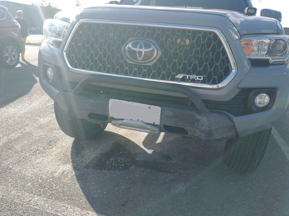

    I pinched between the bumper and the fairlead for the winch (for a while i had some amazoom special cheap-o fairlead to hold it there before getting a winch)
    with some rubber pads. Scratches up the bumper when it flops around since it's held at one end but otherwise, it's not moved since i got new plates
    :hattip:
    but yes, otherwise drill 2 holes into the bumper, pop some rivnuts on it and call it a day.
    not like you're gonna return a bumper once you start cutting up the truck
