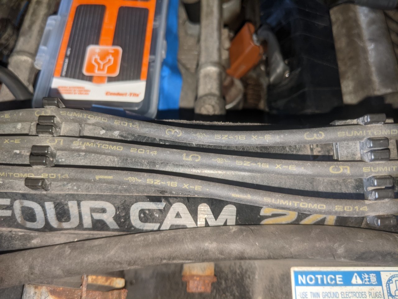

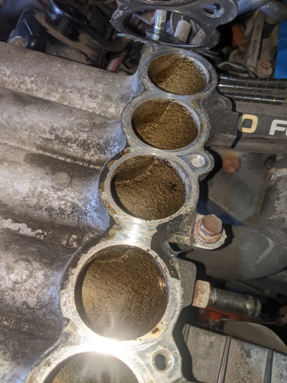

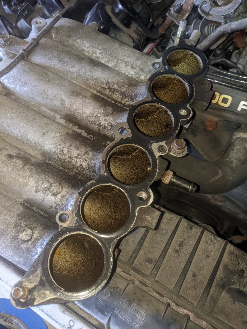

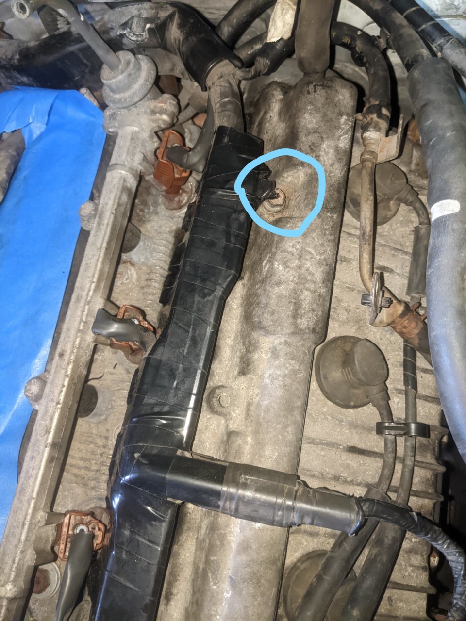

    Could these gaskets be the cause of the P0300 code?
    There are also a couple of broken connections both they appear to just be bolts that hold a plastic component onto a part of the engine, not any sort of ground.
    I checked my plugs and the gaps are good on them. Replaced them about 3 months ago.

    Did you reuse the original intake manifold gaskets? They should be replaced for sure. But I don't think that would cause a p0300 (misfire) code. I would expect the gaskets to end up somewhere in a vacuum related code.
    Those broken plastic bits wont cause a problem.
    I'd get some electric contact cleaner and clean each of the injector connectors while you're in there. (or replace your injectors while you're there.
    Are your wires new? they look original to me. I'd pull them, clean the contacts, and reseat them.
    Use a wire brush and clean the ground strap on the driver side intake manifold...

    Do you spray contact cleaner into the injector or just into the portion that clips into it?
    I believe the wires were replaced with ones manufactured in 2014. I believe thats right based on the labels?
    Do you also spray contact cleaner into the bottom of the plug tubes? Where they meet the spark plugs?

    Contact cleaner just going on the electric bits. You would have to remove the fuel rail to spray it into the injector- but you would not want to do that. You're just trying to ensure that no contaminants (oil, dirt, etc..) made their way in there during your valve cover job. Make sure they fully dry before re-connecting (I usually wait several minutes).
    2014 is still 6 years old.
    Yes, there should be a rubber boot - clean there. The other end of the wire connects to the coil pack- disconnect, clean, and reseat these.
    The goal here is that you're reseating anything which might be preventing spark, even if you didn't specifically disconnect it as part of the valve cover gasket job. You want to ensure all the electrical connections are clean and seated correctly.
