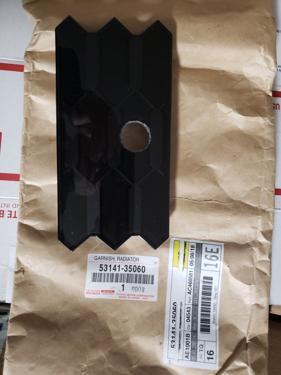

    Here's a pic of a garnish with a hole in it drilled for a camera.

    I bought my front camera setup from a guy who used that garnish. He said it worked well for him.

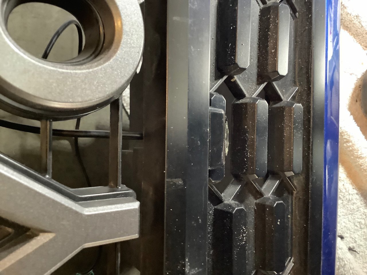

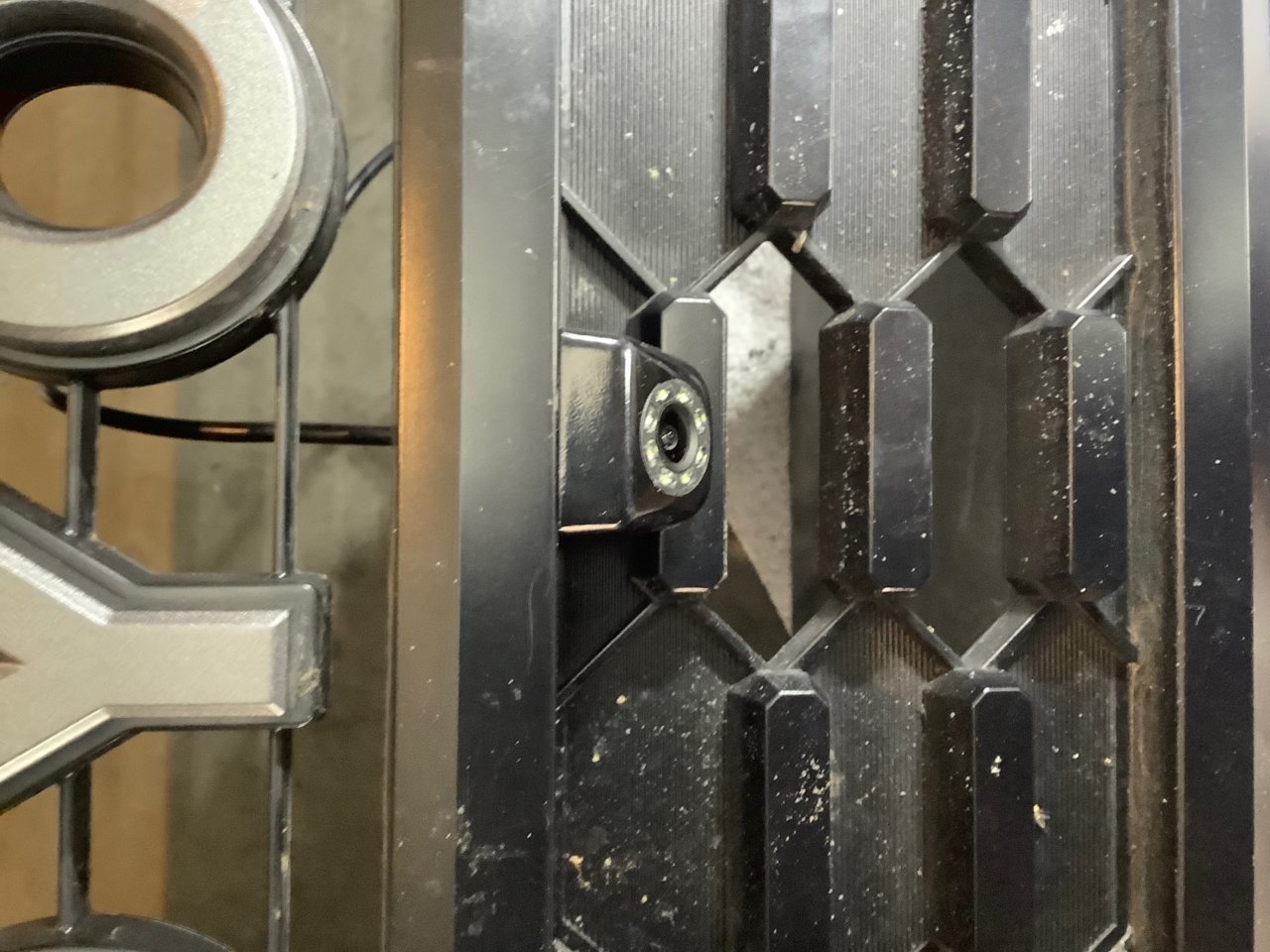

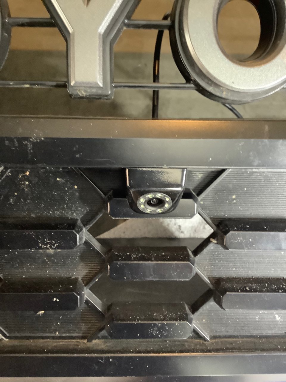

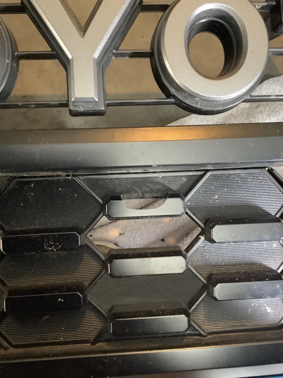

    Good video but don't mount the camera like that guy did. I don't think it looks too good sticking out past the grill (about the 41 minute mark). Easy fix is to just take a Dremel and notch out the part of the grill below the camera. Much cleaner look doing it this way. I also used a 1/4" bit even though the directions called for a 5/16" bit. 1/4" was plenty big.
    The Anytime Backup and Front Camera kit is a great mod!
