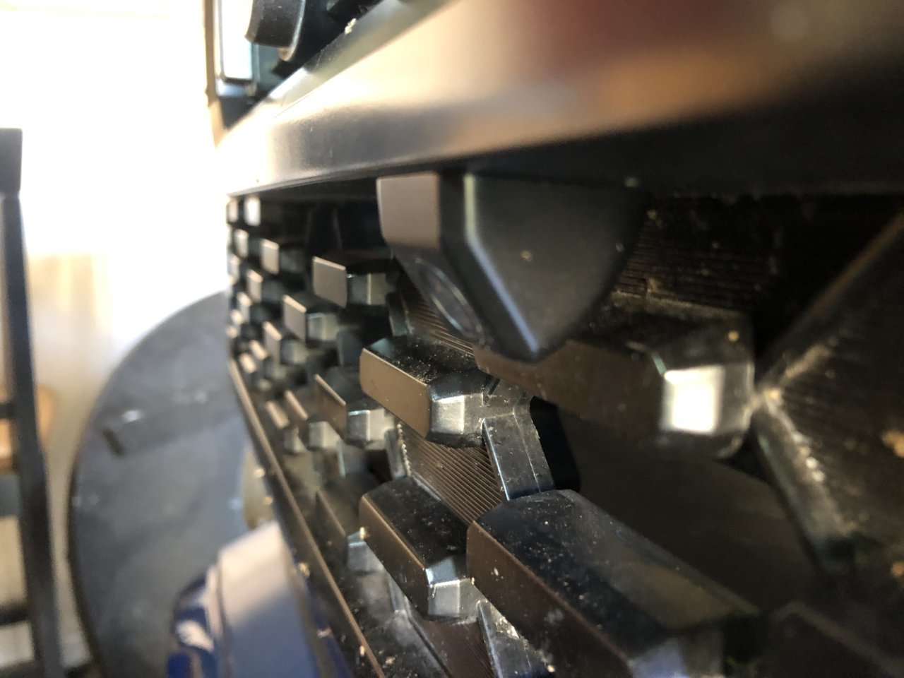

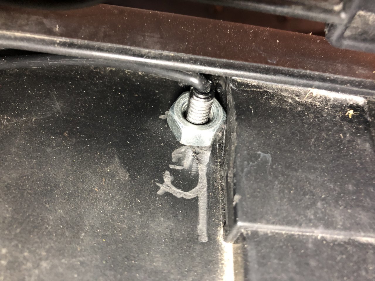

    Has anyone drilled into the trd pro grille while it was on the truck?
  5. May 25, 2019 at 4:53 PM
    #45
    AllGen
    AllGen Active Member
    May 2, 2018
    #252350
    44
    Shawn
    Texas
    2016 Blue Tacoma Limited 4x4
    Hidden front bumper 32" LED light bar HID headlights Morimoto XB fog lights Pop and Lock for tailgate Metal oil filter housing Bed extender OE bed mat OE bed front rail for sliding hold downs Toyota first aid kit Bed cubby hole block offs Door seal protectors with aluminum inserts OE LED bed light pods and Matt Gecko LED strips OE TRD Pro grill Ceramic tint MESO gasshole and coin holder 1/2" Toytec front shock/strut spacer (leveling kit) 1/2" Toytec rear leaf spring shims with 7.5" u-bolts (leveling kit-IMO) Anytime front and rear camera Shapeway's drivers side cubby switch insert (anytime camera switch location)
    Yes, I did. On page 1, Dammit Evie shows a template cutout he made of the camera base with a hole for the bolt location. I did the same thing and used a silver sharpie to mark the bolt location before I drilled. I did this so my camera could set flush with the grill and not poke out like some of the others I've seen. I had to cut a little bit of the bracket on the inside of the grill so the bolt would turn. The camera sticking to far out may also have to do with the different cameras/sizes out there...maybe.

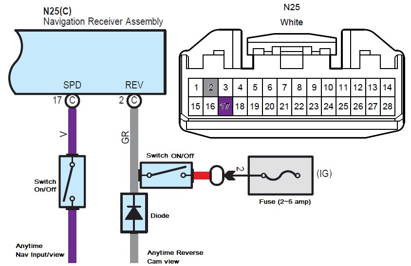

    The middle camera light? Sounds like you have everything wired correctly because red (switch wire) goes to red (relay wire), orange (switch wire) goes to orange (radio connector wire), green (switch wire) goes to green (radio connector wire) and then black to ground. Maybe the switch bulb/LED is out. I watched some videos with the same switch and mine like there's stays on when the ignition is on. I wanted to run the middle light so it only lights up like the OE switches, only when the headlights are on, but the diagram seems to indicated the red wire does more then just light it up (activates the relay) and there isn't a separate wire just for the light like other aftermarket switches.

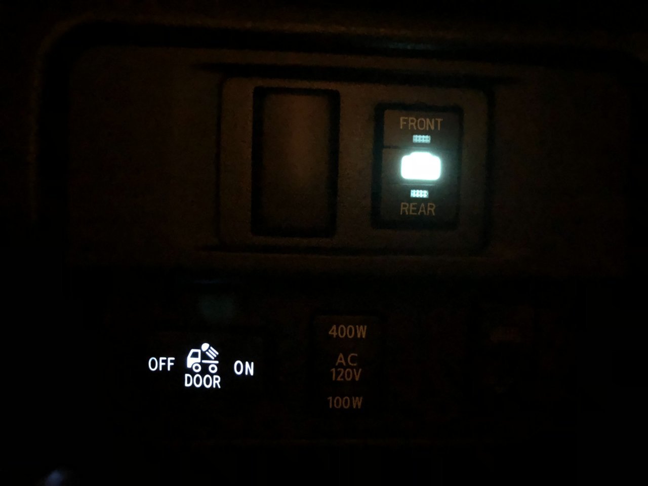

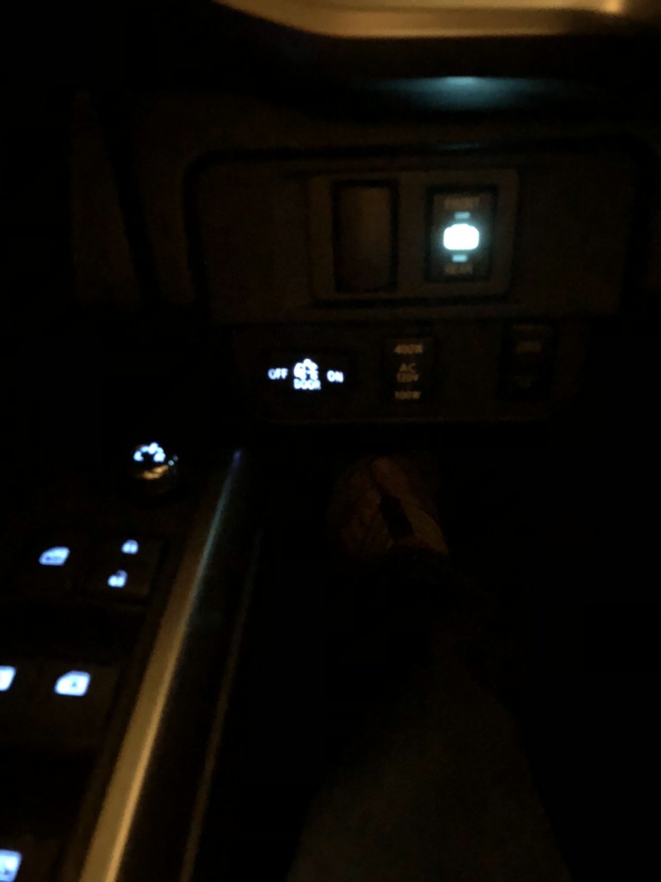

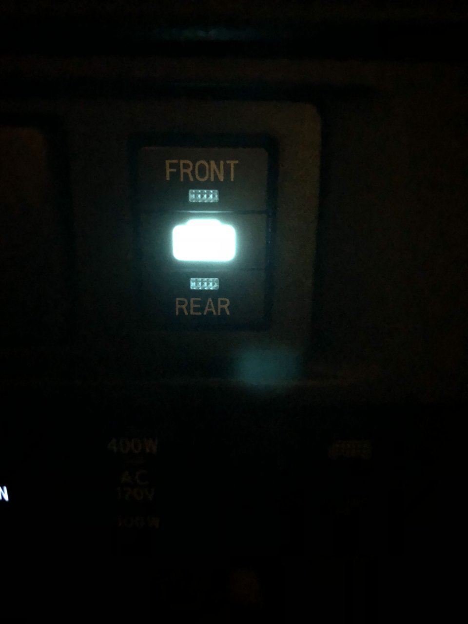

  9. May 25, 2019 at 8:34 PM
    #49
    AllGen
    May 2, 2018
    #252350
    44
    Shawn
    Texas
    Not really close either. More of teal blue and a lot brighter. I had a 97 Tacoma with red interior lights and an aftermarket fog light switch that illuminated bright orange. I pulled the fog light switch apart and went over the inside of the lenses (not the bulb) with a red sharpie. It then matched perfectly with the other lights and never came off or faded. This light not matching also bugs the heck out of me. I may order another one of these switches and try that again.

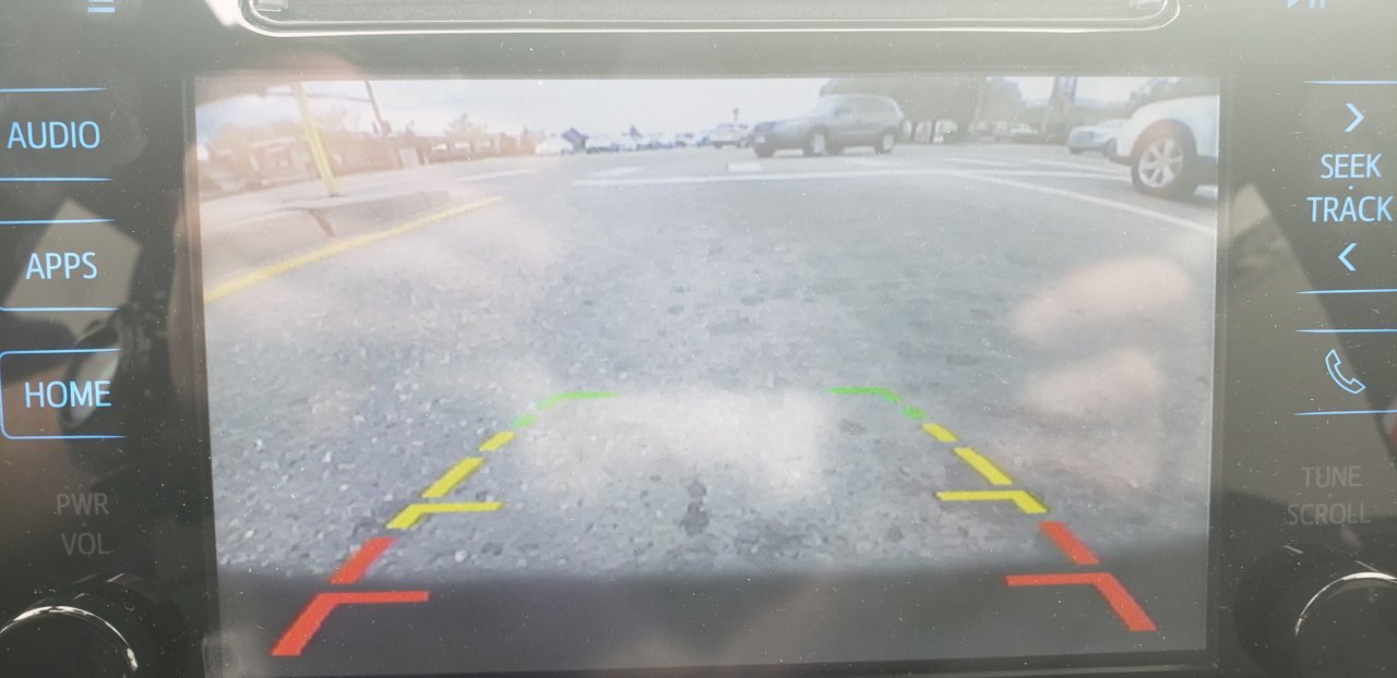

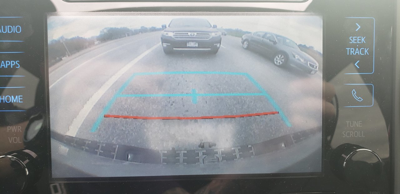

    Do you have a pic of the view on the screen when on? Curious how much you can see
    PacTac likes this.
  11. May 25, 2019 at 11:00 PM
    #51
    Hoonatic
    Hoonatic Well-Known Member
    Jan 21, 2017
    #208222
    114
    PDX
    2017 TRD OR DCLB
    He beat me to it, but I would also very much appreciate a screenshot of your view with the camera in that location. This looks to be a pretty ideal spot. Thanks in advance!

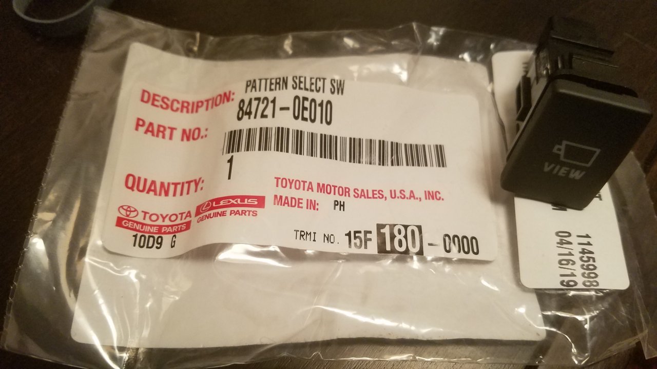

    Thanks alot, I appreciate it. I bought the OEM "birds eye view" button out of a new Highlander, it'll fit in the Tacoma switch blanks but its a momentary push button so Im not sure how to adapt it to this application. Ill have to some reasearch. Sorry Ill let you guys get back on topic
  13. May 26, 2019 at 7:04 PM
    #53
    baldbeardedtaco
    baldbeardedtaco Well-Known Member
    Sep 4, 2018
    #265223
    3,328
    FL
    18 TRD Sport DCSB MGM
    You have a picture and pt# that might actually work for the beatsonic button. It seems more like a momentary button than on/off

    Sorry for the glare. Front Camera:
    And the rear camera for reference:
