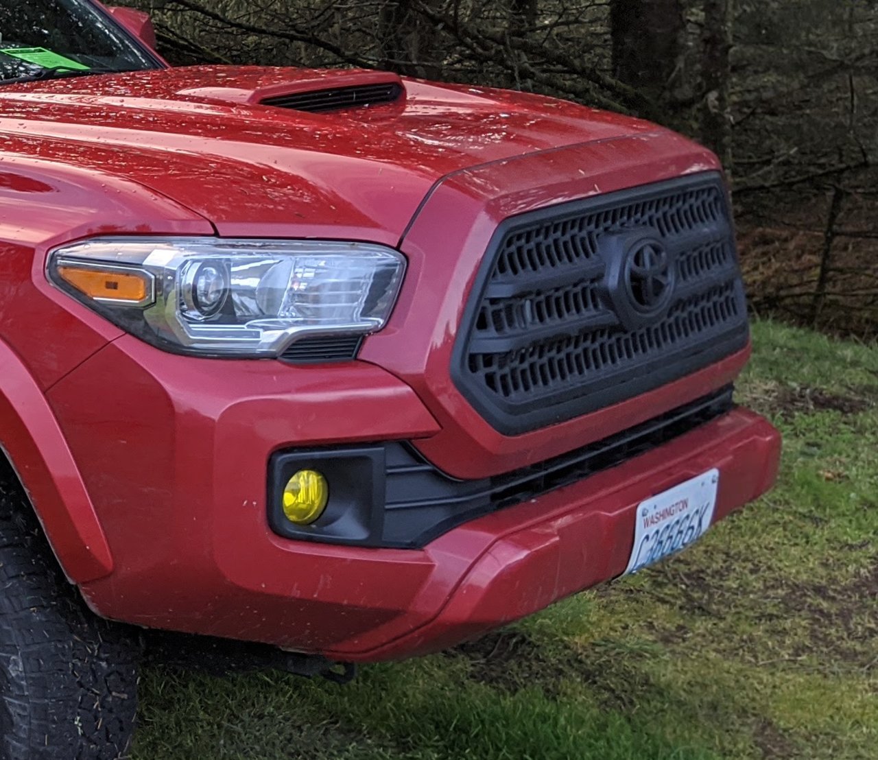

    I have had this one since December 2017:
    https://www.amazon.com/dp/B00P2EN5J2/ref=twister_B00P2EN3T4?_encoding=UTF8
    It worked great until recently when some moisture got in and the image is fogged. A couple notes. It is not the best looking camera. It is all straight angles, not fisheye, which is great for somethings but does not allow me to see the edge of the bumper for parking. It is about 4in away.
    Also, the side option in the listing is nicer and is fisheye / wide angle but does not fit the Taco badge.

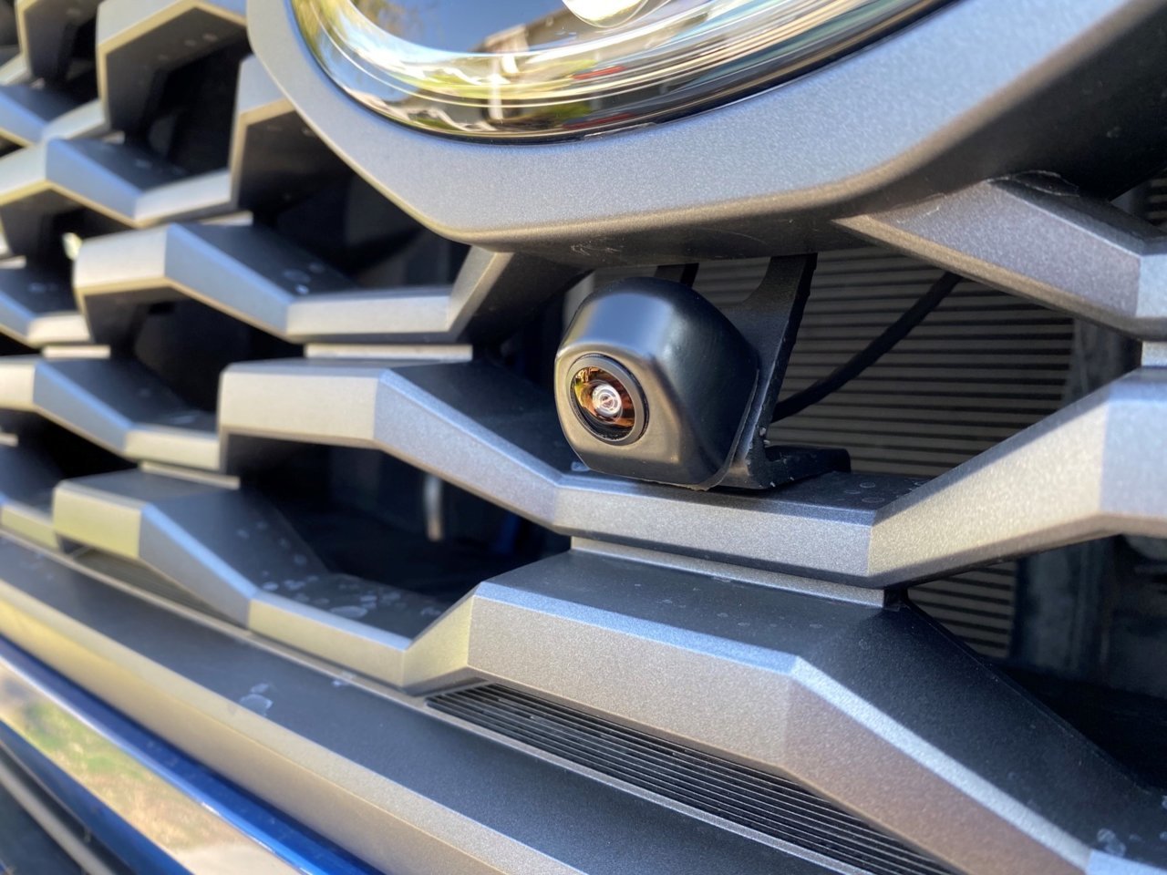

    I installed a bullet style camera from Amazon with the anytime harness on the 2018 grill. Then I upgraded to the 2020 OR grill and used the camera mount from the tacogarage 2018ORCAM1.jpg 2018ORCAM.jpg2018ORCAM.jpg2020ORCAM2.jpg2020ORCAM.jpg

    Yes. 2017. The subject was for the cheese grater grille, which are generally 2016 / 2017 grilles. I see that I got crossed up there with yours and the OPs MYs.
    2018+ are egg crate grilles? No big deal though.

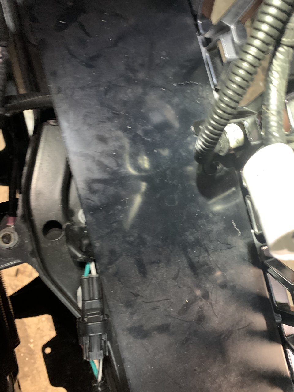

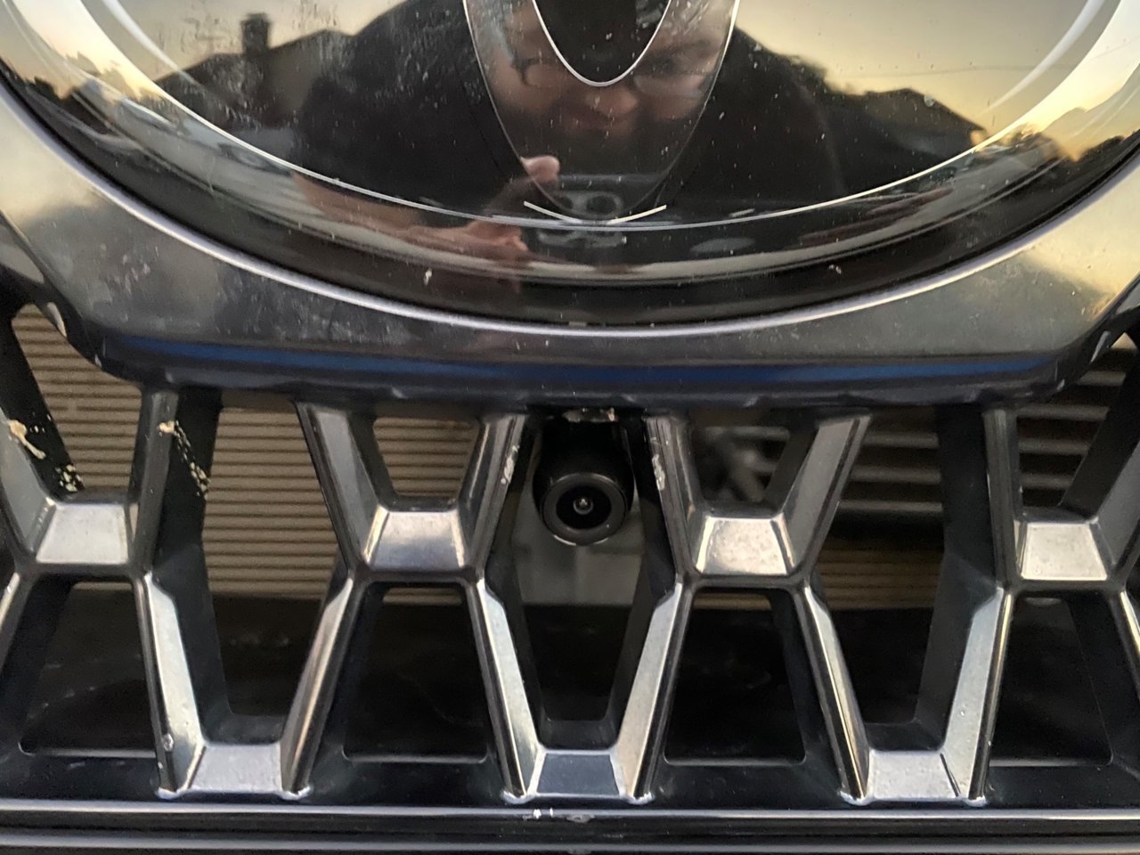

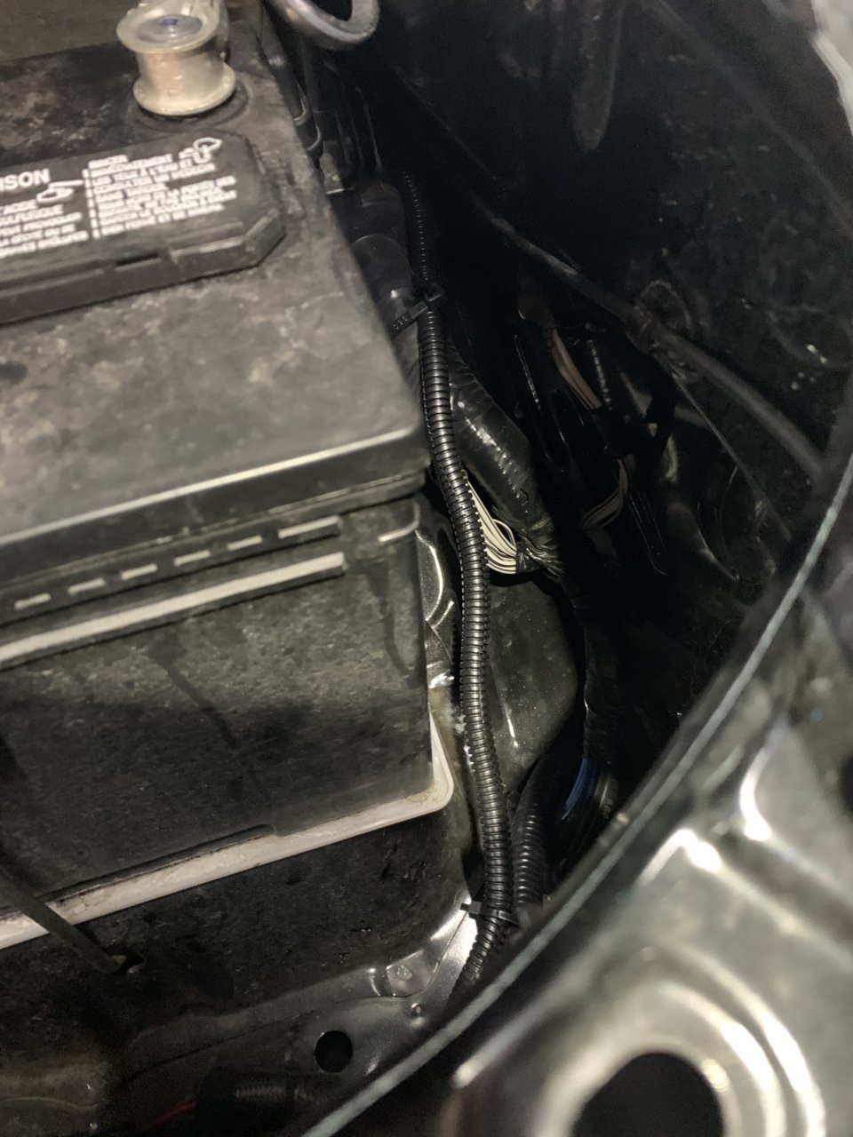

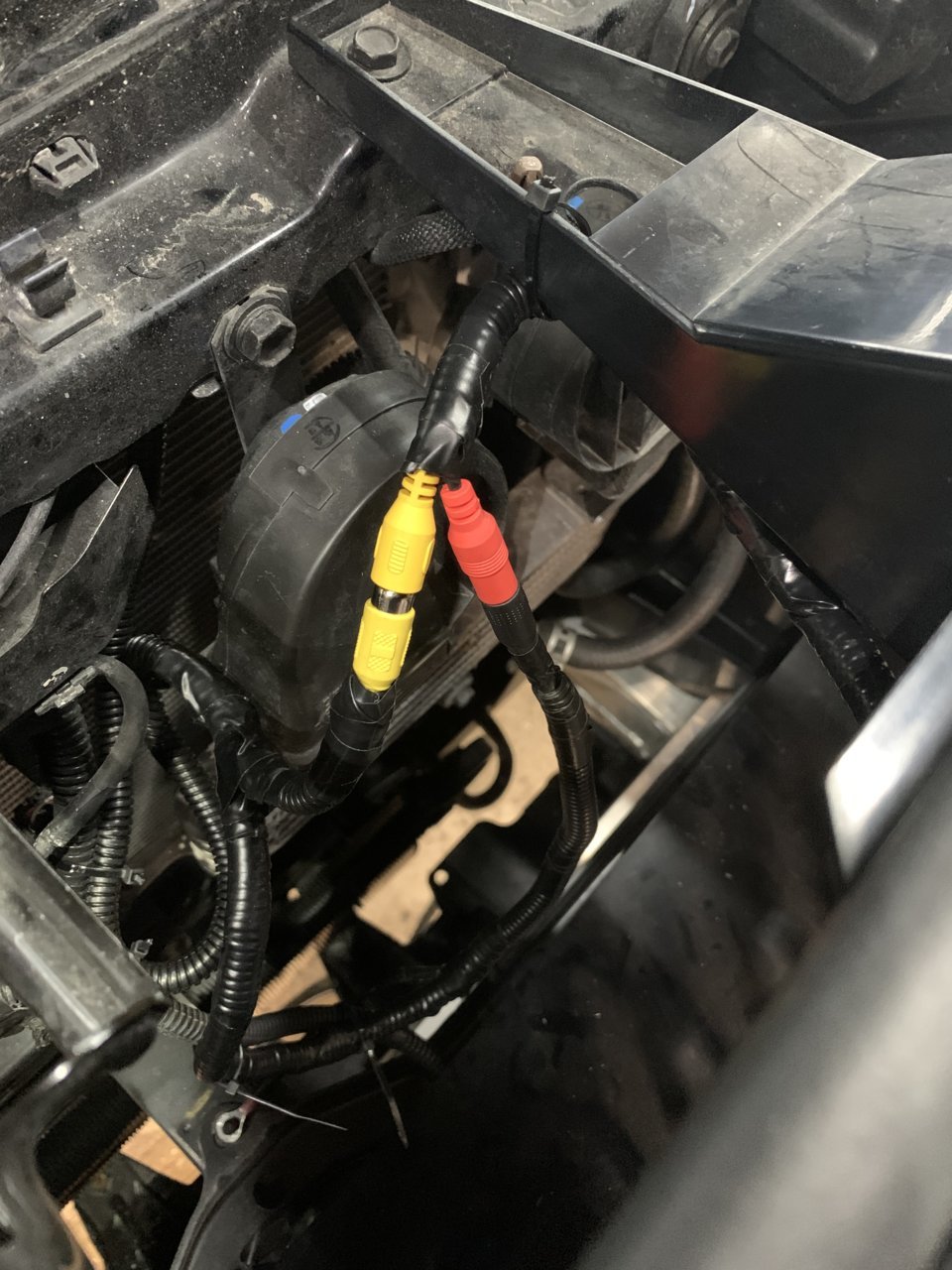

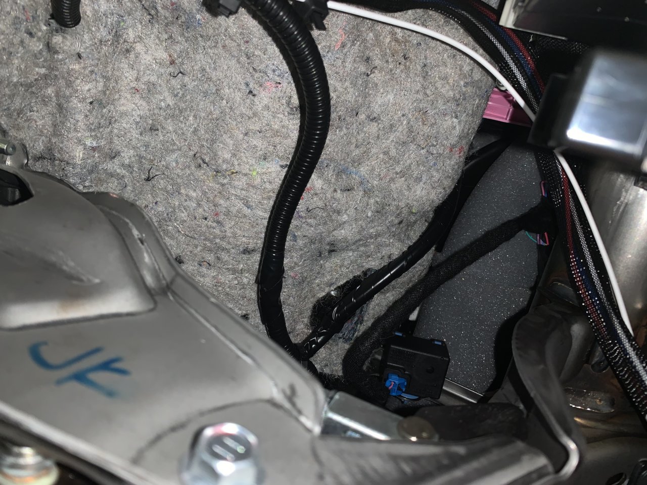

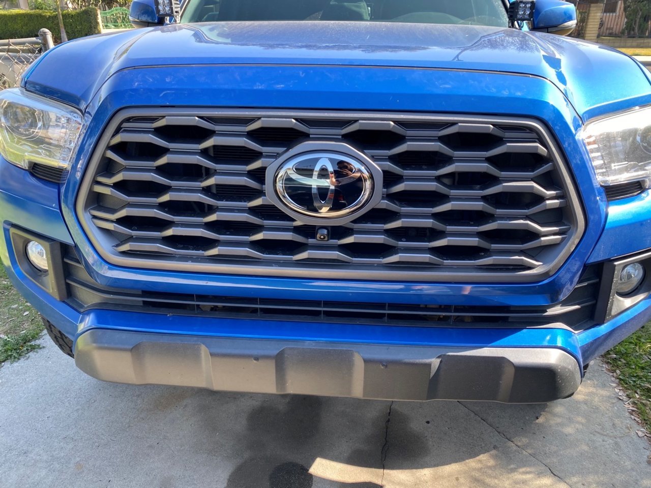

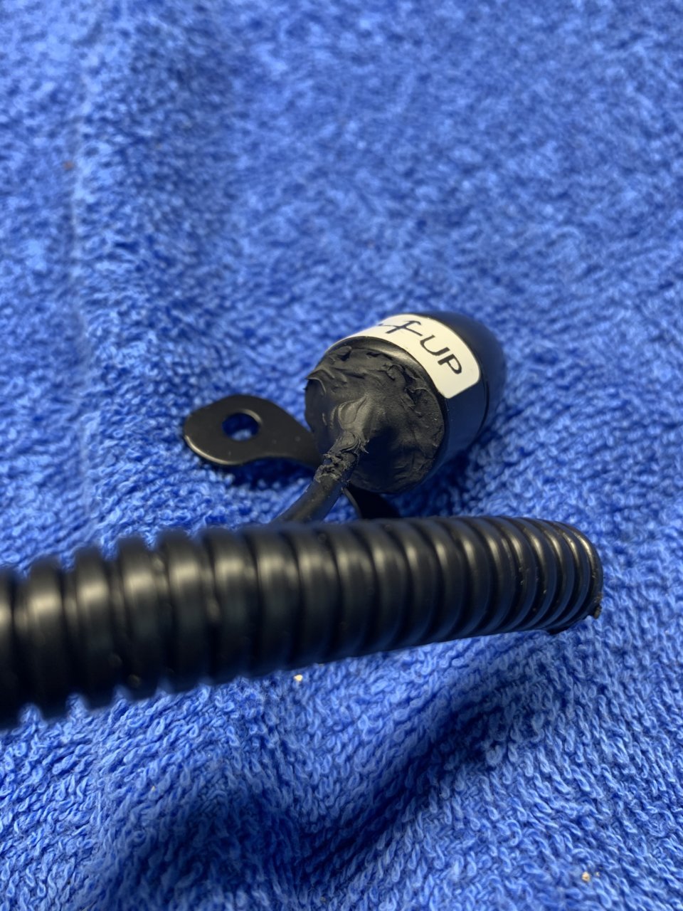

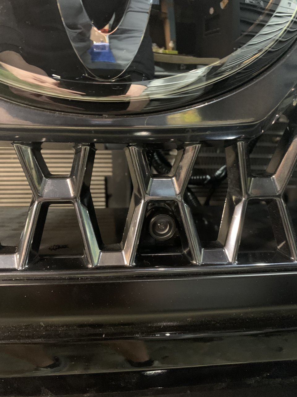

    Alright, so I installed this over the last two evenings. I ditched the HDPE idea and just ended up drilling two small holes behind the grille.
    I used this camera:
    Reverse Backup Camera,RAAYOO L002... https://www.amazon.com/dp/B074P45P7G?ref=ppx_pop_mob_ap_share
    It’s off-center bc it didn’t fit well in the center opening. If you raised it up a bit with a prop or something, it would fit.
    Not a great picture, but you can see the holes I drilled here:
    I tried to better waterproof the camera by adding some silicone where the camera wire goes in.

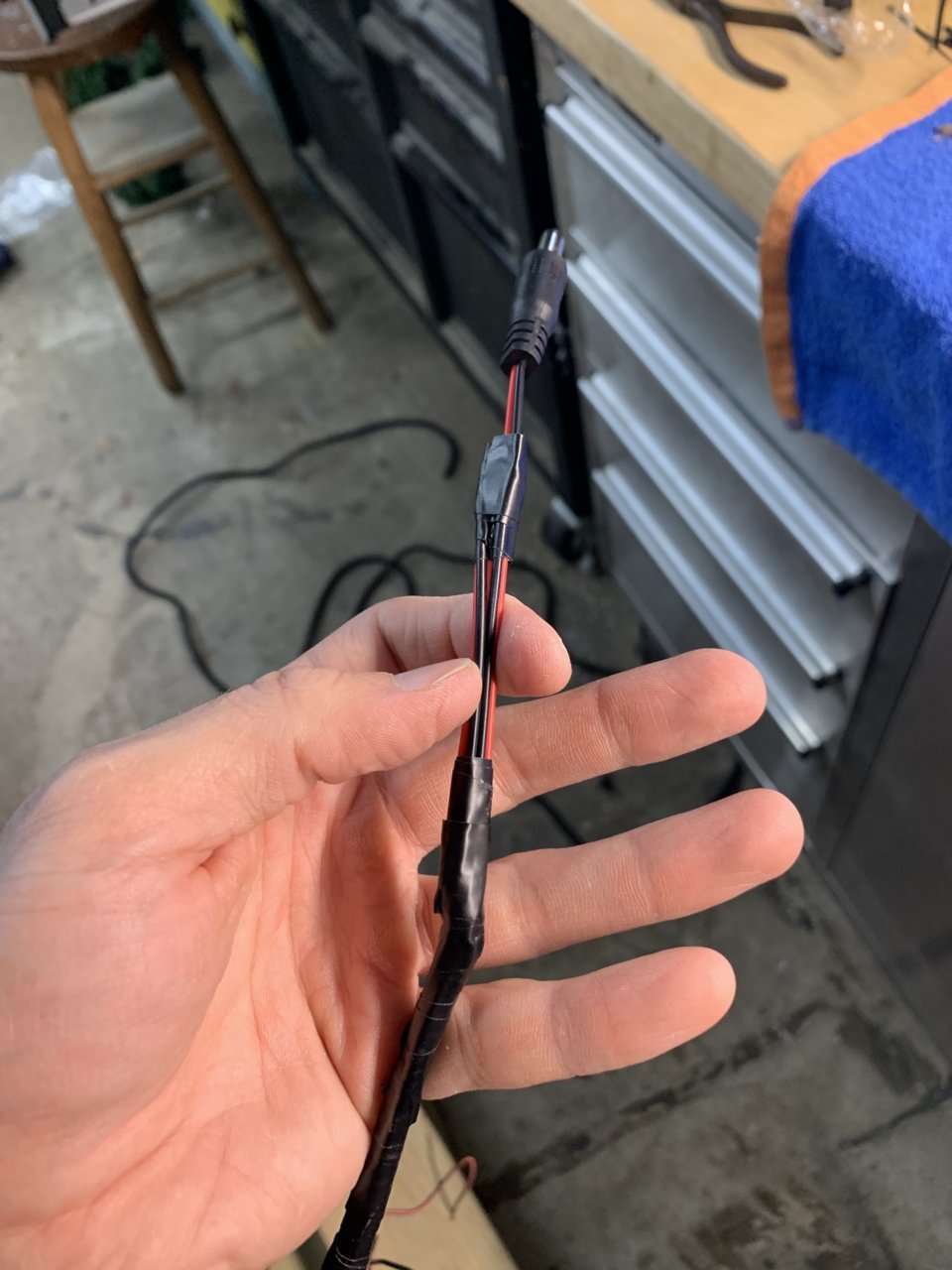

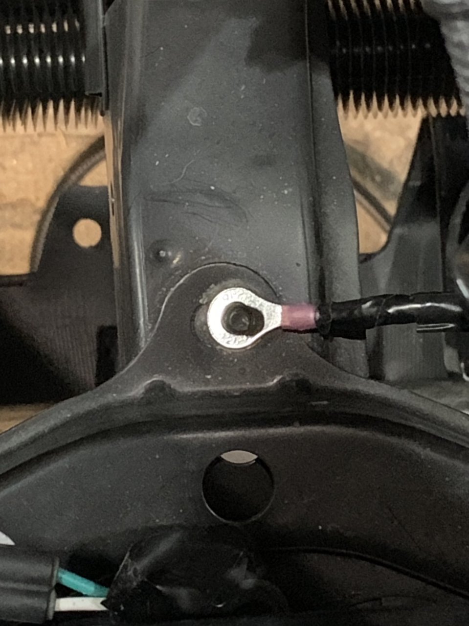

    So, this camera had a sightly different connection than the Natika. The power and aux connections are separate, and the power wire isn’t long enough to reach the head unit. Thus, I used the trigger wire in the aux to power the camera by connecting that to positive in the power harness and the positive in the Car Solutions harness. I then grounded the neutral wire in the power harness to the bumper. See below:
    The ground (I added the connector).
    The power wire is long but not long enough to run all the way to the head unit. Because you’re not running it all the way to the head unit, you could trim it shorter (it’s positive wire connects to the positive wire on the side of the aux that plugs into the camera inside the engine bay; you can kinda see this in the picture with the red and yellow connectors hooked to one another by the horn; both sides of the aux wire are the same with the aux connection and the red trigger wire), but I didn’t figure out my ground location until near the end of my install, so I didn’t trim the power wire. So to tidy everything up, I folded the wire in the power harness and taped it up to shorten it a bit. This is mid taping:

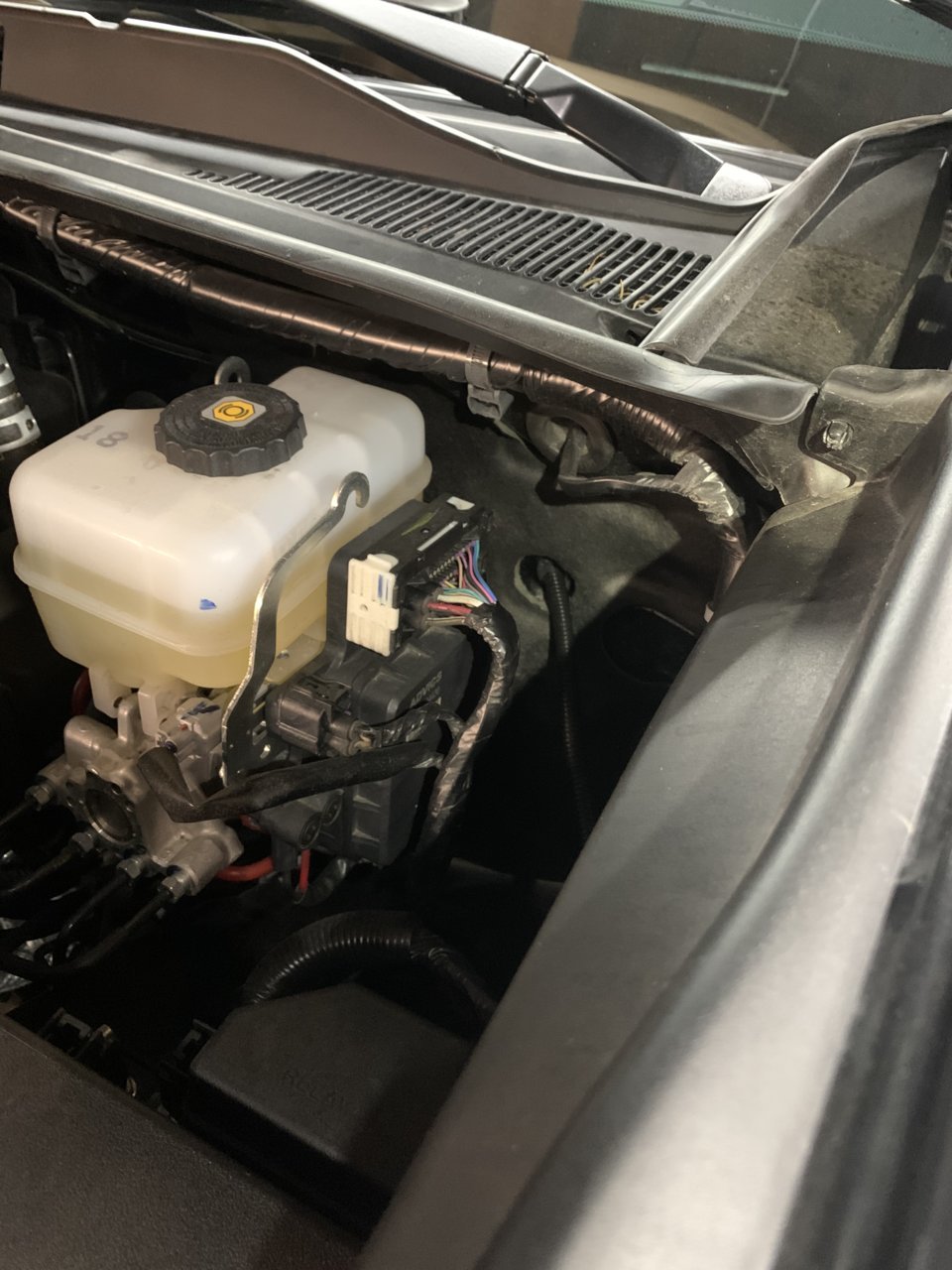

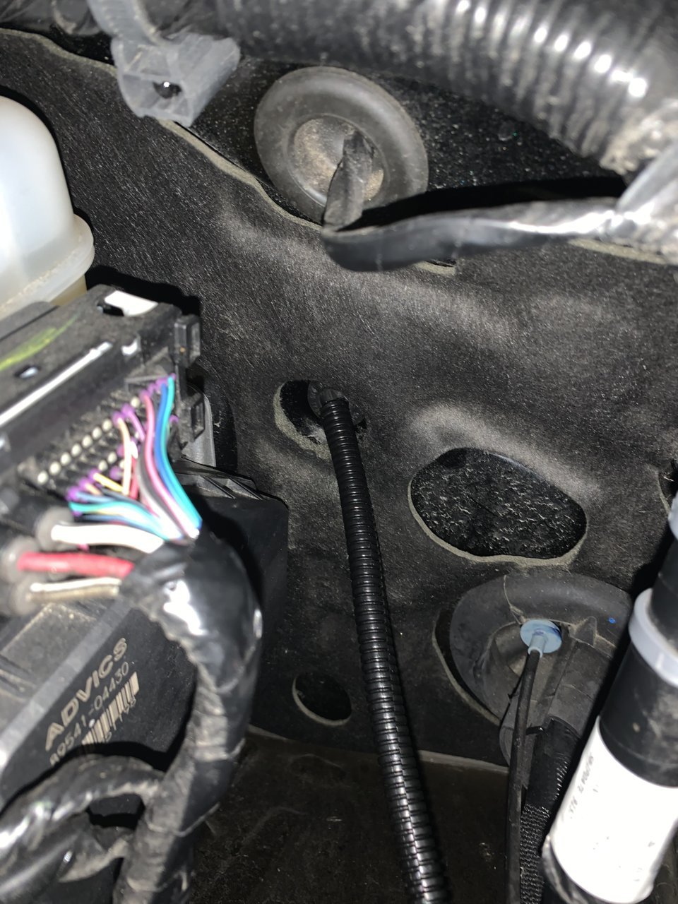

    I ran the aux wire through the firewall using the grommet behind the master cylinder. I did this before wiring everything together. The grommet is up and to the left of where the main OEM harness enters the cab, and it comes in by the brake pedal.
    Closer picture:
    Where it comes into the cab:

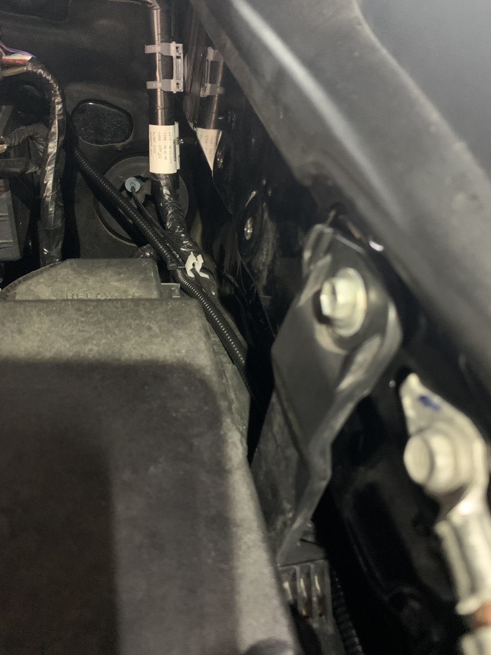

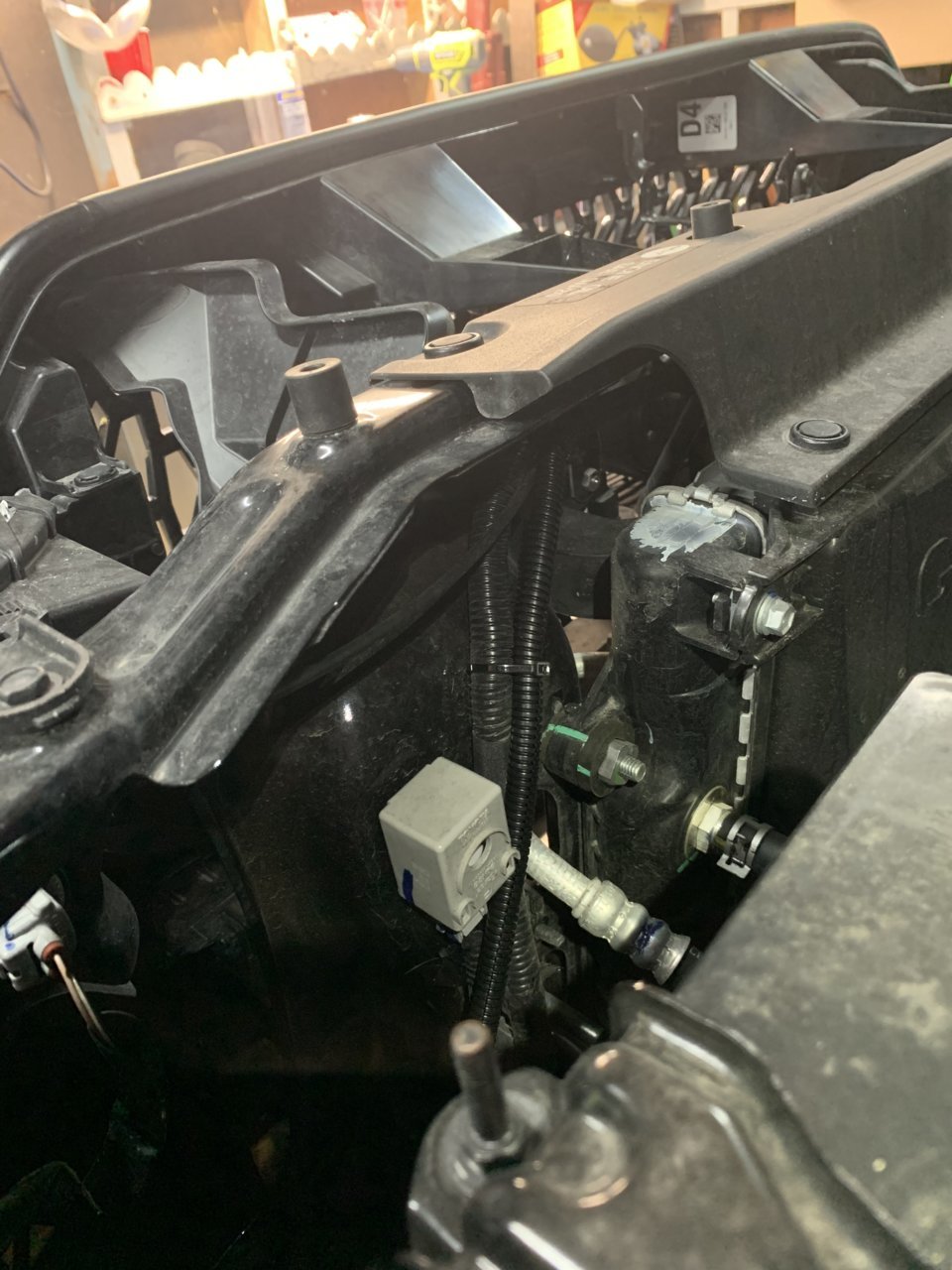

    I then loomed EVERYTHING and ran along factory wires, securing with zip ties. In the engine bay, I went along the driver-side fender, beside the battery, up by the radiator, and to the horn/TSS wires. By the radiator, I had to remove push tabs to take off the plastic piece that runs along the top (pictures reinstalled below). In the cab, I went up and over the steering column, and then up through a gap by the HVAC into the head-unit opening. I don’t really have any good pictures of the interior wiring bc of angles and such.
    Driver-side fender:
    By the radiator with plastic reinstalled:
    Using the horn/TSS wires:

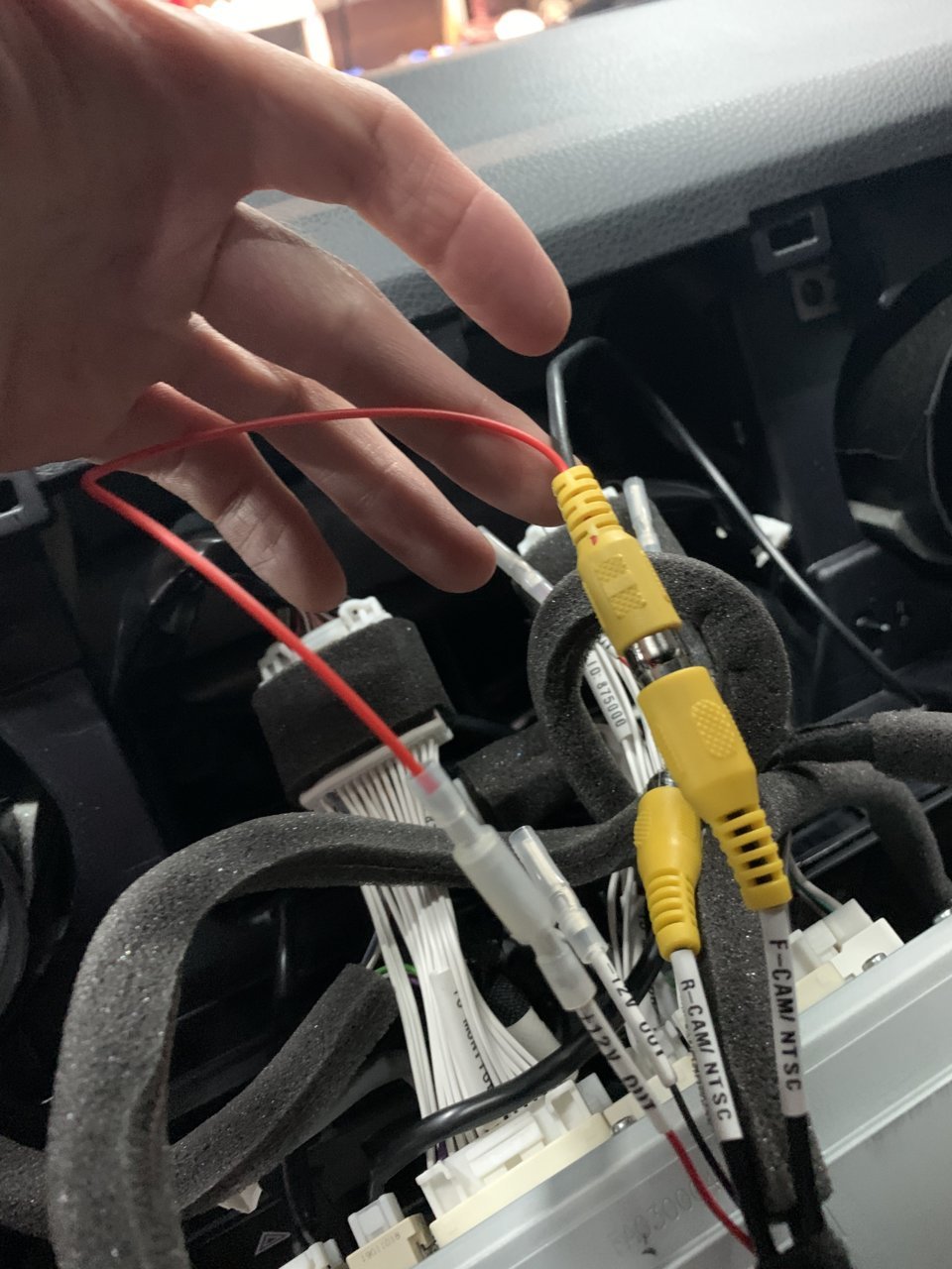

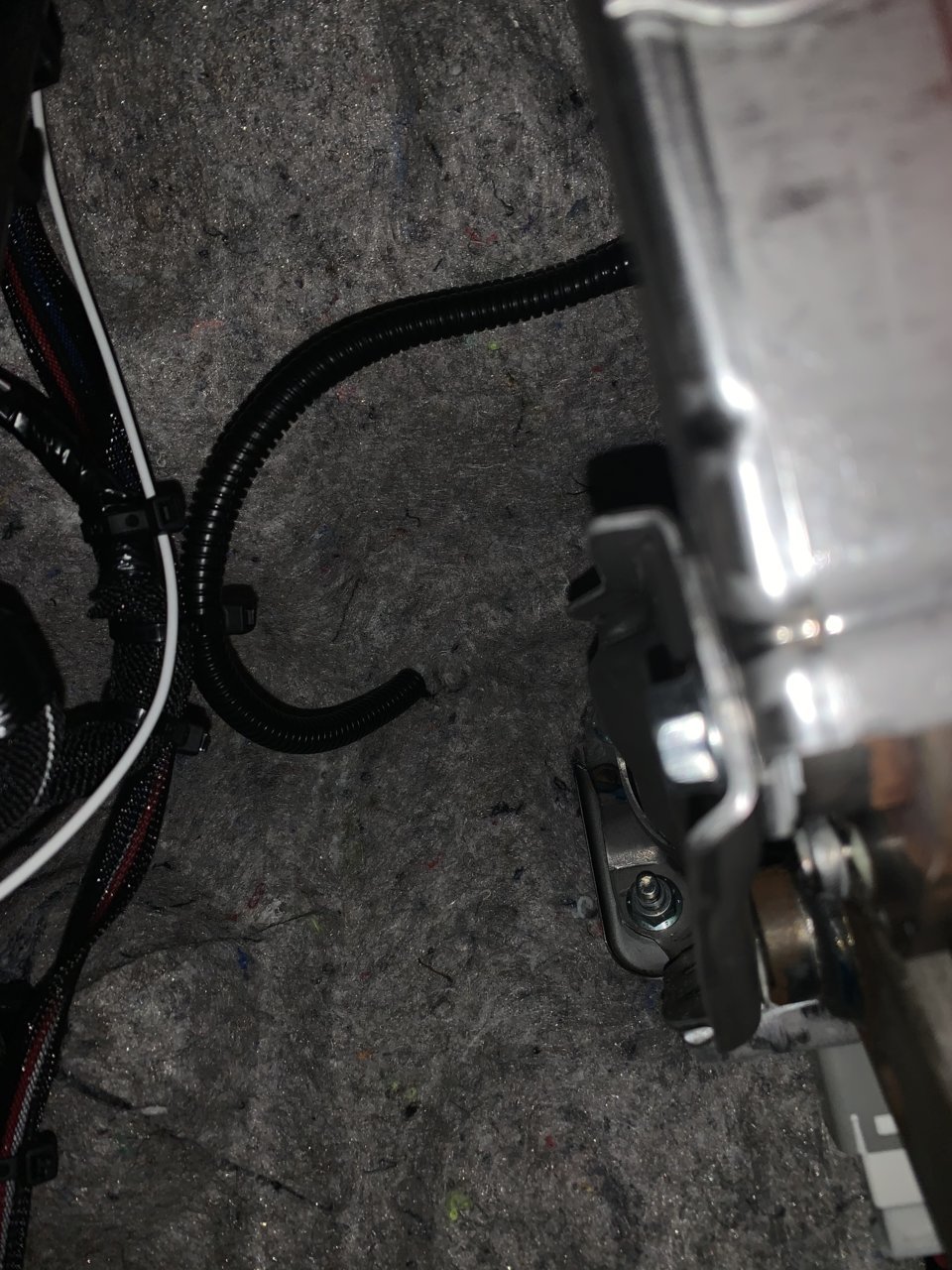

    This is the best I could do looking up under the steering wheel. This is where it first comes into the cab. To get it over the steering column, I secured the cable to the wiring on the driver-side wall, by all of the OEM harnesses and fuse box. Here, you can see it connected to my trailer brake controller, which secured to the same wires.
    I tired to set everything up where I could unplug the camera and remove the grille without having to cut zip ties. Ultimately, I’ll have to cut 2 ties to take off the grille.
    Let me know if you have any questions!
