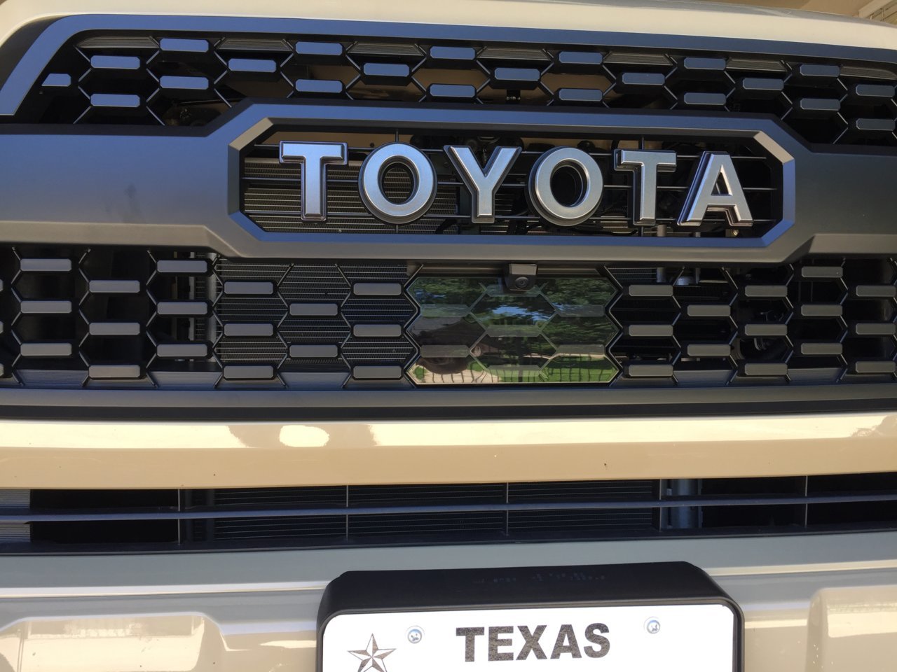

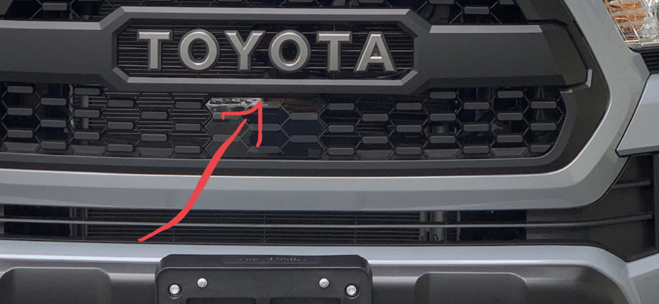

    I know the front camera thing has already been talked about on here. But has anyone out there done a front camera install and have a front collision radar on their grill? It looks like it’s the only spot to put one but I’m not sure if the front radar will be affected if the camera is near or within view of it.3C8ACA68-D93C-483A-8DC2-B9A258CE8FC6.jpg
    Install here

    No problem at all

    I like that install! That was what I wanted to do but worried about interfering with the radar. Any issues?

    No issues with the radar. Be sure and get the Amazon Yimu camera, it was the only one I could find in that form factor which could be programmed for front facing. Many say they can, but only flip the image upside down.
    HD Car Rear/Side/Front View Camera YM-606, YIMU 170° Viewing Angle Auto Reverse Parking Vehicle Backup Camera Waterproof with 4 Infrared LEDs Night Vision & One Button Control System https://www.amazon.com/dp/B072KQG664/ref=cm_sw_r_cp_tai_.56ZBbQ06ASEF
