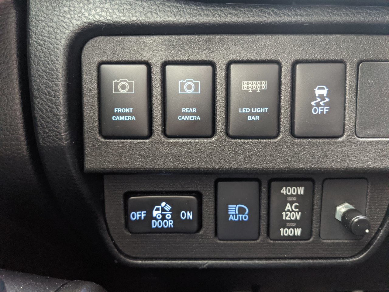

    I have had good luck with them, I recently wanted to add buttons for each camera individually and I emailed and asked about wiring and they replied right away with how to wire it.

    are you talking about adding separate buttons for the reverse and front facing cameras? if so, can you post the reply you got from them on how to do that? thanks...

    Heres the reply I got about the switches, I'm using Air On Board switches, they just match so much better than the ch4x4 ones so that what the directions are for
    "On my harness the red is a 12v supply so should go to the reds on the AOB switches. You will then connect the green to green for the front switch and orange to green for the rear switch. In this configuration you will need to press the rear switch to see rear and rear AND front to see front. TO make it so you press rear for rear and front for front you will need to connect the two green wires with a diode. Gray line on the diode should be on the rear switch side"
    markram[QUOTED] likes this.

    thanks for the feedback! your setup looks good, i will look into those AOB switches...
