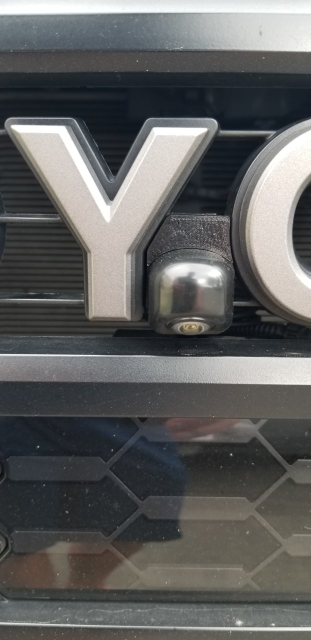

    I designed and 3d printed a bracket very similar to yours...

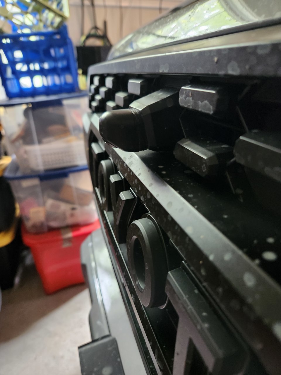

    I think I’m good now. I took and old license plate and cut some shims for that so I can tighten it down with the provided nut. I’ll show some pictures later. I’m proud of my hack.

    Everything is installed and working as expected. It definitely will come in handy. In the picture, the black item is 1 of 3 wedge shims provided with the camera. I used all between the camera and outside of the grille. The other is 1 of 2 shims I cut from an old license plate and put in the camera hole of the grille so I could tighten the camera to the grille with the provided nut. Seems to work but will get a good road test tomorrow.

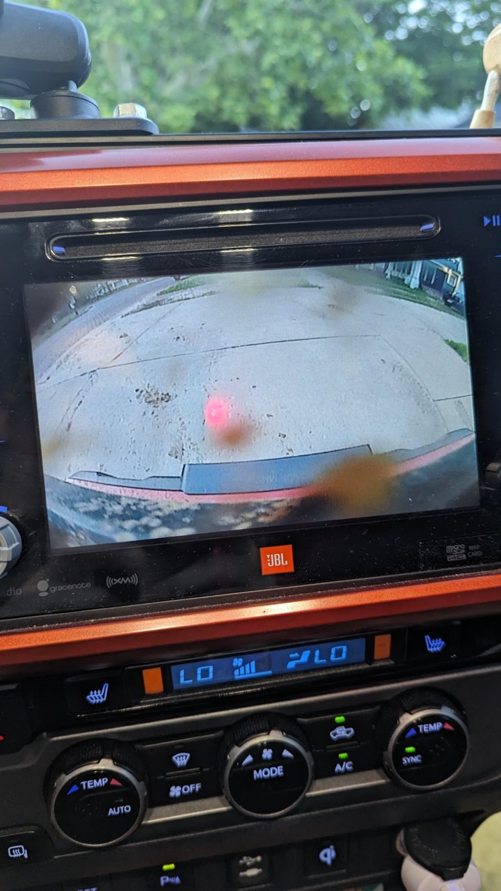

    I did an unscientific experiment to see what additional visibility the camera gave me. I laid out a tape measure that started at the tip of where my license plate holder ended, laying forward. I'm a little over 6' tall, my '21 Sport has the scooped hood, TRD Pro grille with camera slot and TRD lift. Sitting in the driver's seat, the truck stationary, my blind spot is from 0' to 20'. I turned the front camera on, and it displayed from 0' to 13'. I'm sure that's fine for the primary purpose, but the engineer in me wants to see the extra 7'. I bought my camera from TrailGrid Pro and used all 3 provided shims. Here's a picture of the camera setup:

    I really like that. I don't have the printing skills to design that, yet anyways.
