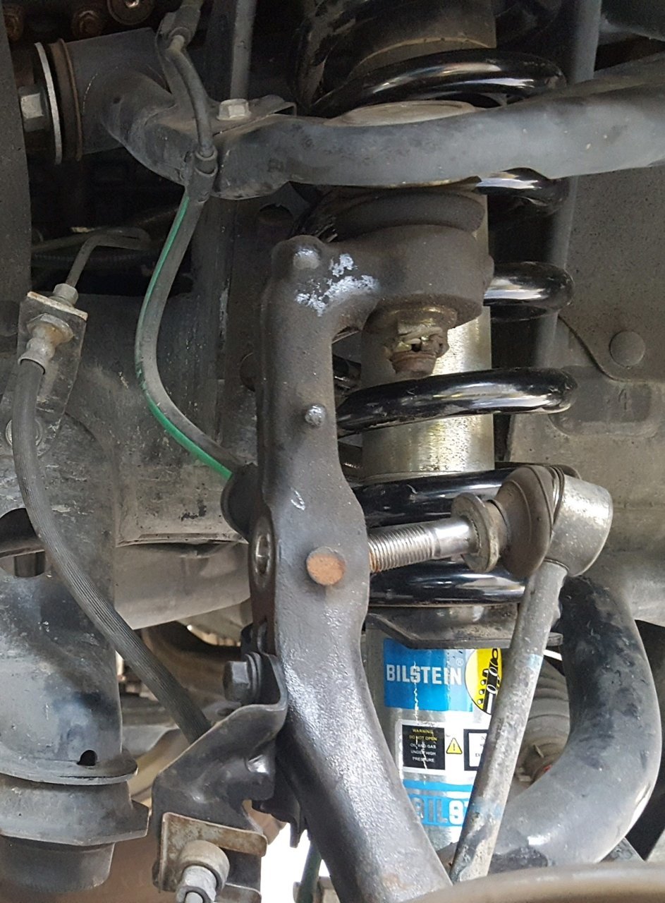

    I'm sorry to hear this crap about the OME springs. I bought a front set a while back and just installed them yesterday. They are only 50# 40# heavier than stock.
    I had 5100's on the truck and I put the clip at lowest position as I'm not trying to lift the truck. This may have been a mistake as the 5100s seem very weak now.

    Is it considered kosher to just lift the clip on the left shock only, to aid alignment/ride height?
    The OME springs were one coil taller than the stock springs and they went right in. But they didn't appear any thicker than the springs I had.
    I just used the truck to compress them. Easy peasy. But . . .
    I was just about to bolt the anti-sway bar link back in, when OOPS! Can you see my error?
    I didn't index the spring & seat! I had to let it down and re-seat it.
