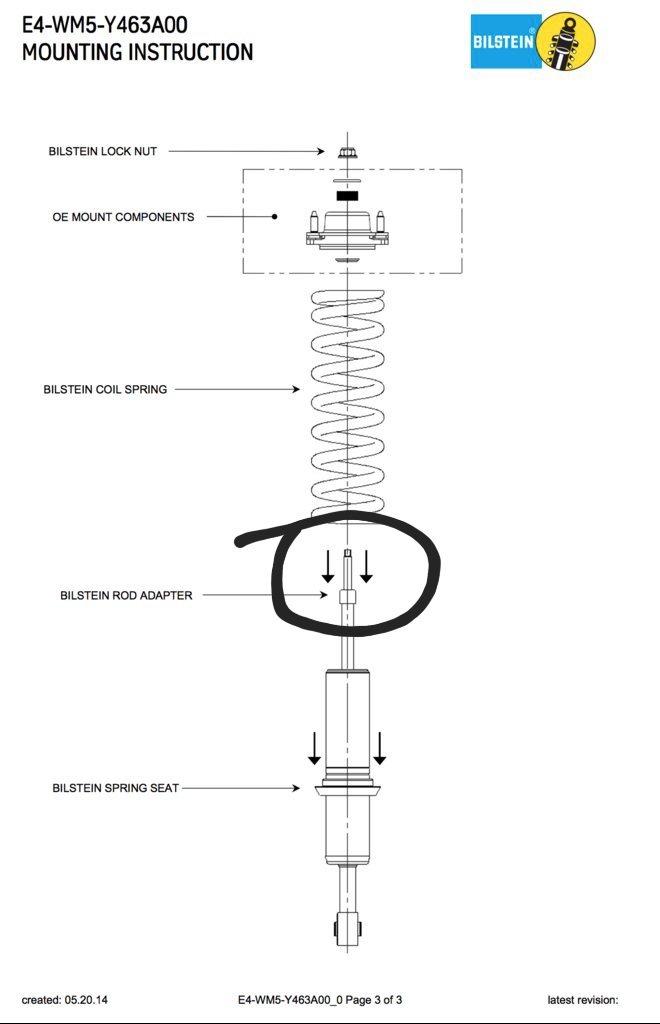

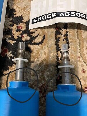

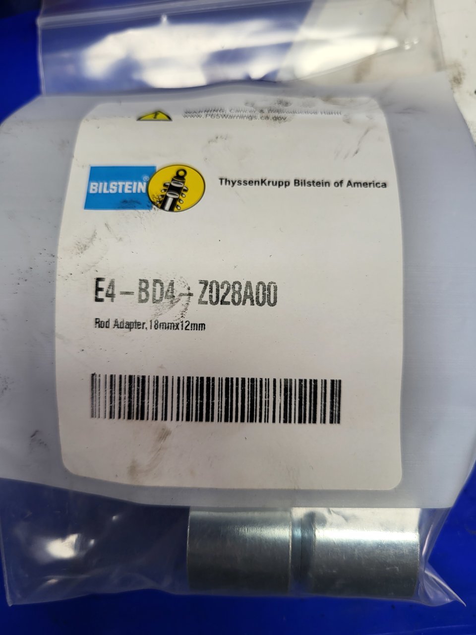

    Not sure if this applies to 4600, but on 5100 and 6112 bilstein there is a spacer that some people miss. Sometimes this spacer is part of the dust cover (blue part of the 4600).
    Bilstein calls it a rod adapter.
    Rod adapter shown in pictures below.
    Screen Shot 2017-05-11 at 10.45._5a90d58b3be2817180f21d3aad3e114fb47cdbaa.jpg 20221223_100905.jpg

    Looks like 4600 does have a spacer that sits in the dust boot. If that's missing, you will have this issue.
    You will need to disassemble the coilover to inspect what is missing. Maybe upload some photos once it's taken apart.
