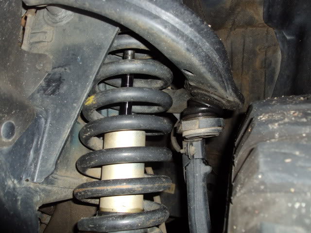

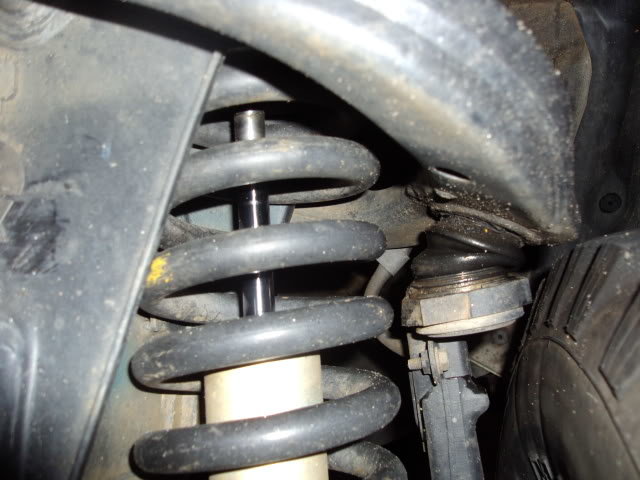

    Yes, the spring perch is installed correctly haha and yeah I can see how easy it is to install it wrong lol. during the installation while I had the whole assembly at full droop the Balljoint on the UCA got stuck in the spring on both sides and I had to use a pry bar to pry them back out. Once I put the tires back on and let it off the lift I had like an inch of clearance between the balljoint and the spring. If that helps any

    My setup did the same thing. i had too much lift so i took out my top plate spacer and it fixed everything. but i have a 2nd gen

    yep, my truck did exactly the same thing. uca's cured my problem

    I did some searching.... so UCA's help to add more clearance between the spring and the balljoint?

    yea pretty much. they even give you a little more travel since the uca isnt getting caught up in the coils

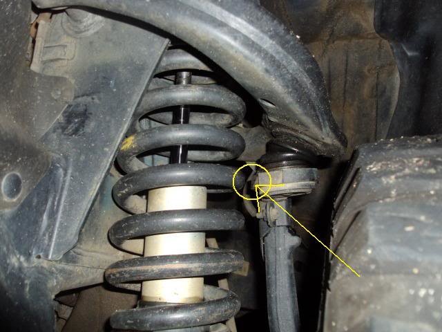

    Just checked my stock coils w/5100's & at full droop (front wheels slightly off ground but still making contact) & I can see where it might be a problem....

    Right where I rub or just about where

    Yeah that would explain the slight rubbing seeing how the Eibachs (or EMU's for that matter) are longer than stock allowing max droop I reckon,, I take theres no sway bar also...

    My sway bar is still on there but it doesn't rub thankfully lol. I didn't think that it would rub when I got this set up but apparently I was unlucky enough for it to happy enough. There are other members that I've talked to on here with this same setup and they've had no problems

    Doug: Do you think that I'd just have to break them in? I've only had them installed for like two weeks and haven't done anything but on road driving and haven't had an alignment yet either
