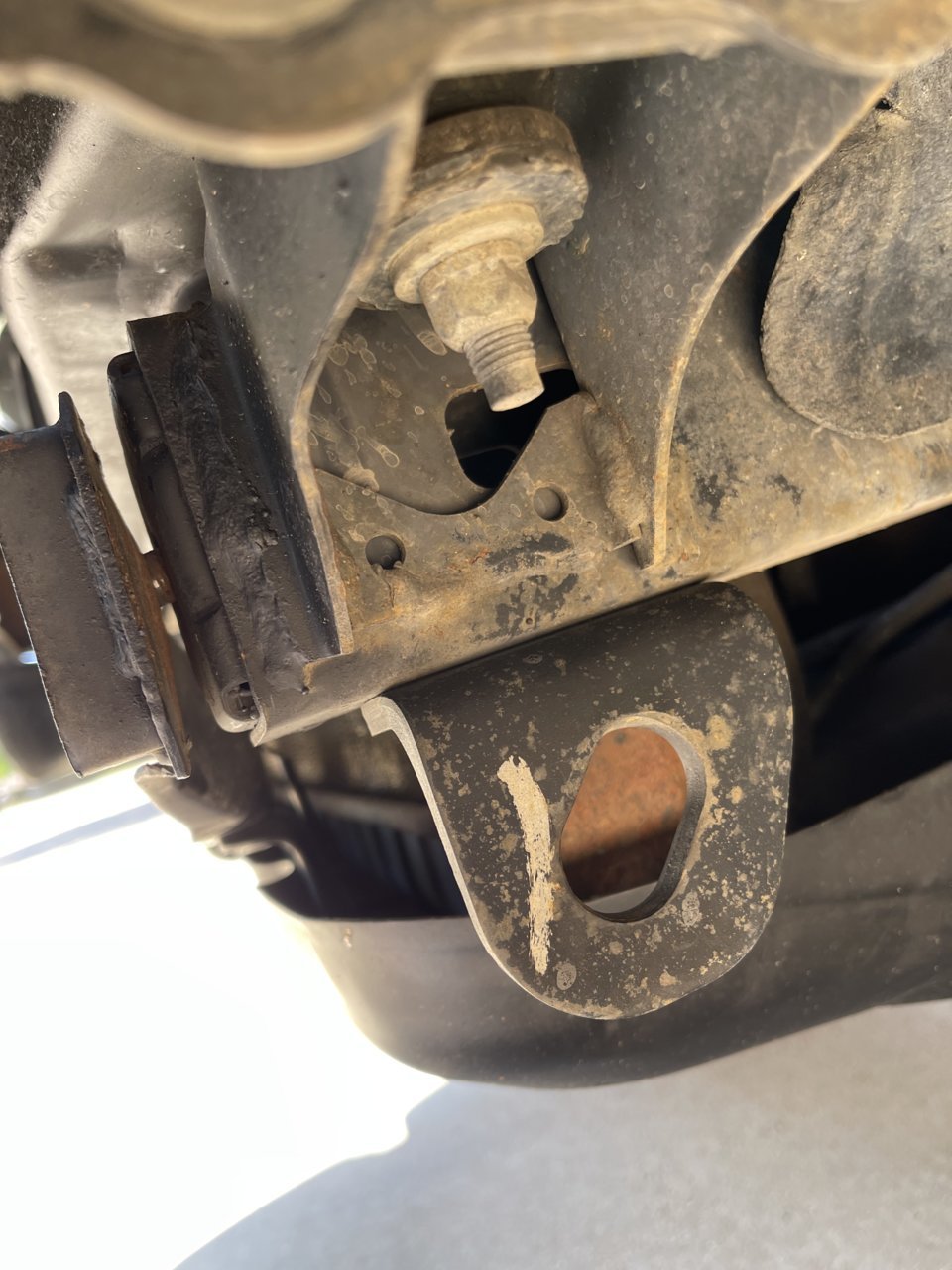

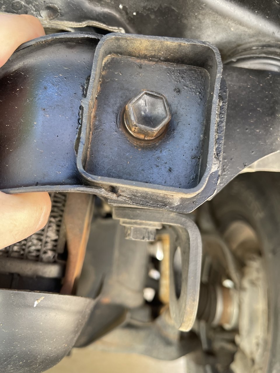

    Stole the pic off here but have a situation where the nut on the backside (assuming) broke the weld and the bolt spins without tightening or loosening.
    any ideas on how to get access to the nut without major damage?

    Could you just drill a hole on the right side (from wheel well side) to get a wrench in there?

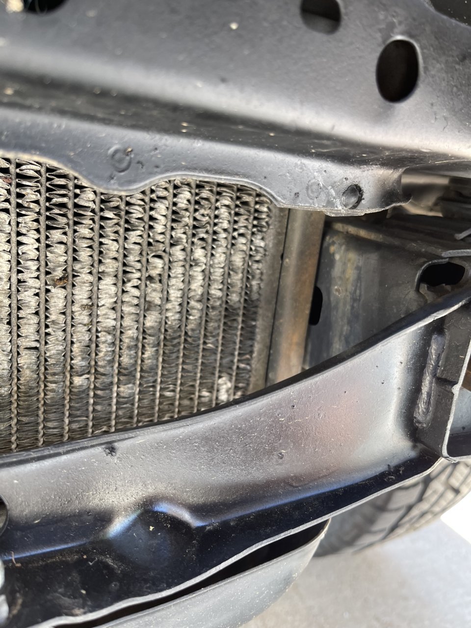

    You made me curious, I went out and looked at my '03. Look close to the left of the radiator, that slot on the inside of the frame? It's about 1"-1/2" long, I'd wonder if I could fit something in there to hold it from the back . . . . . but it looks like you'd have to take the radiator out to do it. Might have to open the hole up a little. Then (without welding equipment) figure out a way to lock it when I put it back in. Then I'd probably start net searching or pricing out welding equipment because there's gotta be a better way LOL

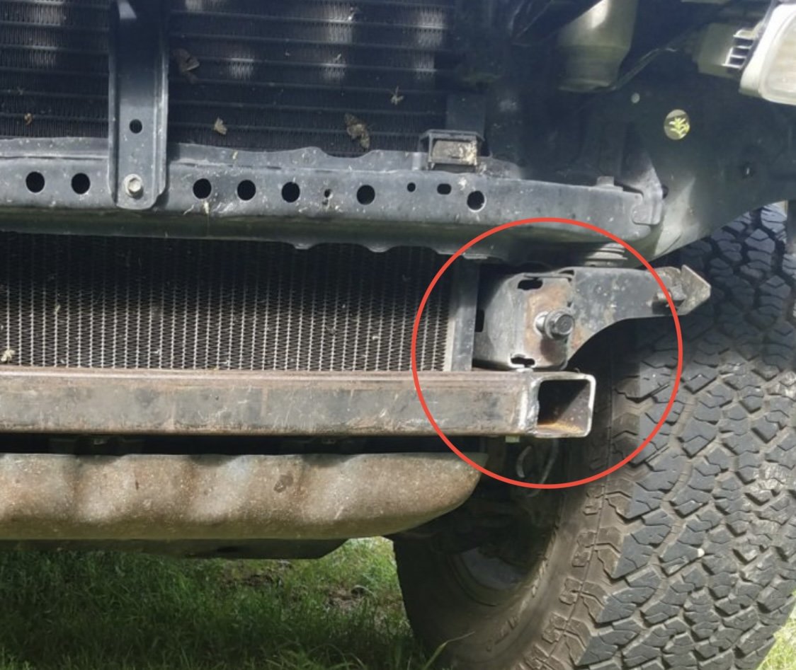

    This is the problem when you use random pictures..:anonymous::annoyed:
    Does OP`s truck also have that piece of square tube?? Is the picture even of the same year?
    I have a different bumper mounting bracket did it change after 2002?

    I’ll get a pic today; been dealing with getting it back and doing a once over on everything. It’s an 04 and no square tubing on mine. I remember it being broke back when I had it and just remembered it the other night and tried to find pic online vs taking one

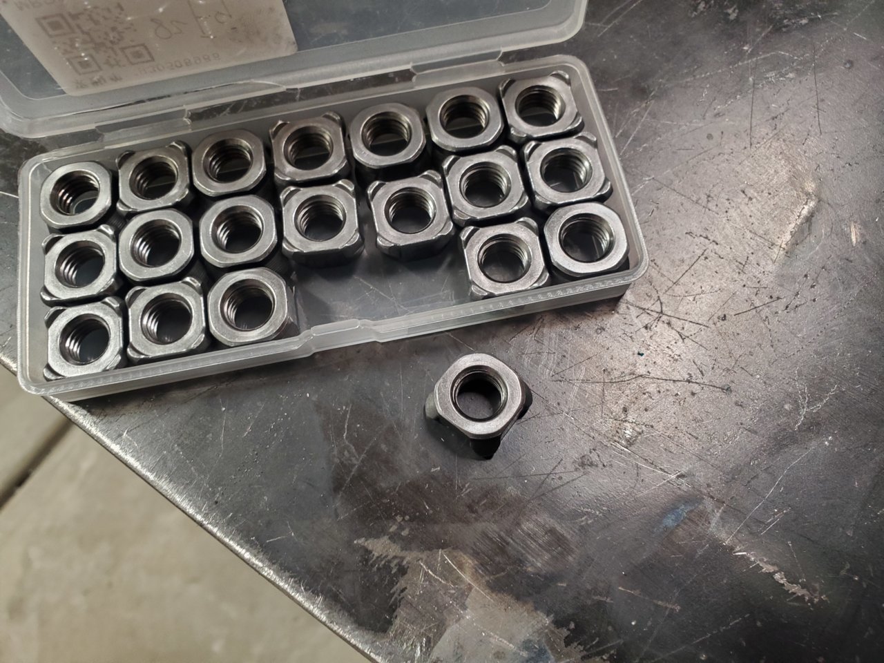

    Have you never heard of or used weld nuts made just for this type of application?
    Has much more area to weld then a regular size hex nut allowing you to control the heat better.

    I own plenty for this reason alone.
    More expensive than regular hardware, but that's why I only use it when needed.

    cut hole slide open end wrench in and get it done. It's just the bumper not a motor mount or anything.

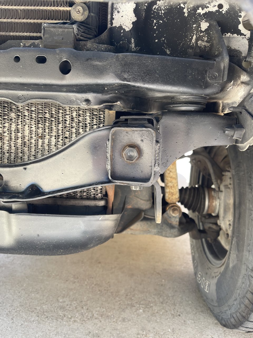

    jamb a pickle folk or something in between the 2 and see if friction helps ya.
    cut bolt tap hole get bigger bolt
    use hole in pic 3 to J-B weld the nut back on
    cut larger hole in pic 3 or 4 and get a bent open end wrench
    just some ideas

    You could just cut off the head of the bolt.
    That bar that runs across the front there is removable once the bolt on each side come off.
    Bivouac likes this.
