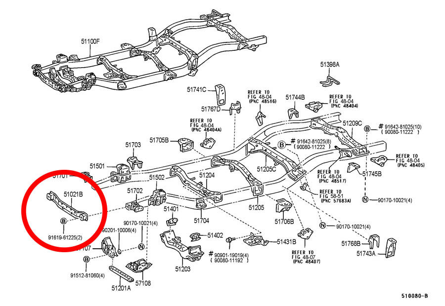

    A little backstory... the previous owner of my truck swapped out a tube bumper and put a stock bumper back on the front. There was no front skid plate when I bought it, but I pretty quickly purchased one of those nice stainless steel skids that 22rethan sells on here. When I went to bolt it on, there was nothing to bolt to in the front! The cross member is gone. My guess is that the old tube bumper bolted in to the frame horns and filled that space.
    I thought I would easily find a used one, but that hasn't been the case.
    Where I need advice -
    I'm wondering if I should buy a new OEM part?
    Or.
    Should I try to have one fabricated?
    Picture attached for reference.
    Thanks for the help!

    I think I skipped over that because my truck is a 97 and yours is an 01. Is that part the same on those years? I think the 98-00 are different IIRC.

    The part numbers are different from those years mine is 51021-25030. The 01 is 51021-35060.

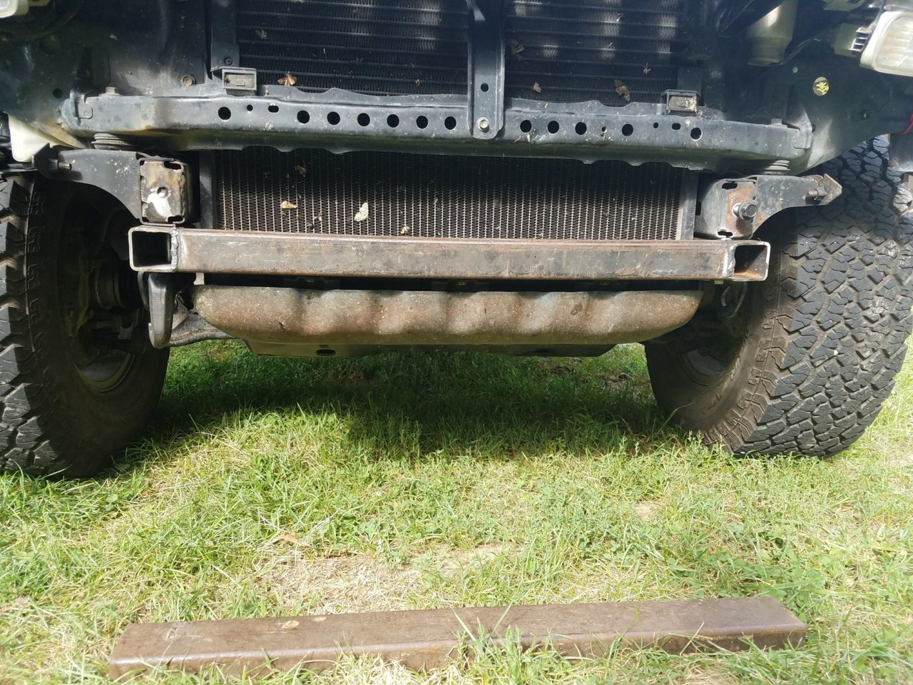

    If you got a welder and a grinder, it's not to hard to fab one up. Just some 2" square tube.
    This eventually became my tube bumper but that would be all you need.

    Seems pretty straight forward. I could proably track down a welder to use.
    Did you just tap holes for the skid plate attachment?
    And you attached it to the frame at the tow hook bolt holes? Did you through bolt it with the hooks?

    Went to tractor supply and bought longer bolts that match the same tread ptich and diameter and are longer by the same width of the tube you use. Also got 3/8 self taping bolts to mount the skid plate with. Super simple
