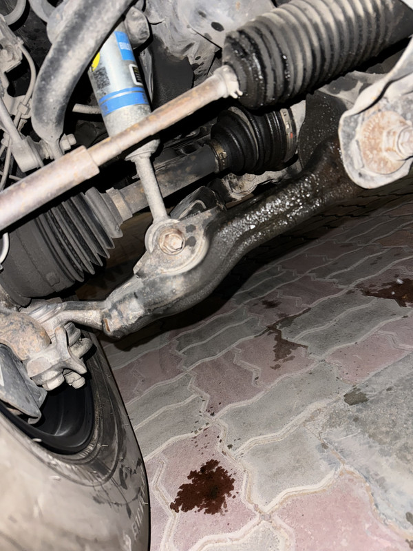

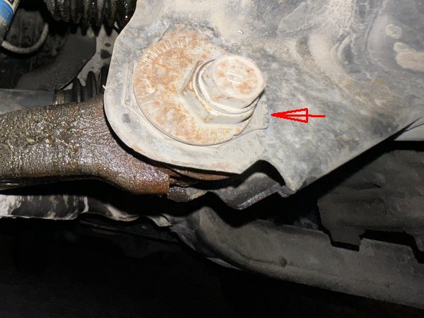

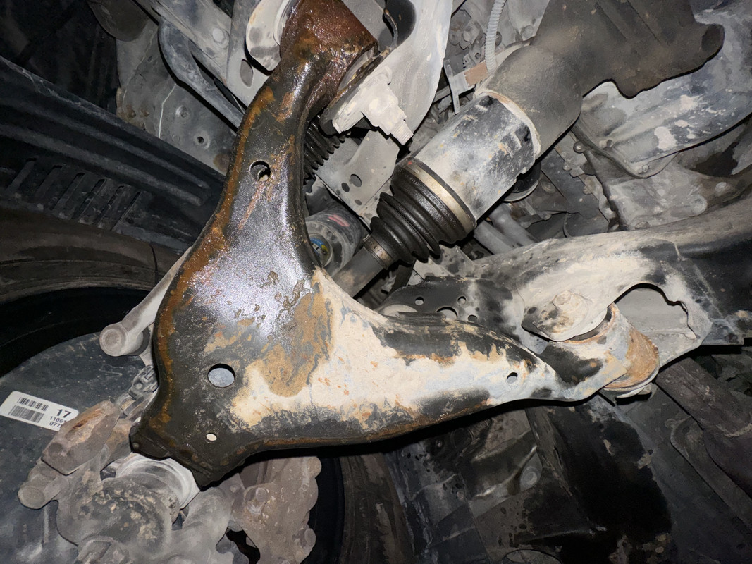

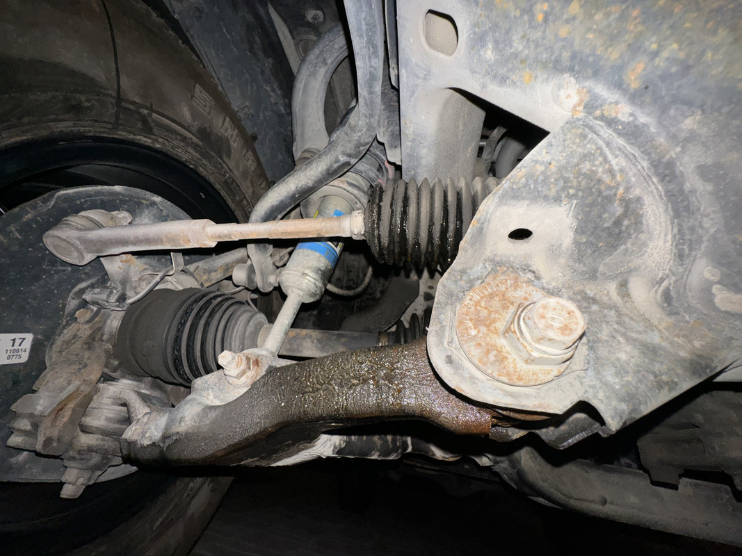

    [​IMG] [​IMG] [​IMG] I just noticed the front cv axle is leaking oil (passenger side) from where the oil is leaking and what would be the cause of that

    Pretty obvious the steering rack is leaking and it’s just spraying back on the CV
    time for a new rack, keep,the fluid topped up until it’s replaced

    Thank u yea I noticed that bend
    There is no rebuild kit for the rack?

    No. Mine was found leaking during suspension work at my trusted shop. I asked the same, or is there a core exchange for a new one, and they said nope, they aren't rebuilt anymore. Labor not worth it. They got bme a good deal on an OEM rack from the local dealership they do a lot of pats business with.

    There is a seal kit P/N in the catalog, not sure about availability. There are also reman racks offered by 4-5 companies. They all end up leaking after a year or so.
    The leaks are caused by rust jacking on rack output shaft surface wearing on the seal. I guess it's difficult to polish the output shaft to the correct surface finish.

    I could be wrong but it sure looks like the boots are soaked thru. It may be leaking at the lines as well but the wet area is the rack.
    Keep it topped off and find another sooner than later.
