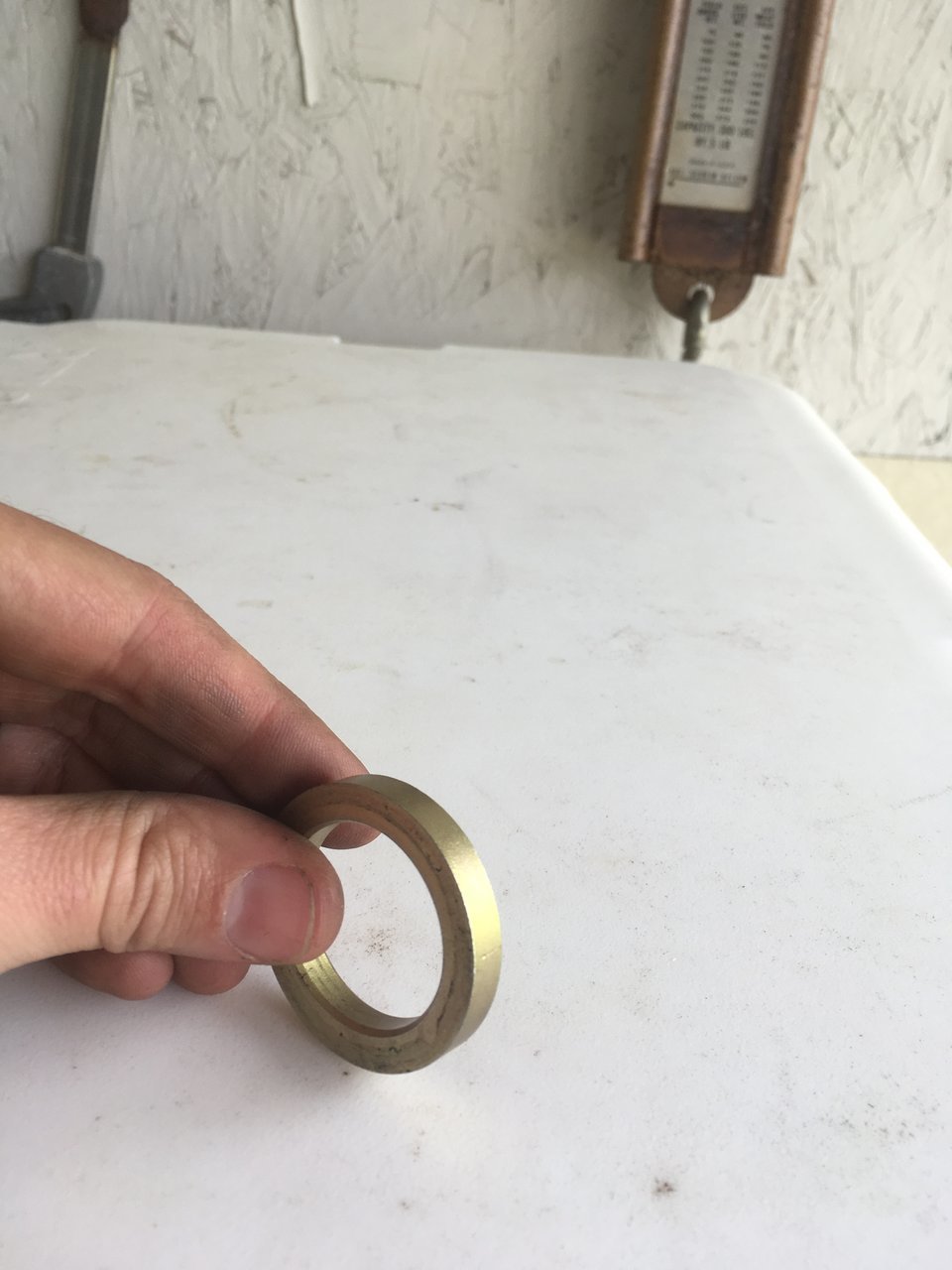

    Here is the spacer.

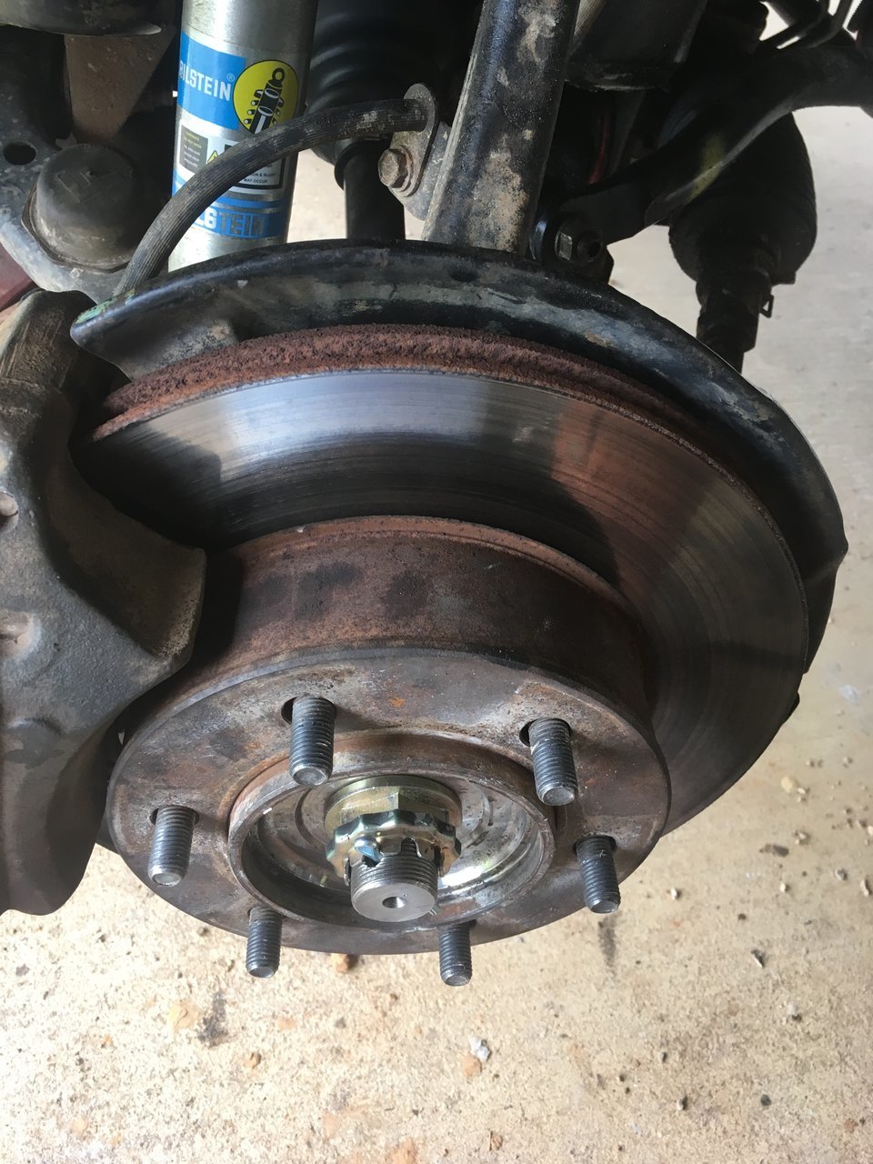

  5. Mar 16, 2018 at 11:15 AM
    01GreenTacoma
    01GreenTacoma [OP] Well-Known Member
    Jan 9, 2017
    #207086
    849
    Without the spacer it’s perfect. I dunno what it was for...

    When I bought my truck used it had an aftermarket front CV without a spacer. The cotter pin hole was so far from the spindle nut that the spindle nut retainer was not engaging the cotter pin. I'm thinking this spacer offsets the spindle nut enough to have the cotter pin engage the retainer if this is an issue.

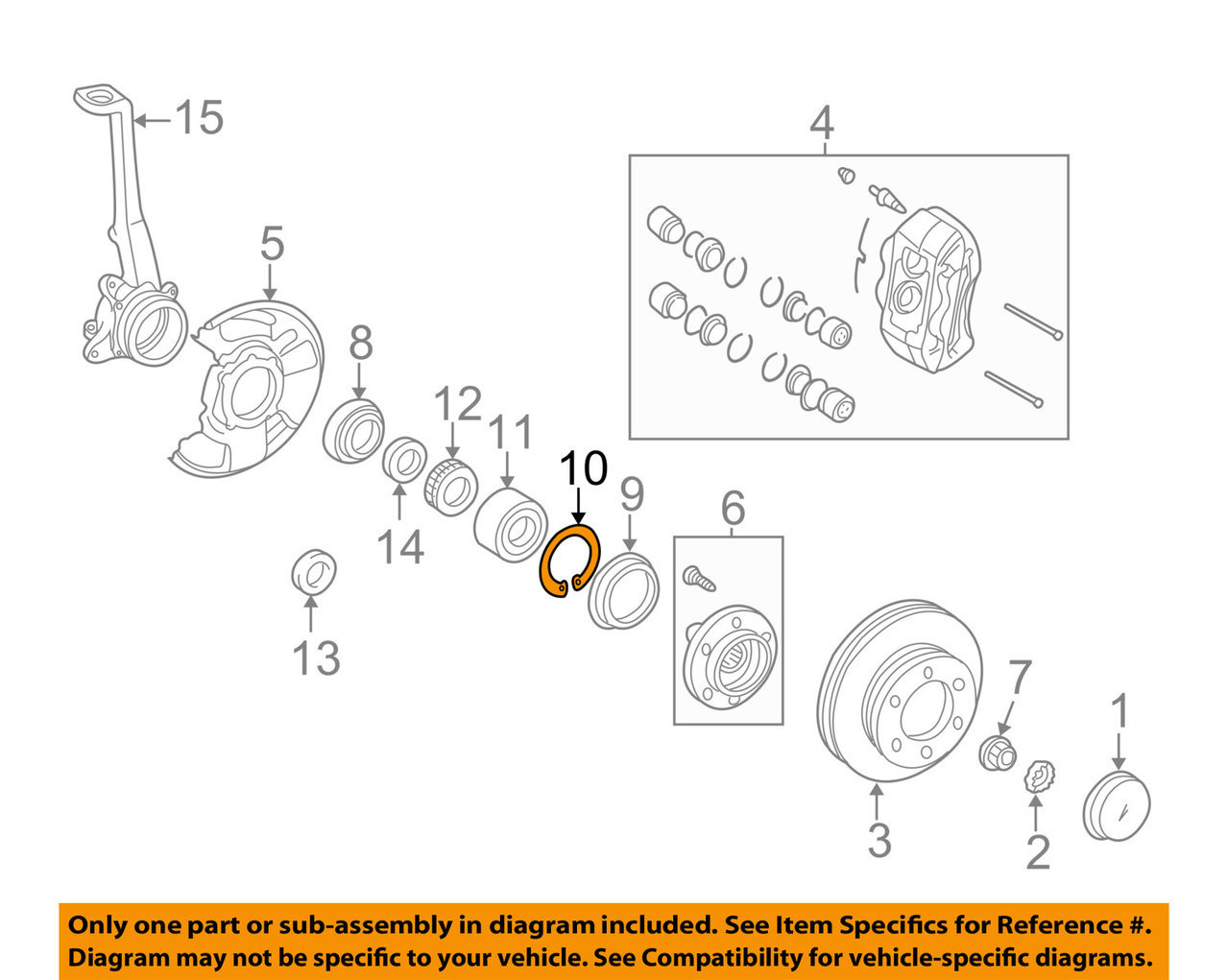

    It's inside the outer bearing seal. (inside side, if that makes sense) if I'm remembering correctly.
    Anyway...a seal holds it in.
    Actually I think there is a spacer AND an ABS delete ring or an ABS ring if equipped.
    I'd have to refer back to the parts diagram. I've taken apart too many different makes since mine to remember exactly what was in there but do know the ring is needed if removed.
    I don't think it's a wear item. Don't see how anyway.

    #13, 14 and/or 12 is ABS ring.
    So you either have 13 and 14 or 12 and 14 in there.
