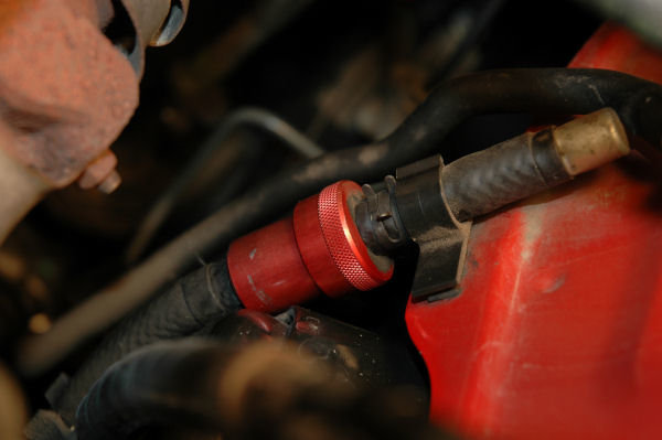

    My front diff breather started leaking after installing ECGS 4.56 ring and pinion and recommended Lucas 85/140 gear oil. I assumed the gear oil is thicker so the oil that crept up the breather hose towards the breather had a harder time draining back into the differential. So, the oil trapped in the breather line was pushed out of the breather on the next heat cycle of the diff as the air expanded. I ended up purchasing a fuel filter with removable filter element (removed filter) and installed it a few inches inline below the breather. Oil now has "tank" to settle which allows the air to escape without taking oil with it. The system has worked perfectly!

    I have the same gears, ARB lockers and also the recommended Lucas oil gear oil
    Going to install that fuel filter/oil trap

    Do you know what fuel filter you went with? Not sure what size will fit the breather hose.
