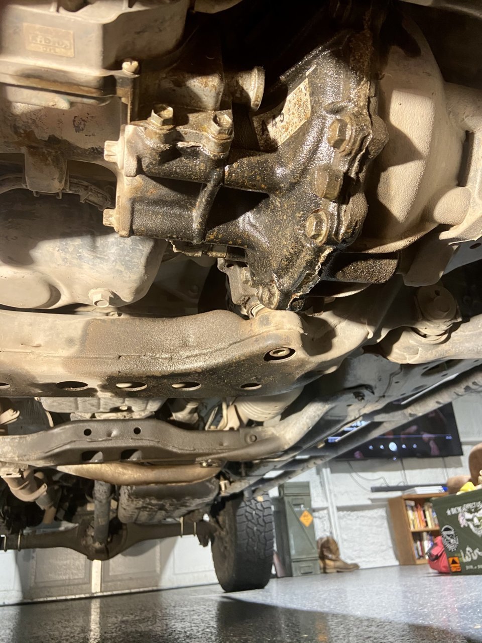

    So a while back I noticed a burning oil smell after getting out of my truck one day, not strong but definitely there. This happened to be right after I got my first oil change from someone other than Toyota...should’ve done my own blah blah blah; not important for this thread. Anyway, I did some looking and found oil on the underside of the skid plate. Check the motor oil level, everything looks good; so I chalk it up to the techs spilling oil on the skid plate and leave it at that. Everything drove and sounded fine so I didn’t investigate further.

    On the way home I caught the burning smell once again and finally found evidence at the back of the skid plate of an oil leak.
    I got home without issue and started thoroughly looking and finally found the culprit.

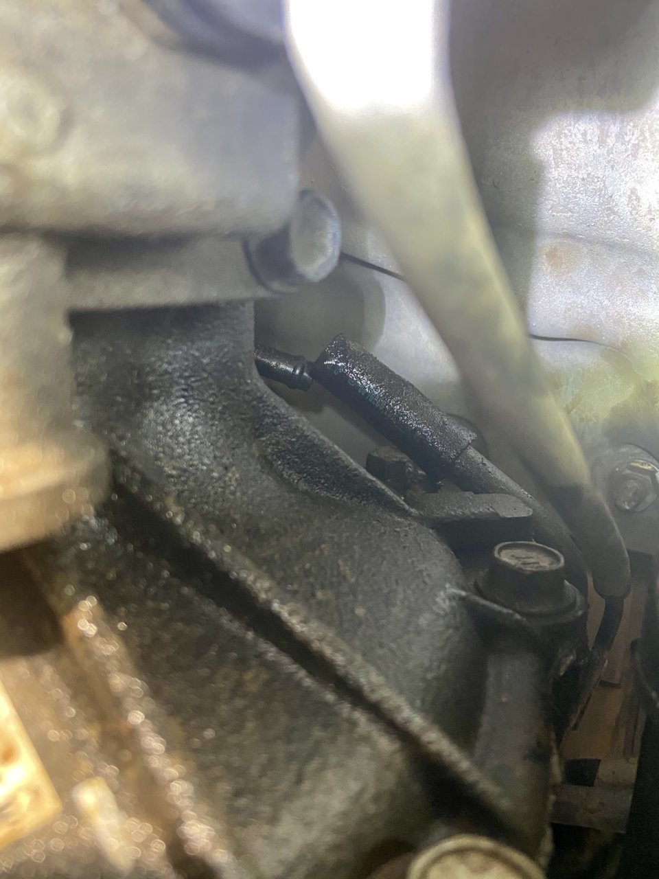

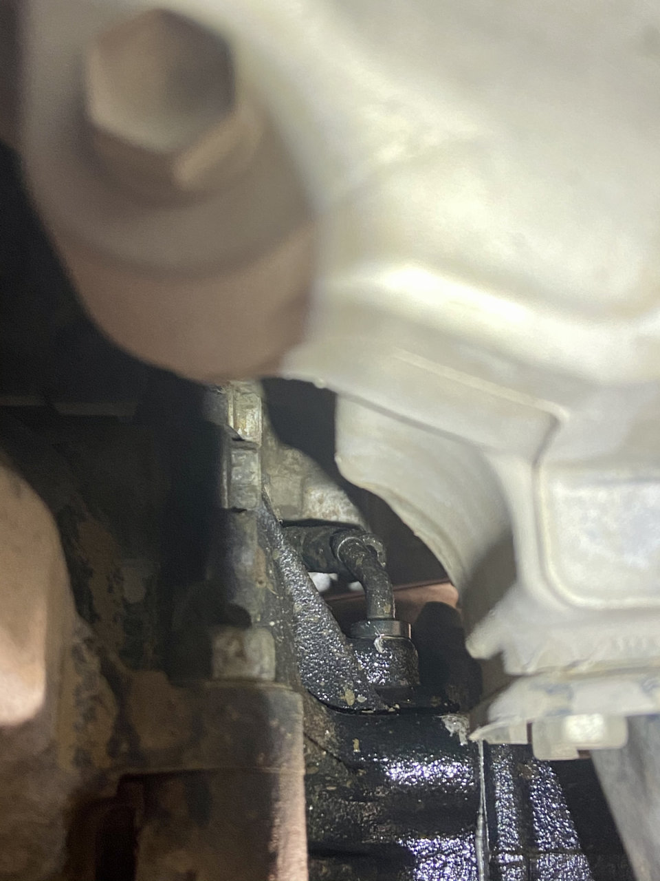

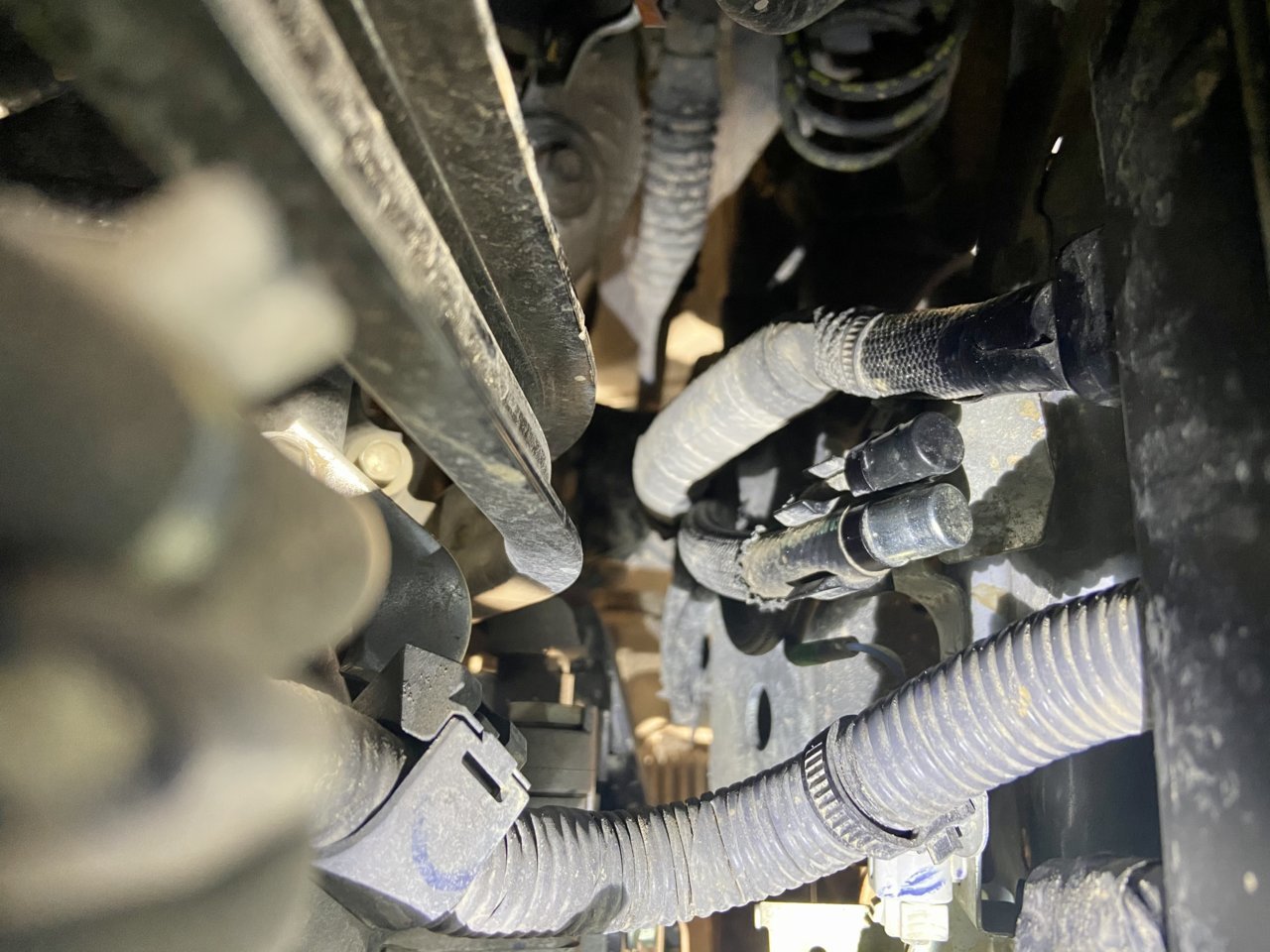

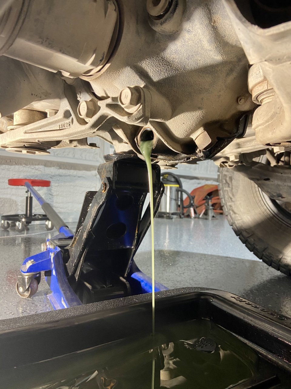

    My front diff breather hose had become disconnected at the lower coupling and had slowly been puking diff oil out. I drained the diff and found a geeenish/milky white oil in great quantity (I definitely had not lost a significant amount of oil). I managed to squeeze my left hand and a super long flat head up in there and re-seated the coupling over the breather.
    I then drained and flushed the diff with a full quart of new oil. The old oil that came out, 80W-140 from Nitro, has a green appearance. Based on the milky white color I either had water emulsified from the numerous crossings or perhaps packing grease from when I upgraded to 5.29s? Either way I flushed it til it ran clear and refilled it. Got everything closed up and took it for a test drive, I could not recreate the whine and the truck showed no signs of anything amiss. I ran 4hi, 4lo, the locker, and gear locked it in 2nd and 3rd and everything worked and sounded solid.
    I also checked the breather extensions in the engine bay thinking that maybe the valve got stuck and the oil found a path of least resistance and caused the coupling to separate. They looked good to go.
    If y’all have any ideas as to what caused the coupling to slide off the breather hose please let me know, but apparently it had been that way a while.

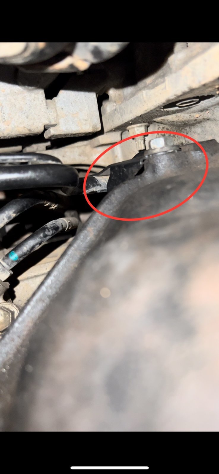

    I’m currently dealing with this issue. And I have a 2017 Tacoma. Can this issue be solved without needing to lower the differential. For instance, would I be able to loosen the bracket to the diff and resleeve the fitting? also, other folks were saying that I needed to put a hose clamp on this, which seems IMPOSSIBLE…

    Contrary to what that other dude said in your thread I don’t believe that hose has a clamp on it. If it did it wouldn’t have come off and even if it did pop off you’d see clamp marks on the hose or the clamp would still be on the hose.
    You certainly can add a clamp but you if just want to try and get some long nose pliers or a up in there to just get it reseated then just do that.
    TRD_0ffRd2017[QUOTED] likes this.

    They make a “snake” hose clamp tool for these hard to reach areas. I’m not saying you need a hose clamp or don’t but it would be insurance it not coming off again if you could manage to get one up there. Idk how you’d get your hand up there bc i haven’t had a chance to look but those tools are very handy for jobs such as these. I bought one off Amazon for like $30 and it’s nice
    Also your seal seemed to have been seated good to me as I did mine this summer after replacing cv and having a leak. I had to do it twice myself

    Yeah I tried fitting a clamp on but to no avail.
    I’m considering loosening the bracket to the hose and seeing if that gives me the play to be able to reconnect and then tighten it down
