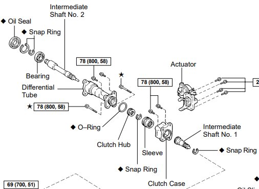

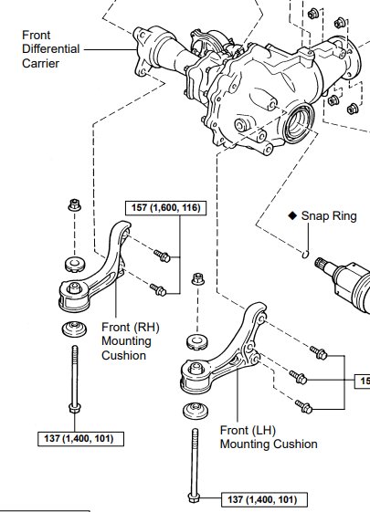

    Maybe some diagrams will be helpful:
    I believe that the differential housing is the same, as are the two forward mounts.
    The Front Diff Carrier (passenger axle shaft (stub staff) + actuator) bolt to the diff clam shell.
    I don't know if the shaft or internal components are different from vac/add or not, but in theory you might be able to swap the entire Front Diff Carrier (stub shaft to the ne) clam.
    In short.. If you match the gear ratio, and the actuator type, you're probably fine.
    But it does beg the question- if you're able to swap the front diff internals out of your current front axle assembly... what happened to the clam shell and stub shaft, that they're no longer working?
