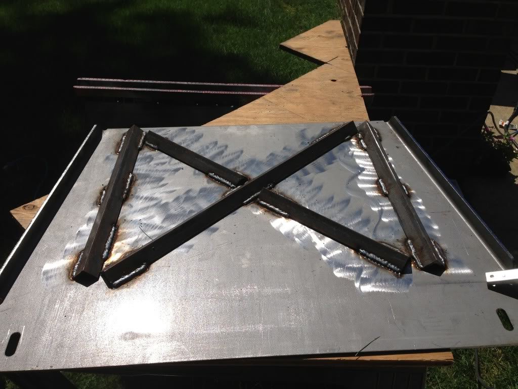

    Buy a steel skid plate and that will fix it. Aluminum skids are not meant for the rocks

    This is like a broken record, skid is designed poorly. Obviously just get a new design or modify yours to be better.
    Here's how I fixed my back ones from bending
  14. Sep 29, 2015 at 4:21 PM
