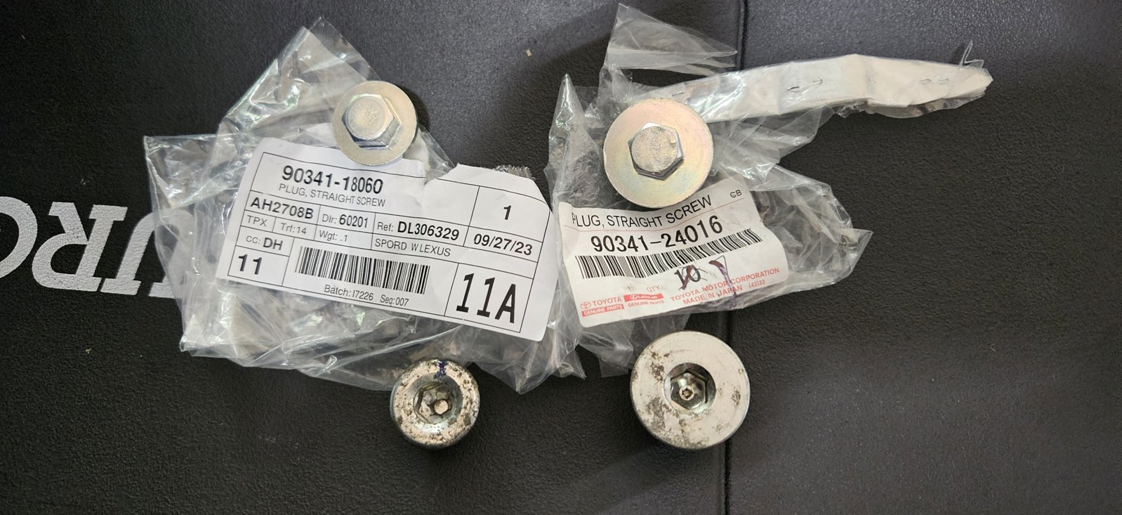

    I went ahead and preemptively got the Kaon adapter and 24MM plug kit, imported from Australia, since I was going to be buying a 10mm allen socket anyway. It would be my luck that I'd strip out the original plug and have to extract it anyway, so might as well just bit the bullet and not worry about it.
    Was about $50 US with shipping, which is probably a fair bit more than buying a good quality allen socket and the Lexus plug, but figured this way I get a 24MM drain plug to match everything else ( I bought the 24mm fill plug, too). Tool and plug in the kit seemed very high quality.

    Are the front and rear Lexus diff fill + drain plugs the same part numbers front and rear?

    yes, you used the same gasket.

    you only need front diff. Rear already has hex
    9034118060 (fill)
    9034124016 (drain)

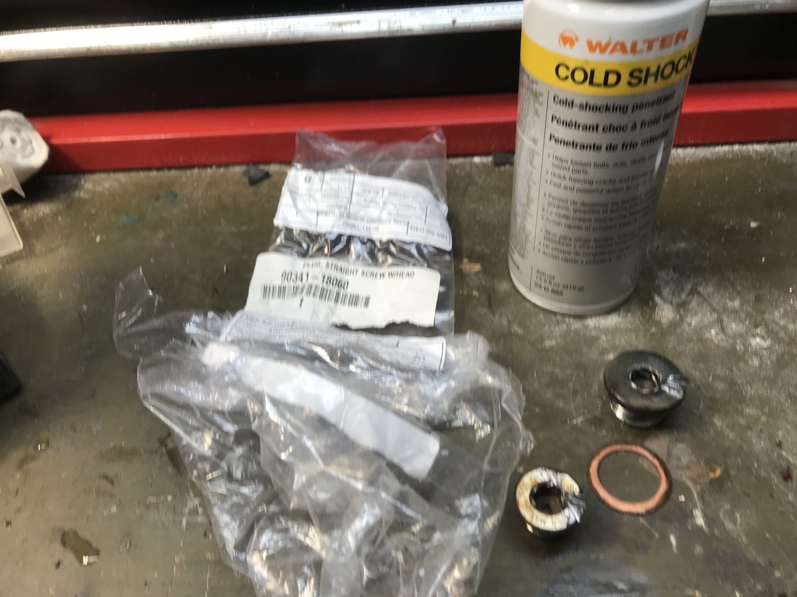

  12. Aug 11, 2024 at 7:55 AM
    #32
    Shamal
    Shamal Active Member
    Sep 8, 2014
    #137851
    27
    BC
    SR5 4X4
    2nd Gen 2008 Tacoma :
    My fronts were frozen solid , 1/2" Impact would not budge them.
    Soaked in WD 40 for couple of hours.
    Sprayed Walter Cold Shock , and used a chisel to knock them loose. They moved quite easy. 1st time using the stuff.
    Has the MAP torch out, but this was way easier. Replaced with the Lexus parts as above. Other places came out with no issues.
