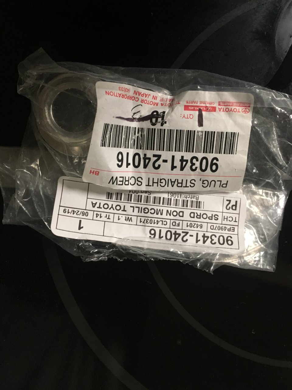

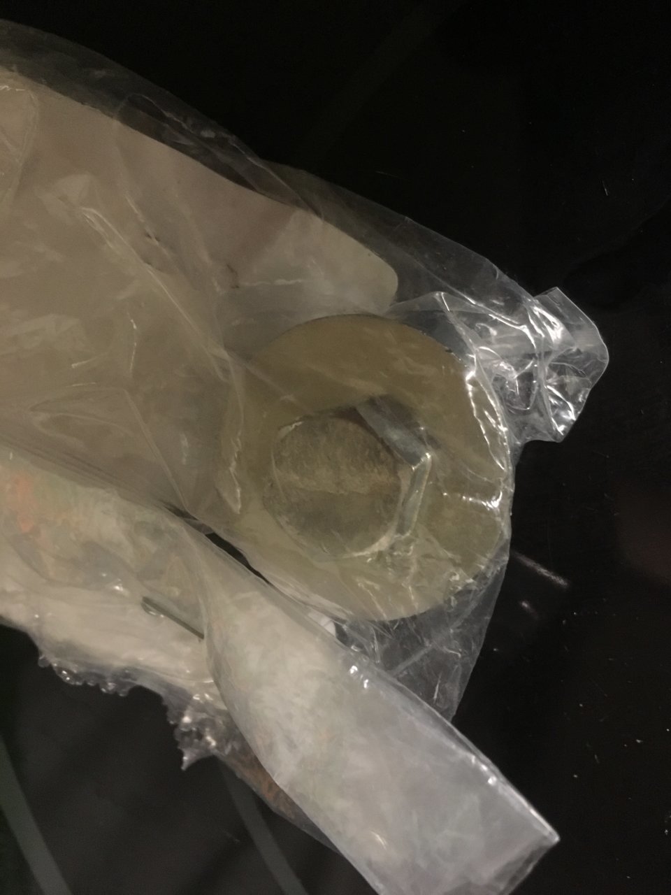

    I just picked one up, I’m so happy with this! Huge props to @Jowett
