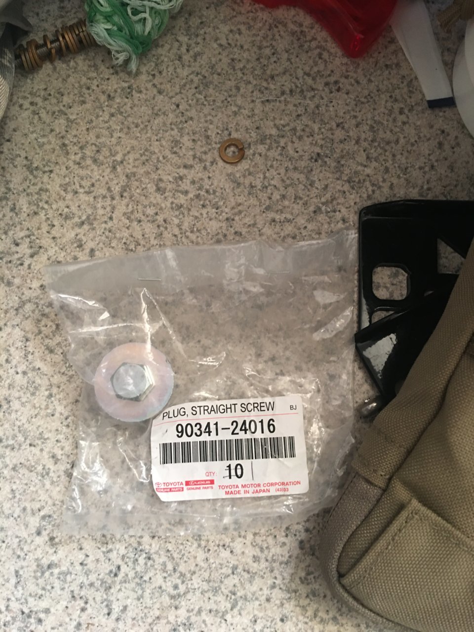

    This is crazy. The parts girl at the dealer tried punching up the number in the computer and she said it didn't come up as a real number. Oh well. I'll order one online. Thanks.

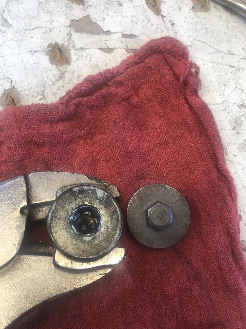

    I think you can find that same plug for a bunch of models. The drain plug in the gearbox of my 95 Corolla is the same 24mm head and thread size as all the drain plugs in my Tacoma. The one on the front diff is the only one I’ve found that uses that damn hex.

    #218232
    1,747
    Could only get mine in like a 1/8th turn if that cuz the head was so stripped. But the kaon tool works pissa. If any one is having a bitch of a time getting it out buy that kit.

    The tool will save your ass, if the thing stripped.

    oh, ok. the black one in the pictures is the tool. not sure how that's better than any other 10mm hex key or socket, but hey, go for it.

    It’s slightly larger and gets hammered into the stripped 10mm hex hole. I’ve never used one but others who have say they work. Sure are pricey though

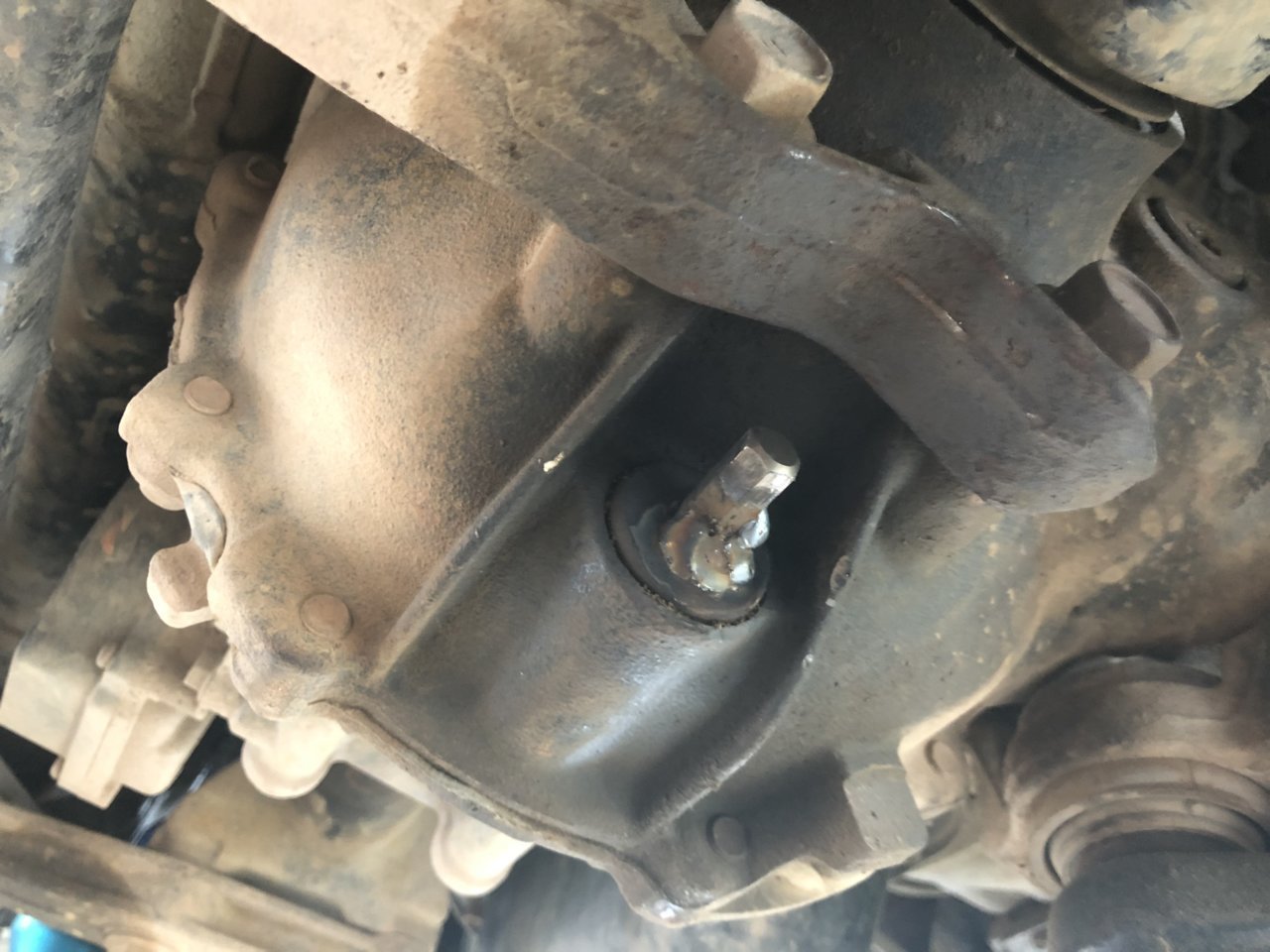

    I was able to remove this.
