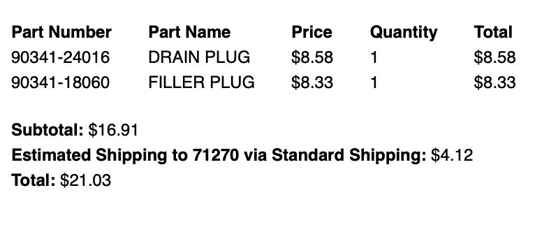

    Found the great price today on p/n 90341-18060 (fill plug)
    $8.18 plus $4.12 shipping to 50323
    Have not called the local dealer yet to compare prices; time is money so I just click Purchase with SSL PARTS
    https://www.ssl-parts.com
    genuine Lexus parts; bought my new drain plug from them

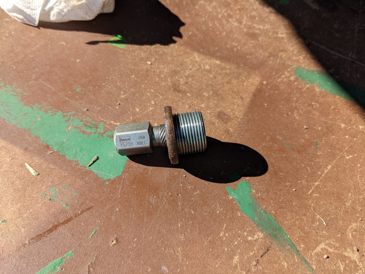

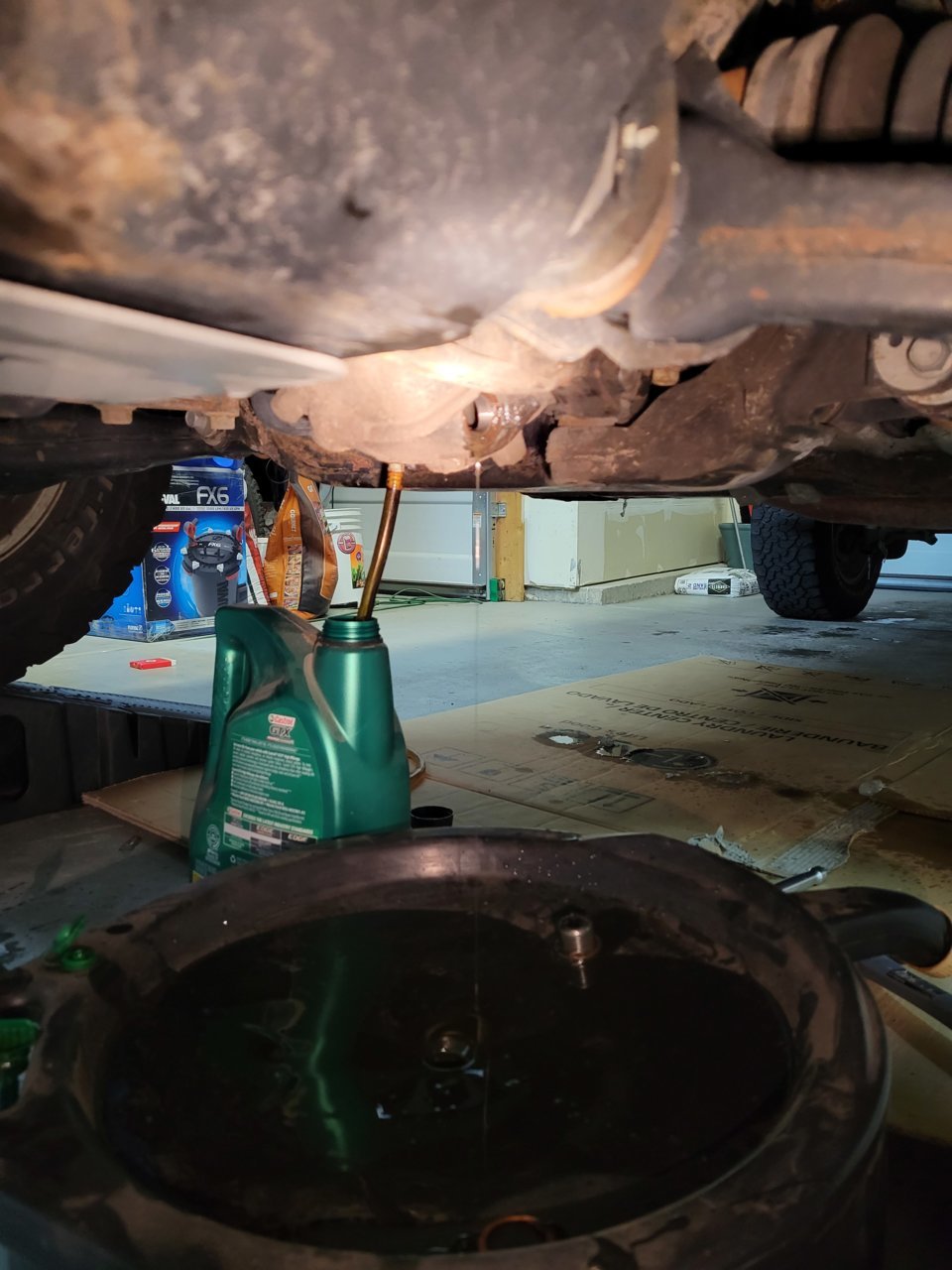

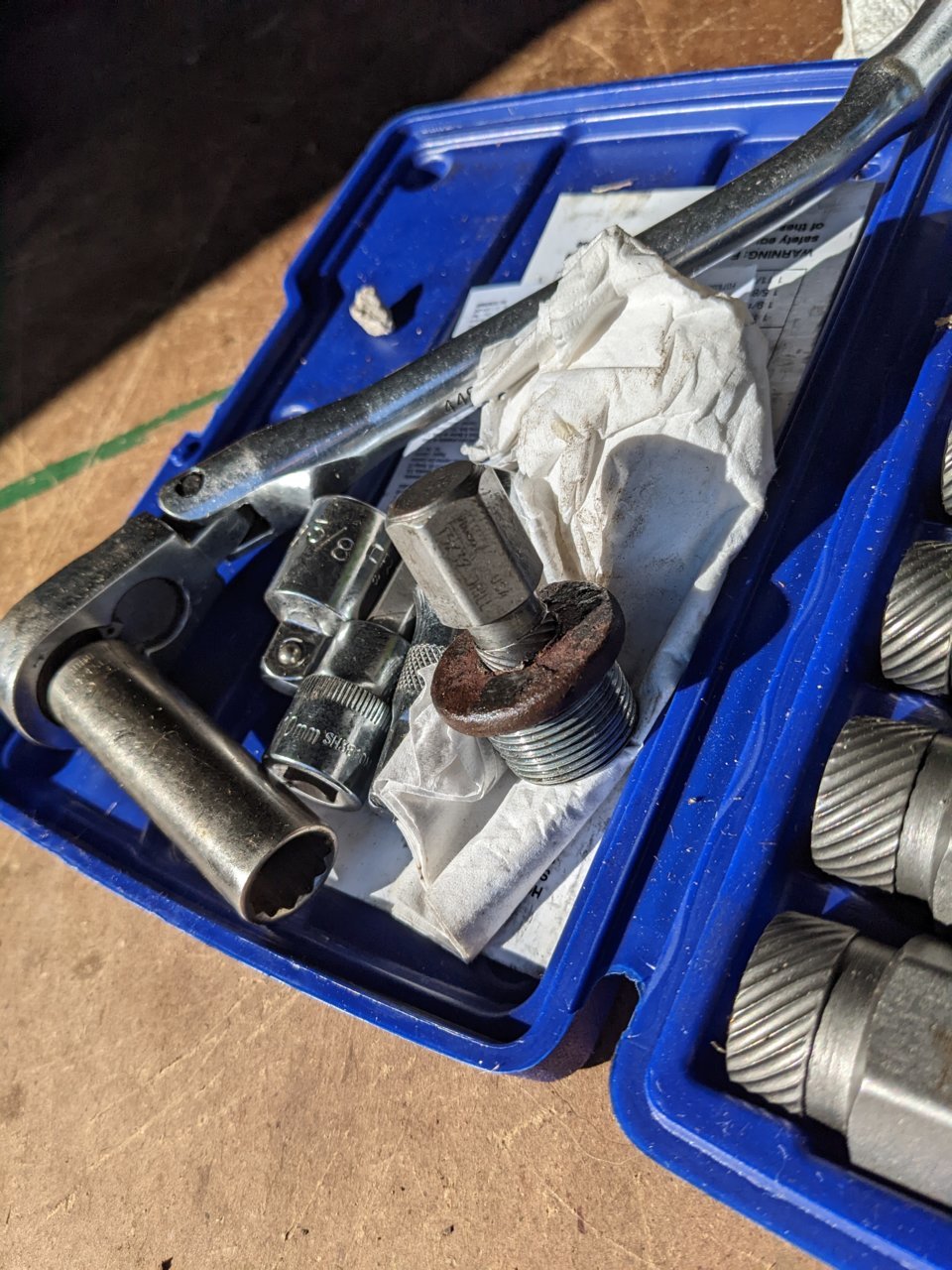

    That front diff drain plug is a B!tch!...went through two sizes of extractors before I got to solid enough steel that one would grab well enough...third times a charm...I was pulling like a monkey, got the 3.5 ton jack bending my breaker bar and just peeling metal...finally got one to bite and with the kick of my boot ...I heard/felt that sweet release. Now if I can just get the extractor extracted from the bolt...lol.
    Replaced both the fill and drain with external hex bolts. Honestly, I am going 50k on that front diff from now on....it still comes out hella clean at 30k.

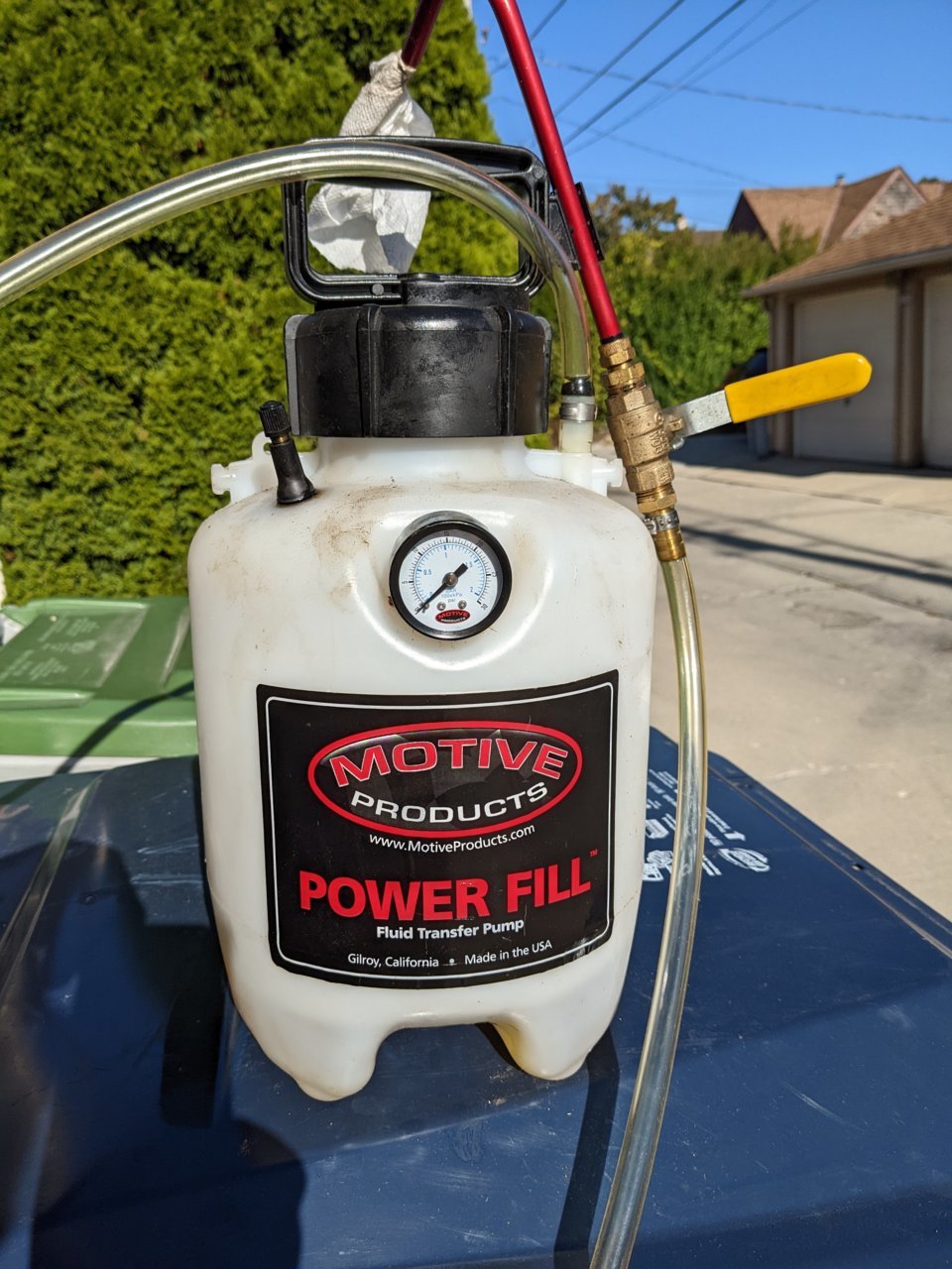

    Gotta say...I really enjoy this fluid transfer pump for filling the diffs...I pressurize it with some air from the compressor and it makes life super easy...beats the snot out of the bottle pumps for thick fluids.

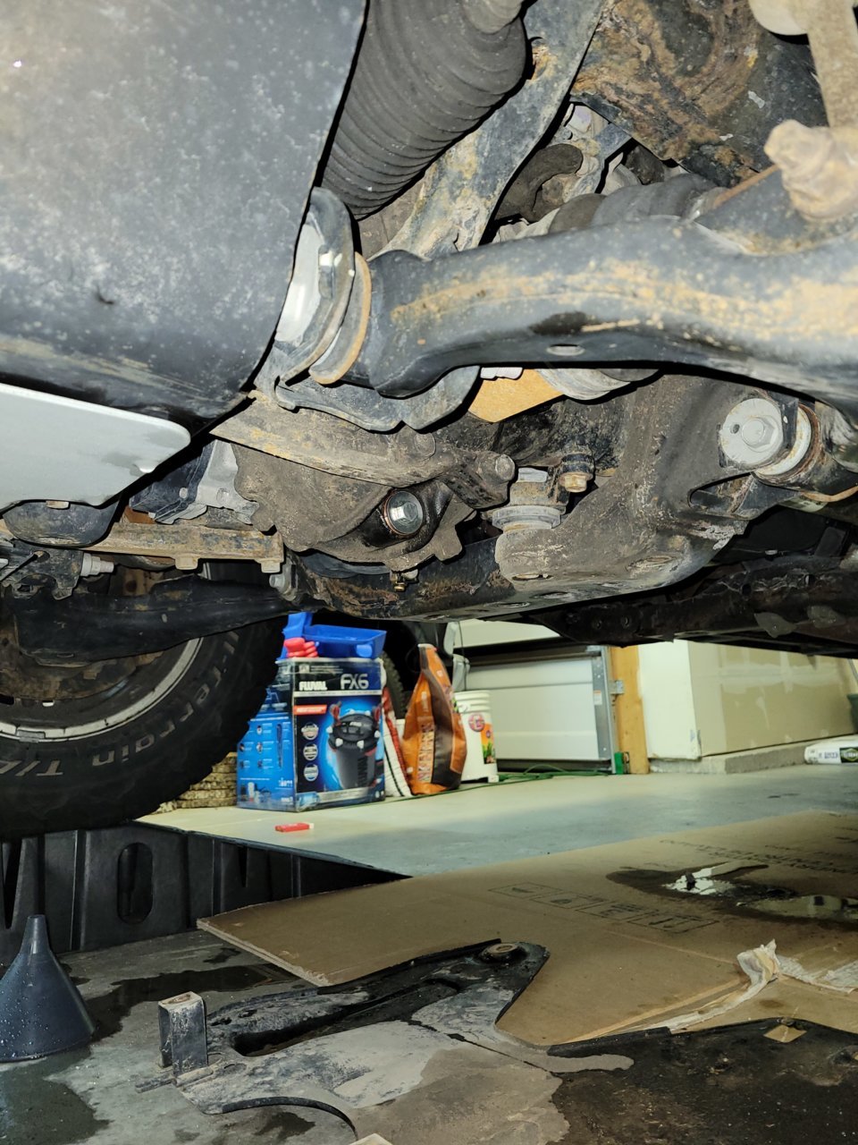

    Finally got my seized plug out this weekend and installed the new one. Diff hadn't been serviced in 100k plus miles due to the seized plug. 20230324_163251.jpg
