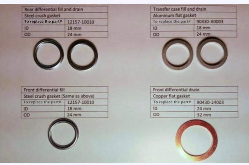

    Bringing this back up, I ordered the Lexus drain and fill plugs. Do they require a washer? If so, does anyone have the part numbers?
  4. Feb 14, 2025 at 9:58 AM
    #144
    bbinSF
    bbinSF Well-Known Member
    Mar 26, 2024
    #446665
    111
    I used the same type recommended washer from the original plugs, shouldn't be different.

    I do the same as well.

    is there a good alternate plug for the transmission check plug? that 5mm hex is horrible. I know it uses the same crush washer as the drain plug that just needs a 14mm wrench but I forgot to confirm if the threads are the same size when i had them both out
