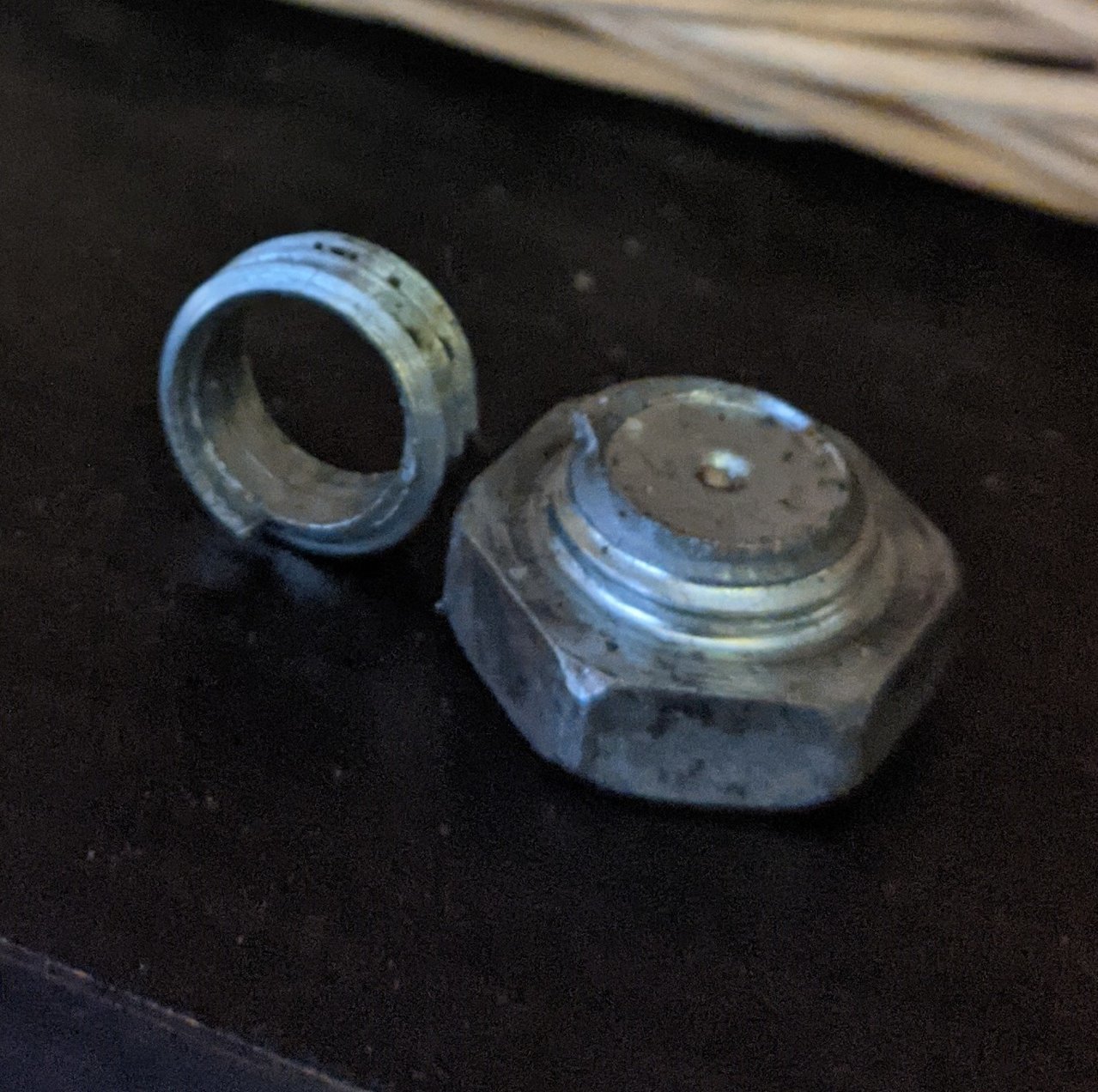

    So some point along the way my front diff plug got replaced with a regular bolt (not 12mm Hex). It looks like it used to have a magnet in it as there is a spot for one to go. No longer is there a magnet in the old bolt and when I went to replace the bolt it sheared on the first turn after hand tight. Luckily I was able to get everything out pretty easily.
    The bolt that I replaced it with was just a regular M14x1.50 and I'm looking to go pick up a new OEM bolt from the dealer today. I spoke with my uncle who is a fuel system engineer and he said not to be too worried about the magnet in the diff and to just make sure I get another magnetic bolt to clean anything out.

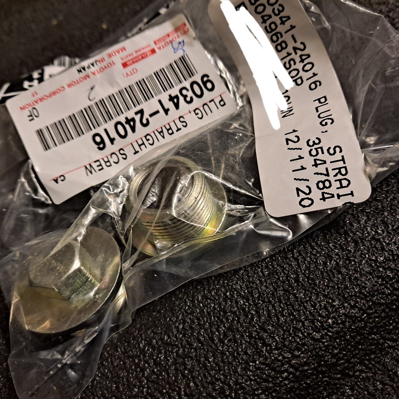

    Replace with the Lexus drain plug, I’ll see if I can get you the part number as I just posted it in another post

    Get a Lexus plug for the front diff so you don't have to use allen keys. 90341-24016 on Lexuspartsnow.com
    Also you should replace the crush washers each time. I had a plug I almost strip, there was no crush washer on it. Every drain/fill plug on our trucks (except oil) has a crush washer, and it’s considered one time use. In reality you can get a couple uses out of one, but eventually you have to tighten the plug so much that what you are experiencing happens.

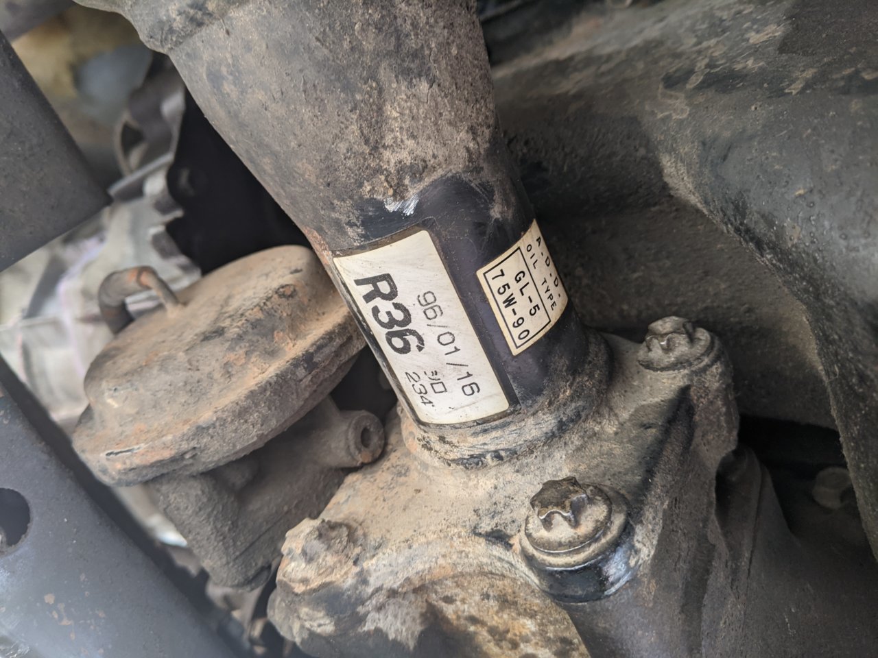

    @MikeWH yikes! I went in the dealership and the OEM plug with magnet is a M18x1.5 plug. Mine is a M14 plug, does anyone here have an idea of whats going on with my differential?
    The fill plug is stock and the sticker on the shaft to the passenger looks legit? So the passenger side of the housing is the only thing that looks different.

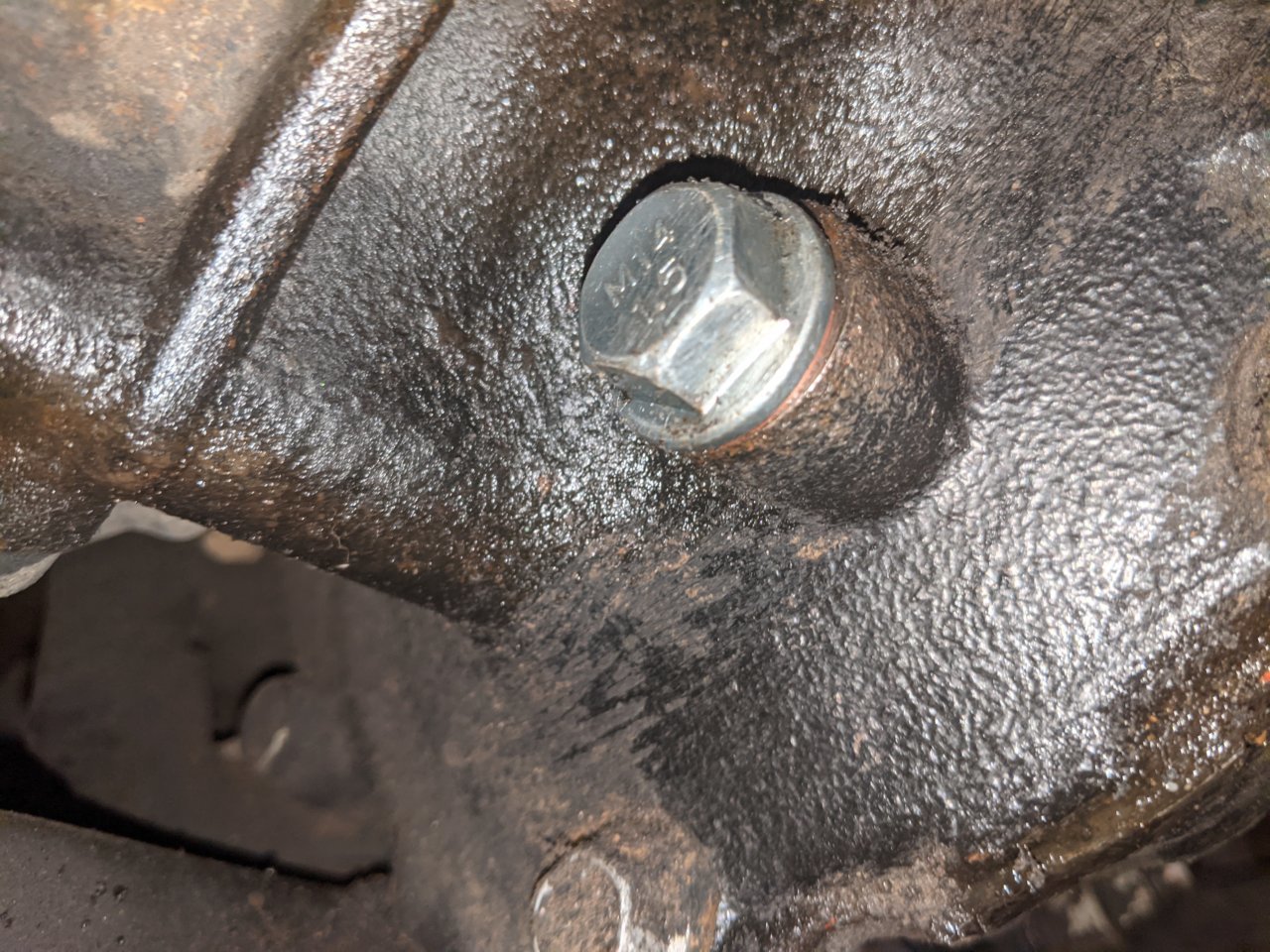

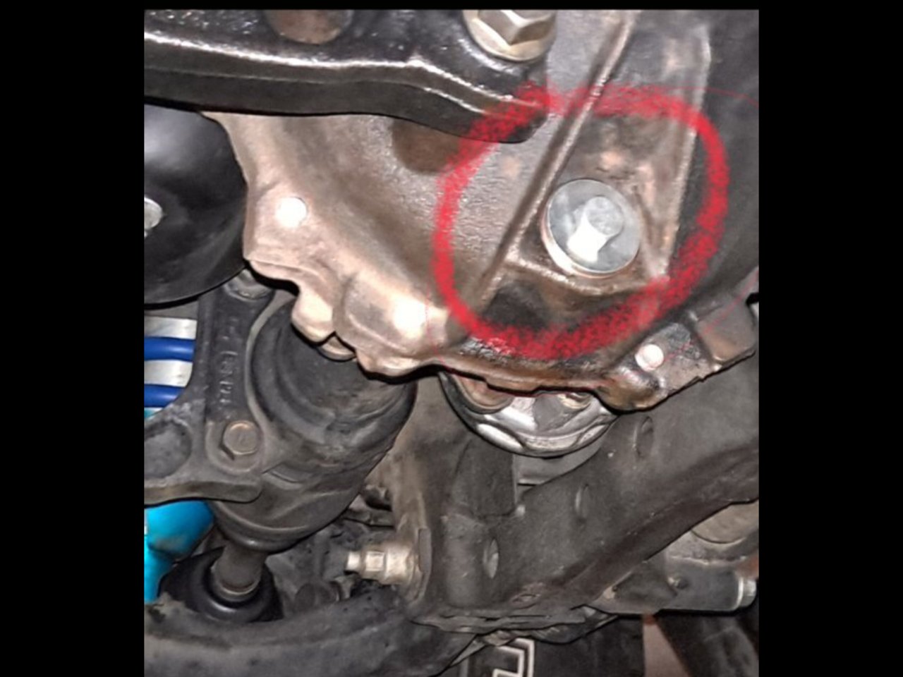

    Wow! Yeah that looks like the correct axle, down to the date sticker and oil sticker, looks the same as mine. Can you post a pic of the drain plug area?
    Did they strip it and put a helicoil type sleeve or something in? If you wire brush near the drain plug can you see an insert in place?

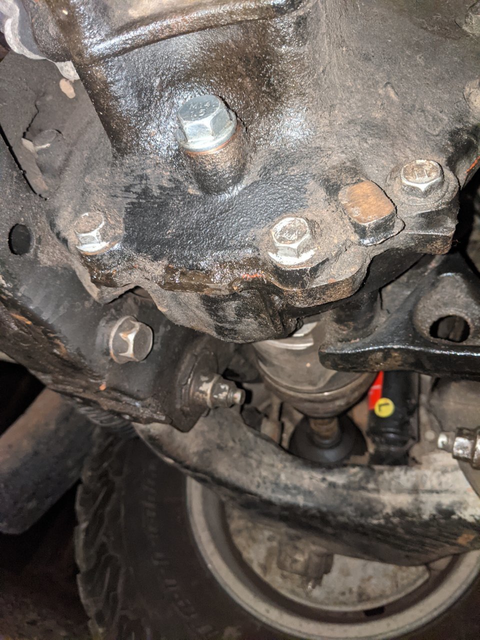

    @MikeWH
    Here you go I don't think it's an insert... While the bolts line up the housing around them doesn't seem perfect. I'll grab some better pictures of the full thing in the morning. PXL_20201223_022436062.jpg PXL_20201223_022424564.jpg

    If the threads check out, I like the idea of the Lexus bolt. That said, When I do my diff fluids I be sure to be very careful not to over tighten that bolt.

    Just get a Lexus drain plug with the magnet

    @1997tacomav6 I definitely would but unfortunately the drain plug on my differential is somehow an M14x1.50 it's also a pretty shallow bolt so the magnet ones from the shops scare me.
    I'll be posting pictures of the cleaned up passenger side of the differential, in the morning maybe you can give me some insight to where it might have come from because it certainly didn't come from a 1996 Toyota Tacoma.
