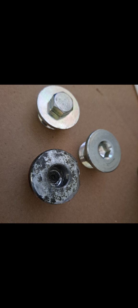

    Is it the top or bottom plug?
    I think toyota used the same bottom drain plug over a number of gens with the magnet with the Allen key style

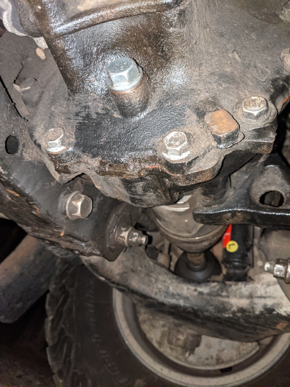

    It's the bottom plug, here's the picture I just took of the unit it's definitely not stock. I think the stock bolt is M18x1.50

    Original plug was probably with a magnet and an Allen key style

    @1997tacomav6 Yeah it definitely was I had one in my hands earlier at the dealership, it was a very low point of today. much much bigger than the one that actually fits in the drain

    Never forget...lefty loosey, righty tighty..just kidding. The way that metric one looks now, I'd leave it alone. As far as being lined up, it's just a casting. Normal. It tightened up and seals, I'd be happy.

    I can attest the Lexus Plug for replacing the factory drain plug HEX head works like a charm. BTW the 24MM rear diff fill plug is an easy replacement for the front diff fill plug. Your future self with thank you. Just remember don't over tighten!!

    I have the Lexus Plug with the magnet now, so will not have to visit this issue again
