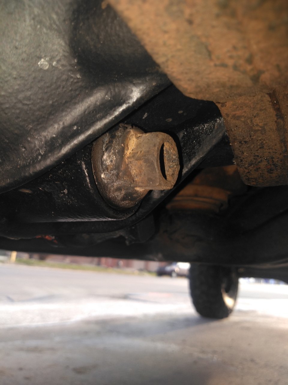

    2006 rad red offroad
    First, yes the drain bolt is a pain in the ass. Best to use a torch before you even try to loosen it.
    Second, the cheap harbor freight welders suck. Their AC current and flux core. I had one and upgraded to a century fc 90. It's 200$ and it's DC and an inverter so it's alot smaller. I've welded my sliders, bumper, and cab mount relocates with it and haven't had any failures.
    Third, use a nut. It will give you more surface are to weld to. This is what I did.

    2018 4runner limited in nautical blue
    hit it with kroil or pb blaster for a few days i n a row. notch it with a dremel as mentioned, heat it up good and hot, spray air in a can upside to the center for a few seconds to chill the bitch and give it a few whacks. should come right out for ya

    Larzzzz
    Larzzzz Grande' Ricardo
    Aug 23, 2009
    #21609
    2,842
    Larry
    MA
    '06 dclb 350+ kmiles
    Aux back up lights, Bed lights, Re-located trailer plug, Good dooby, a.k.a. jumper cable mod, Heated seats, back up camera,
    I'm sorry you must phrase your answer as a question.
    Edit. Get in there and scrape the crap out of the hex hole before inserting the Allen wrench, socket, etc. I've yet to strip mine after several fluid changes doing this.

    Blockhead
    Blockhead Well-Known Member
    Jun 6, 2015
    #156849
    1,959
    Pittsburgh, Pa.
    2024 Silver SR5 DCLB
    Worst design ever...I tried all the tricks when mine stripped, nothing worked. Took it to a local shop, he welded a nut onto the stripped plug for $20, good to go.

    Tom
    2007 Tacoma 4.0
    2.5 inch lift, 285/75r16s, upgraded stereo system, Magnuson mp90 supercharger system.
    I agree with blockhead get it cleaned up and have a shop weld on a nut for ya and that should be a permanent fix.

    EatSleepTacos
    Mar 24, 2015
    #151688
    59,834
    Randy
    West Valley, AZ
    2017 4Runner
    Get a sacrificial torx bit a bit too big for the hole and hammer it in there. Or a chisel.

    EatSleepTacos
    Mar 24, 2015
    #151688
    59,834
    Randy
    West Valley, AZ
    2017 4Runner
    Another question. How were you grounding your welder when you tried to weld that nut on?

    skedrc
    skedrc Well-Known Member
    Aug 28, 2017
    #228337
    306
    Preston
    Elko
    2005 MT 4wd
    Had the same thing happen on my 1st gen Taco. As said above ^, I cut a very small line into the face and edge of the bolt. Grab a chisel and a large hammer, smack it till it comes loose.
