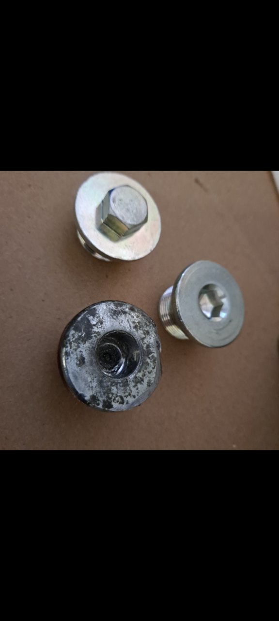

    I'll give a little more details on what I've done so far:
    * PB blasted daily for a week
    * Stripped out the hex socket
    * Hammered in a star tip, broke it with an impact wrench
    * Chiseled out a groove for a flathead, stripped that
    * Applied constant heat with a torch for 10 minutes, chiseled at the sides from an angle for another 10 minutes. Lots of dents, but no movement.
    At this point i'm gonna find a shop to weld it. Hopefully one of them will be willing to do so. Most in my area don't seem to like doing custom stuff for liability purposes, which makes sense I guess but is lame. For those of you suggesting the Lexus plugs, that's certainly an option. I already splurged and have this one ready to go: https://www.kaon.com.au/front-diff-drain-plug-to-suit-toyota
    With the matching fill plug already installed: https://www.kaon.com.au/front-diff-fill-plug-to-suit-toyota
