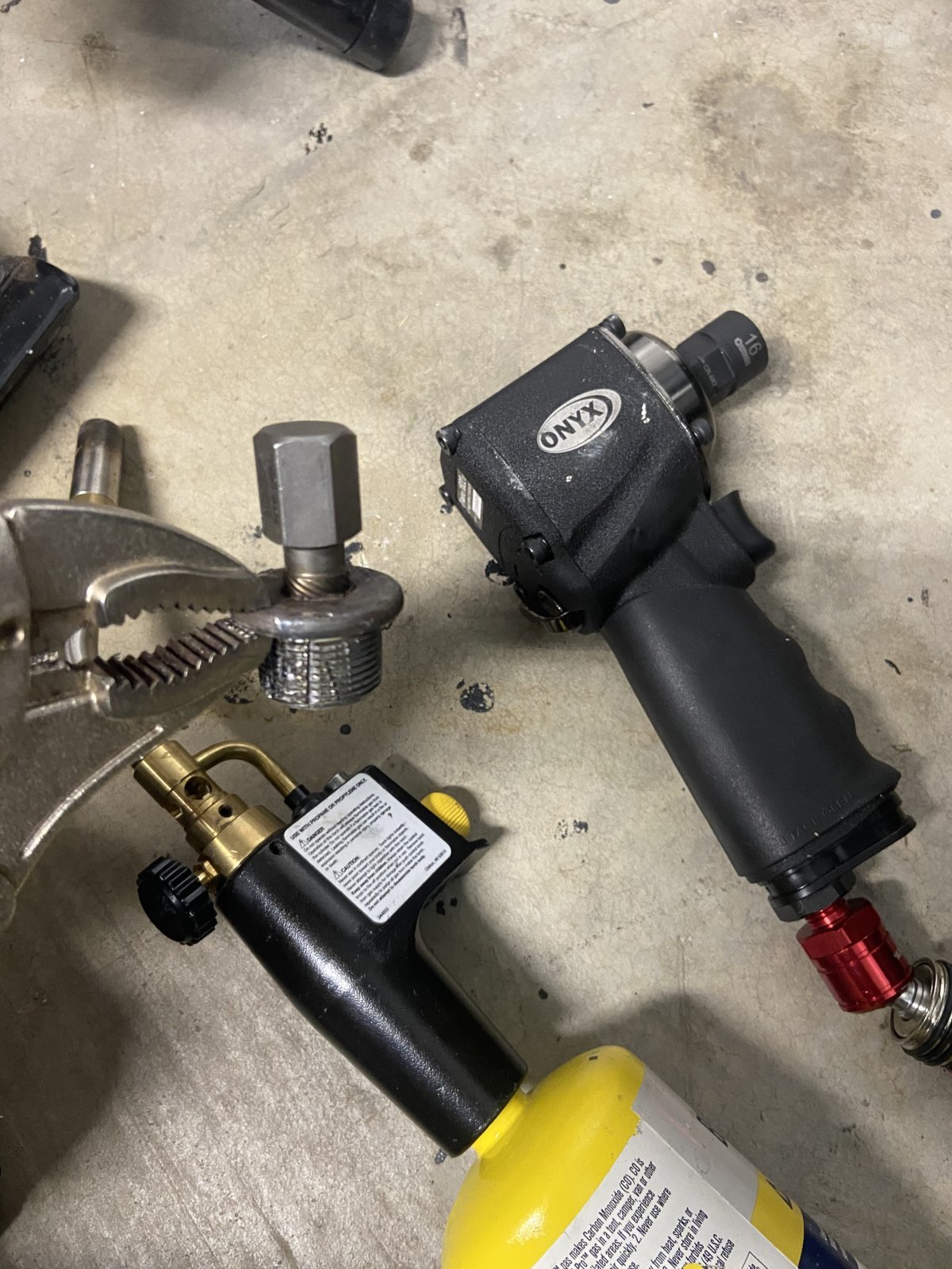

    Your post made me think it's about to do mine . Of course mine was seized /rounded as well.
    I went and gave these a whirl I couldn't believe how well they worked, I cleaned out the gunk the hex hole, didn't bother drilling it round, just smashed one in with a hammer. Heated a tiny area, it took me bumping my impact up some psi to get it out.
    pretty impressive tool, I give it a 10
    don't mind the gnarled threads, I was trying to get the extractor out! Grab on with a pair of vice grips or bench vise and turn the extractor clock wise
