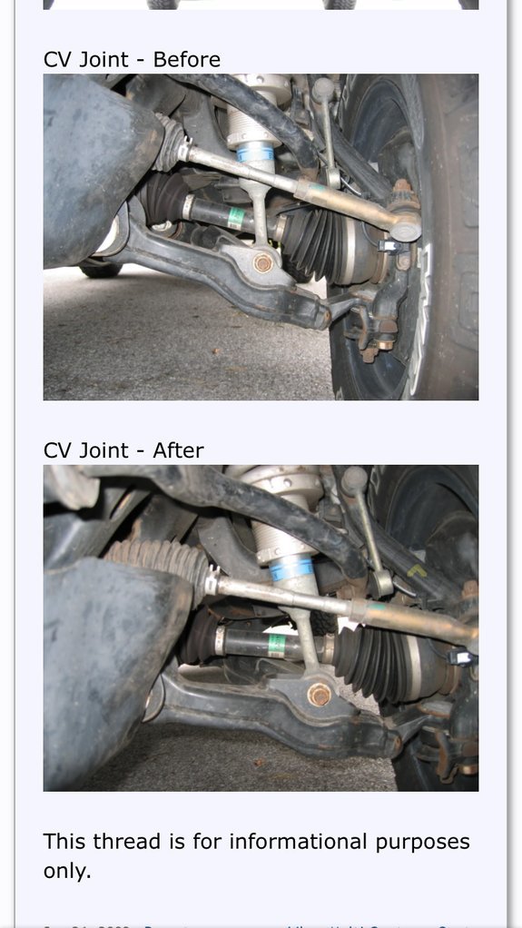

  15. Jun 26, 2017 at 7:13 PM
    #35
    lynlan1819
    lynlan1819 Well-Known Member
    Mar 14, 2016
    #181268
    6,539
    Tacoma
    Lifted
    My answer got mixed in with yours somehow.

  17. Jun 26, 2017 at 7:15 PM
    #37
    lynlan1819
    Mar 14, 2016
    #181268
    6,539
    Tacoma
    Lifted
    Remember the drop kit does not do anything too the LCA,so the bottom picture has a depressed suspension,that's why the axle angle is less,its not because of the drop kit.
