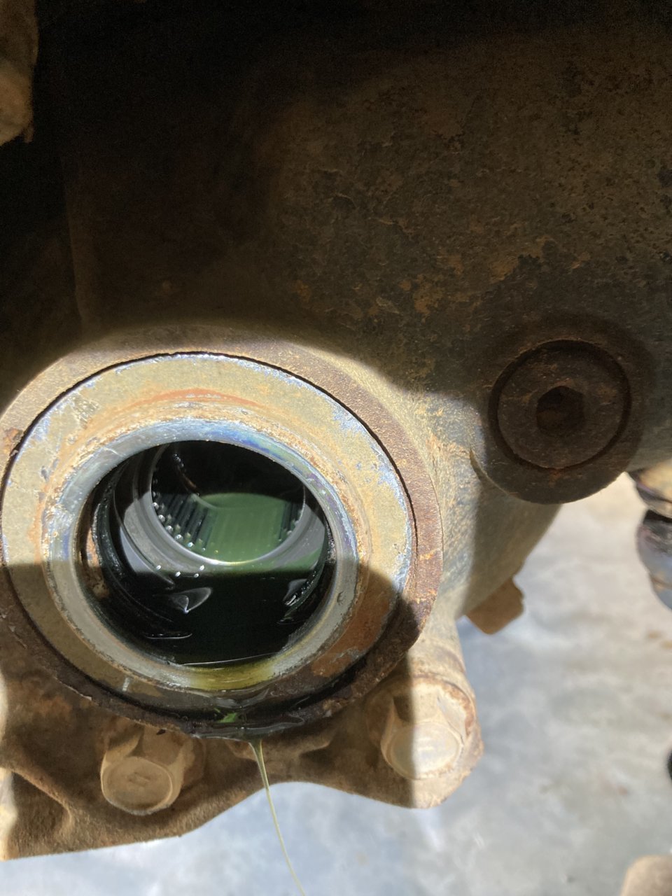

    went to change needle bearing after lift installation and seen this fluid was green, I change the differential fluids at 30k miles, is this normal? I went ahead and changed the fluid at 10k since I was changing the needle bearing so it’s not even half way through the interval

    I think it looks normal and in good condition. It will turn grey as it breaks down.

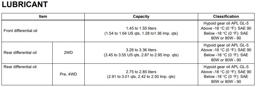

    By the book the front diff is 1.6 qts. As others said if youre parked on level ground, fill till it starts to run out the fill plug.

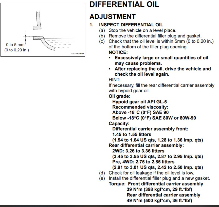

    I just poured it in until it started to trickle out of the over flow.
    Then checked it a few days later, added a bit more.
    By the time I spilled the fluid all over the place and got it filled. I had about 1/4 qt. left over.
    My guess is I got 1.5 qts in there?
    And for the record, technically the fluid should not pour/trickle out the fill plug.
    There’s a spec for it, but I didn’t abide by it. IIRC, it supposed to “just” below the fill plug.
    I don’t remember the measurement.

    y=mx+b
    y=mx+b Station Wagon
    Jul 17, 2020
    #334787
    1,938
    Lafayette, IN
    '05 T4R SR5 v6 4wd
    Its like a yellowy light brown, so that may just be the way the light hits it.
    If it gets water in it, it will be more like a light chocolate milk when mixed. Will get black as it breaks down and shiny if somethings is mega wrong. As long as its not these colors, I'd say you're good

    I think it's just the sun hitting it. In the shade it would probably look more golden brown

    Ok thanks, yeah I did have a led light beaming on it

    I always get a smile on some of these fill levels.... How do you measure 0.20" BELOW the fill hole????
    As an engineer, I have written procedures like this.....usually under protest about details like how to measure below a blind hole. During proof read, I'd edit out such statements, then the boss would counter the edit.
