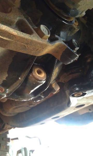

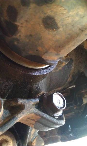

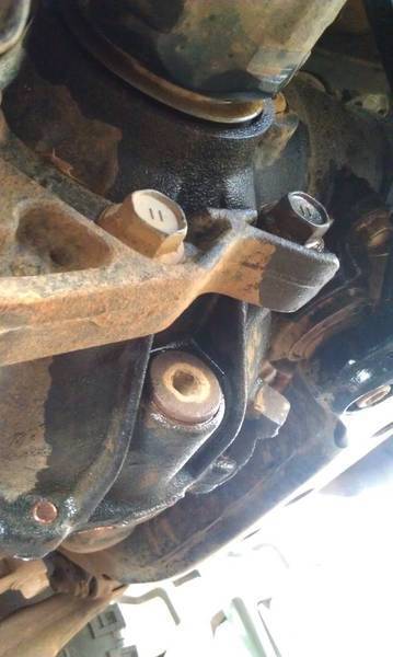

    went mud riding/trail riding saturday with some fellow tw members. had some belt whining issues i will leave them be because i found this..front diff fluid leaking.. 2 puddle like spots on my driveway. one from last night and one from the night before im guessing. drive side axle seal or something? didnt see any cracks on the front diff. it looks like its coming from where the axle goes into the diff. what do you guys think it is? hopefully an easy change

    yep diff seal leak. dont let diff run out of the fluid. luckily its easy change
