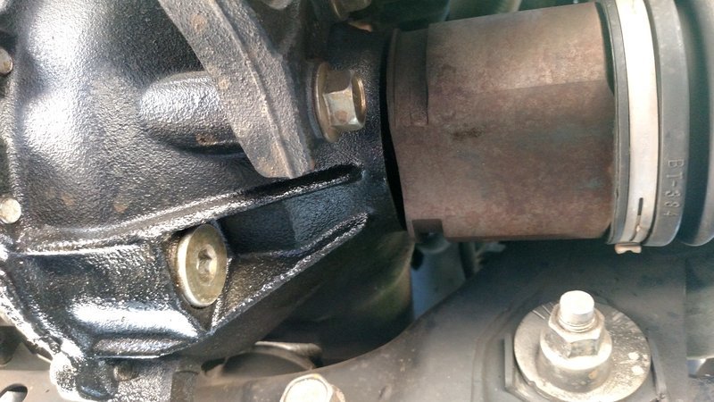

    I was changing my oil and noticed a leak on the drivers side CV shaft. What do I need to do to fix it? I am pretty sure I need to do the needle bearing also. IMG_20160814_113432050.jpg

    Hold onto the end of cv going into diff and push up and down. If theres much play id replace bearing if not just pop a new seal in.

    There are some threads out there on this. This job isn't too bad, I just had to do it. You will have to separate your lower ball joint, I used the four bolts right on the bottom. Once you have the steering knuckle free, you can rotate it out of the way and remove the CV shaft. I bought an OEM output shaft seal, and I have not had any issues in 10k miles. The dust cover inside the hub is a little tough to remove without destroying it so I ended up buying a new one. You will need a 35mm socket for the castle nut on the end of the CV shaft. It is pretty straight forward.

    Yes, you need a new seal and make sure it's an OEM seal, or you'll be replacing it again relatively shortly. It's a pretty straight forward job.

    I guess I will just go ahead and order the needle bearing. There is a little bit of play up and down.....

    Ecgs has oem seal available. Replace that needle bearing with the ecgs removal tool and bushing

    Youl need to remove cos to give yourself some room.
    1 or better yet 2 pry bars usually does the trick.
    And i believe the axle nut is 36mm not the 35mm posted above. Thats size listed in write ups and size i used.

    Well I caught hell with everything. Had to modify the tool for the needle bearing. Caught hell pressing the new one in even with a race kit. When I put the CV axle back in it was a very tight fit....not sure if that is normal. The seal came out easy and back in easy. No leaks as of yet.....think I broke my fingertip however.....

    Oh yea the tool has to be ground a little to fit in easily...
    You lube up the cv before putting back in? Should be a nice fit with no slop yeah.

    I ground the shit out of it.......it was a bitch. Yeah lubed it up....just harder than I figured sliding the CV in....no slop whatsoever. Drove fine. Still have humming but now I know it's from my tires ....
