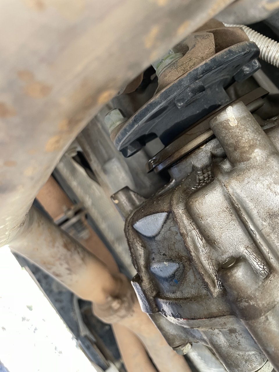

    2AE77720-7C03-4B1B-A074-05247E616412.jpg Im sure this will help someone in the future. Part numbers to replace the FRONT output shaft seal, companion flange seal, and staked nut. Im thinking the output shaft seal must have bent and started leaking
    50Buck and Chew like this.

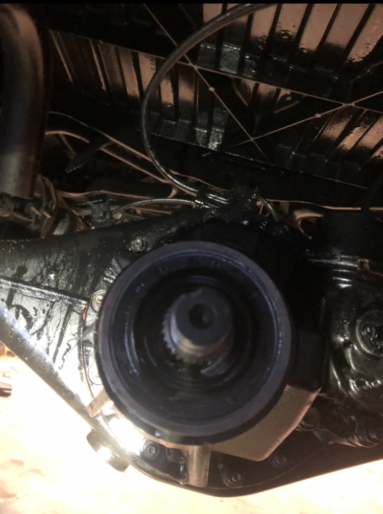

    B6EDBBE4-52AC-4964-8EDF-0F19F76B17C2.jpg That happened on my break in on my first ECGS diff. Drove it about 15 minutes and came home to cool it off. Walked behind the truck and saw oil all over the ground. For whatever reason the pinon seal was torn. I had a solid spacer so I replaced the seal. This diff made it 3 more months. Second one last 4 months. I got 3 months out of the 3rd one before it broke and I decided fuck it and put my sport axle back under the truck.
    SLeeper512 likes this.

    Ouch I wonder why yours failed so many times. Hoping its not too hard to unbolt my front driveshaft to fix the seal since I cant spin the driveshaft. On a side note thanks for helping me with my 63 swap! Think you gave me a few pointers on Instagram

    You might have to cut and sacrifice a 14mm wrench or use a wobble impact to get at it. Or torch it off.:anonymous::bananadead:
