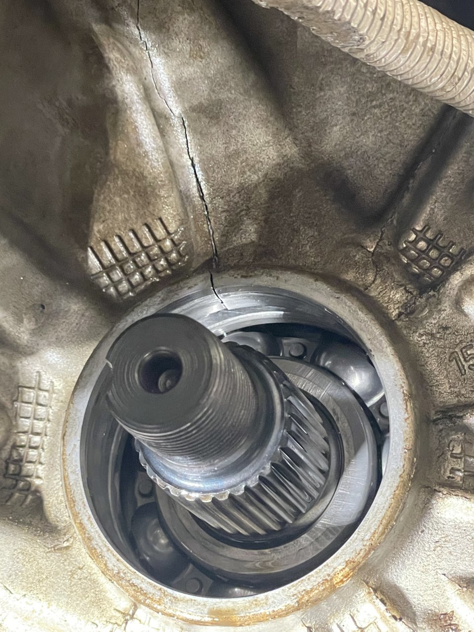

    Well guys its worse that I though. Went to go replace the seal and theres a huge crack in the transfer case.EACDC376-8B7B-4ADC-9EBC-DED79B4E4ED5.jpg

    Output shaft has quite a bit of play up and down as well. Thats probably not normal

    How do you crack a transfer case? Going 30 mph in 4wd usually won't do that.
    Sorry for your problems but just looking for the full story. The full story usually will teach newbies not to do that.

    I wish there was more to it but thats the full story. Ring and pinion failed and the driveshaft locked up. Stressed the transfer case and cracked it.

    I believe you for final failure. Had you done anything beforehand that could have, over time, weakened it? Just curious.

    Wow. I guess when the front diff bricked, all that energy has to go somewhere, and it looks like it went into your transfer case housing!
    Sorry for your grief. Hopefully most of your costs get covered and you come out with newfound skills and knowledge.
