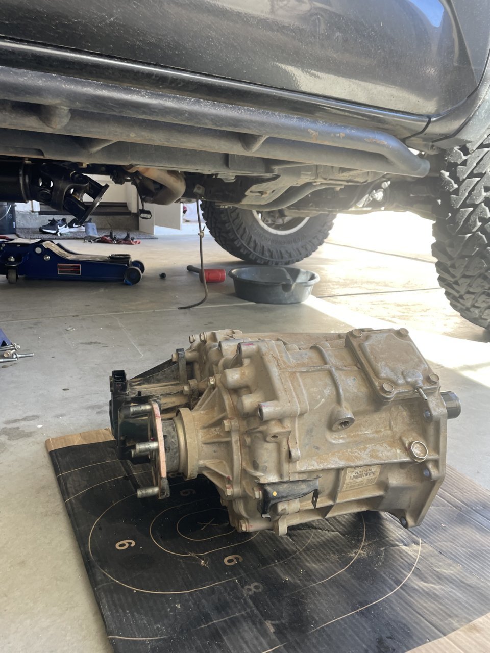

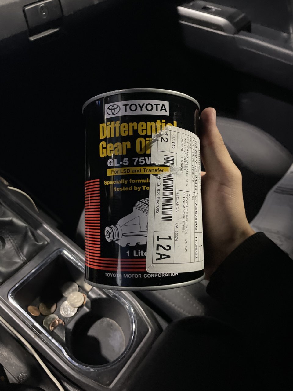

    Went to my toyota dealer for transfer case oil and they gave me this. Doesnt look correct but it does say “transfer” on it. Thoughts? Going to leave it in the transfer case until sunday and put some redline mtlv in it. Also got the old case pulled out. Was pretty easy. C651C62C-B935-453A-A861-B45055524638.jpg

    Welp thats the end of the thread for now. New case is in and the truck is ready to go.E6E3B942-BDF1-4AD9-88C2-5CF6E263D0F4.jpg

    This is what you want if it's from Toyota -> Worried Dealer Put Wrong Fluid in Transfer case/Transmission
    I run Redline MT-LV

    Also @trail.taco that gear oil for the transfer case is what you want from toyota. Supposed to have a Formula that no one else has although others are very close to it. I run Lucas in my front/rear and the toyota oil you posted in the transfer case.
