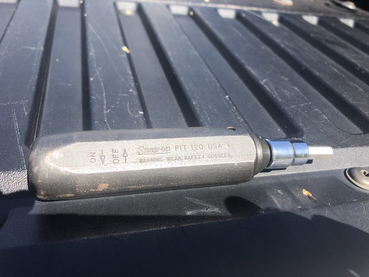

    I use an impact screw driver.
    Take a big hammer give it 3 good smacks. Then on the 4th smack, I send it home. It will either break free or strip clean out.
    I don’t waste my time. If it strips using the impact it was going to anyways. If it does, weld a nut to it and carry on. If you can’t weld, go to an exhaust shop. It won’t be any problem for them. And I bet they don’t even charge you much. :thumbsup:
    BTW, it doesn’t have to be Snap-On.
    The cheap ones work just as well.
    Success rate for me has beed over 90%
