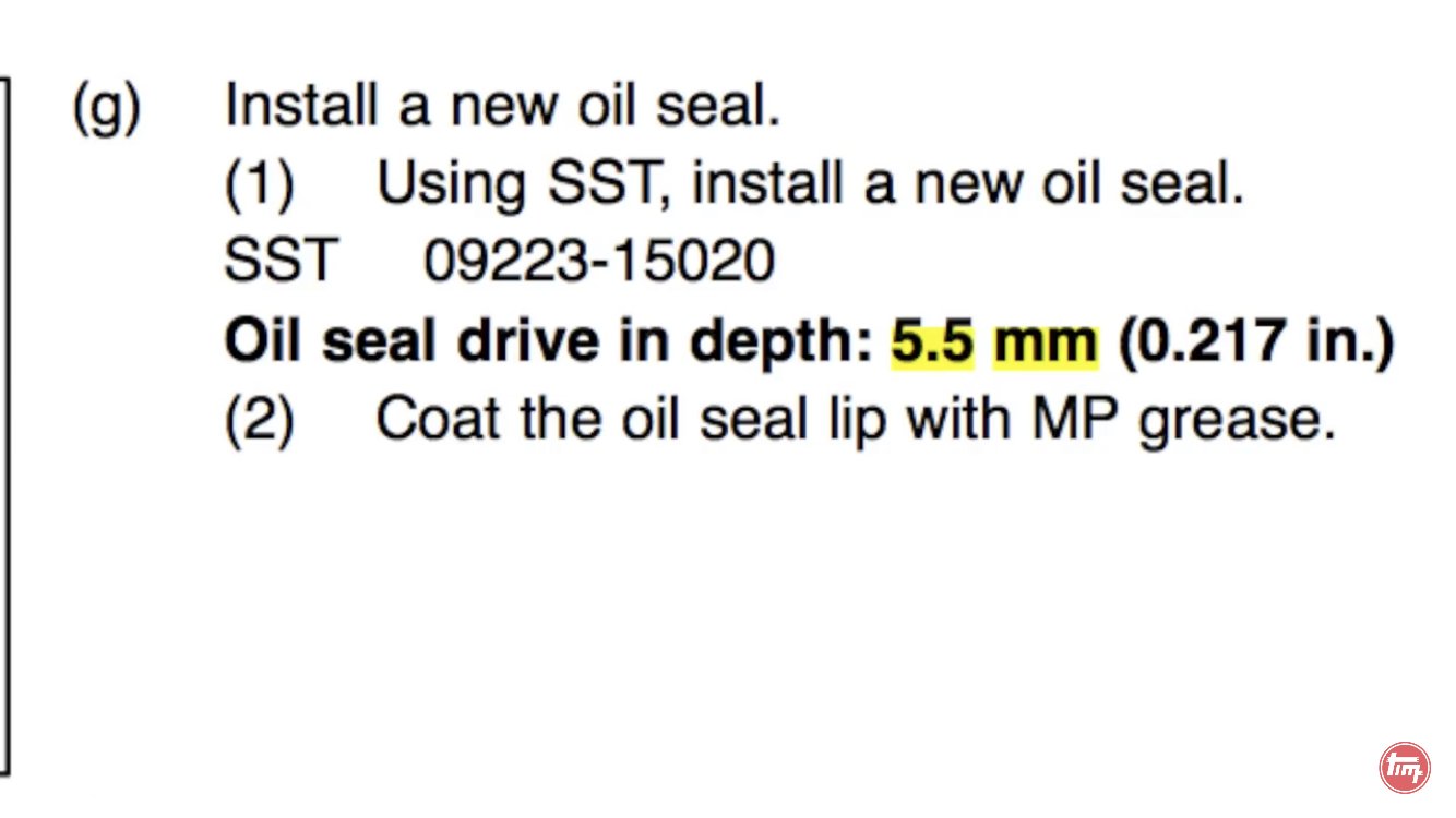

    As stated, keep seal flush on outside, not bottomed out in diff as it wont seal on cv flange. Good luck took me 2 tries.

    A correctly fitted piece of PVC pipe is money in the bank for properly seating the new seal!

    171
    yep took the seal to home depot. The 2 inch connector pipe is perfect.

    Also, be careful not to tear the seal when you reinsert the CV axle. Treat it like a lady, not a toothless old Mexican whore.

    yeah i tried it was rough but i believe it is not torn. I ended up putting the axle in then putting it back through the wheel hub lining it all up and hitting it in with the hammer.

    Hello everyone!! I had 2019 Tacoma front differential is leaking. I already order both of driver and passenger seals. I am try to find correctly special tool for seal to install. Can anyone help me to find correctly the link that I was suppose to order. And also I know I have to flush the differential oil. I already order it. All I have to order tool then I can start from there. Can anyone give me correctly info please.

    Passenger side needs to be set to a specific depth. The driver side has a lip on the inside that will stop the seal from going in too far. I think a 2" PVC tube will help. Even better if you have a seal driver
