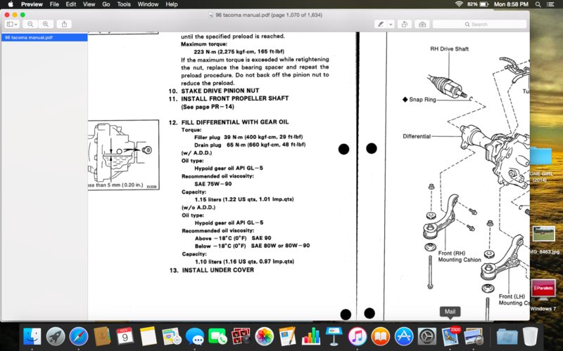

    Im trying to refill my transfer-case with the correct fluid and capacity. not sure what A.D.D. is, so I'm not sure which one to put in my truck. please look at the photo that I'm attaching to this thread.

    ADD is for trucks without locking hubs. The diff disconnects front axles internally. Add the amount of oil for what your truck has. Most ppl just fill till oil spills from the plug hole.

    Yeah ADD is just auto hubs. I think it stands for auto disconnect diff, or something to that effect. Like devinzz1 said fill her till shes coming out the fill hole.
