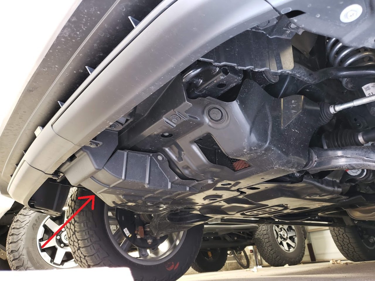

    There’s a diff temperature issue that someone at Toyota was concerned about. Some 4-runners (probably awd) have multiple and impressive ducts in the front skid plate in order to cool things. Ducts and the parts they cool reduce mpg.

  9. Nov 19, 2022 at 6:02 PM
