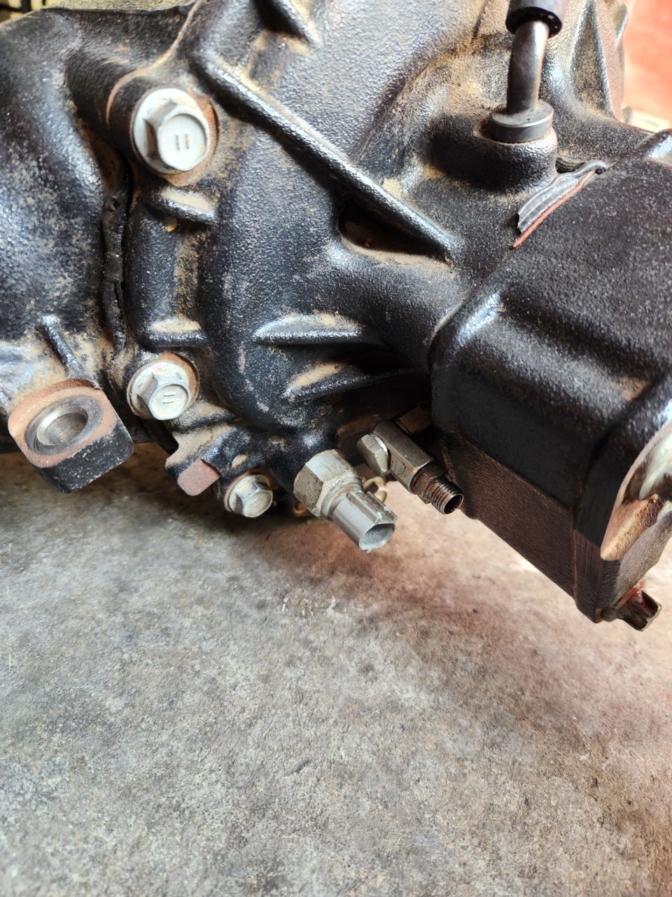

  6. Apr 3, 2023 at 2:10 PM
    #66
    k_j_souv
    k_j_souv Well-Known Member
    Dec 22, 2016
    #205514
    263
    NorCal
    3G OR DCSB, Dual Case, 42s
    Incase anyone is wondering. Mines is a 2017 DC TRD off-road and it has the sensor
    shotgunbilly420 likes this.
  7. Apr 3, 2023 at 3:18 PM
    #67
    k_j_souv
    Dec 22, 2016
    #205514
    263
    NorCal
    Did it throw any codes or dash light from being missing?
  8. Apr 3, 2023 at 4:28 PM
    #68
    shotgunbilly420
    shotgunbilly420 OG Owner 249+ mi club/Tacoma enthusiast
    Jul 10, 2018
    #258947
    3,309
    Montesano, Washington elv. 66ft
    2017 trd Tacoma offraod AT Inferno
    315/75/16, 6in modded RC lift,Anderson Engineering manifold spacer,K&N air intake, URD YPipe, stock exhaust ,16" method nv305 wheels, AFE throttle body spacer, vf Tune program, JTL 3.0 Oil catch can x2, rear cat delete
    i can second you . I also have it on my 2017 dbcb trf offroad
    k_j_souv[QUOTED] likes this.
  9. Apr 11, 2023 at 7:30 AM
    #69
    Kgrecurit88
    Kgrecurit88 Active Member
    Mar 5, 2017
    #212364
    38
    Kyle
    2017 Tacoma TRD OR DCSB SWhite
    Drop in k&n Leveking kit Rago ditch lights
    No codes at all. I didn't notice it until I was doing my oil change after warranty changes were over.
