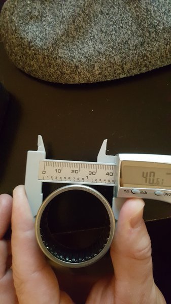

    As promised the measurement you requested 40.61mm
    I measured it several times and different ways, nothing below 40.60

    The thickness was about 2.6mm but it was tough to get a super accurate measurement on that.
